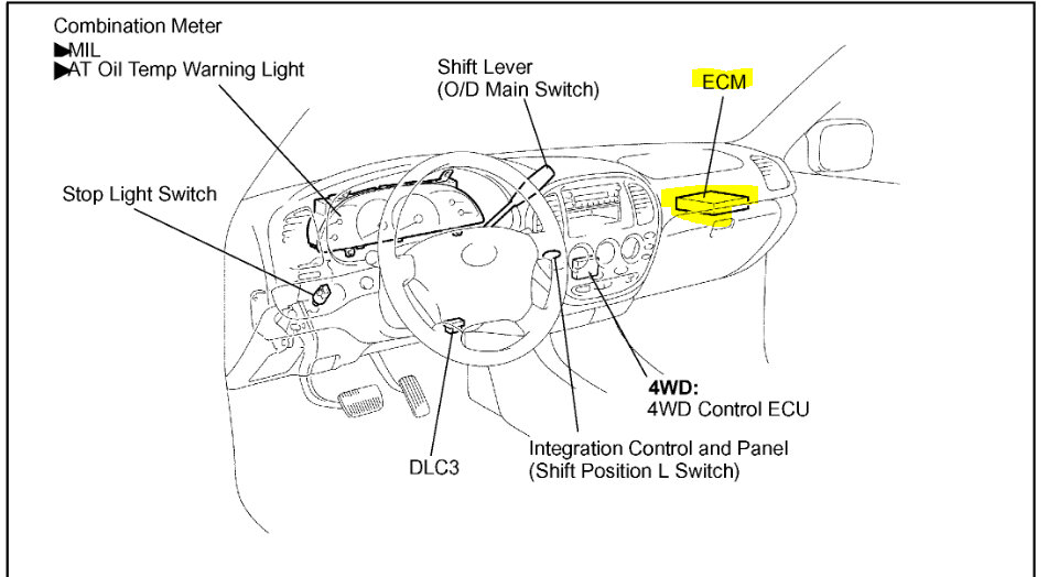

I am looking for the location of the PCM or better the ECU location.

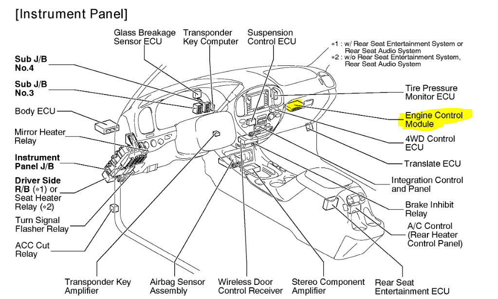

The ECM/PCM is located behind and above the glove box. I attached a couple of pictures below to help you locate it.
See pics below.
