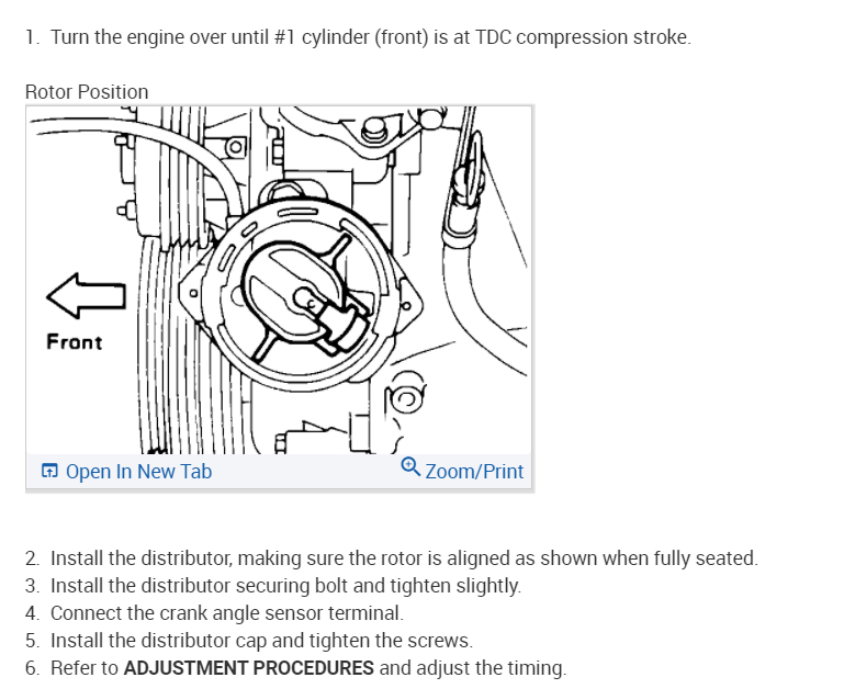

I need to know where the crankshaft sensor is located on my truck.
Mar 27, 2022 at 1:36 PM
CERTIFIED EXPERT
53,854 POSTS

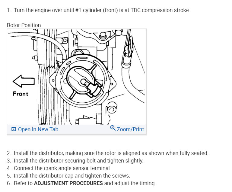

The crankshaft angle sensor is inside the ignition distributor. Here is an image of the location in the diagrams below. Check out the diagrams (below). Please let us know if you need anything else to get the problem fixed.
