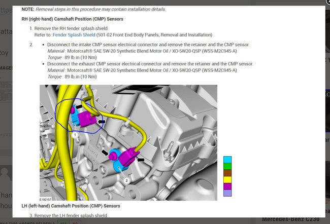

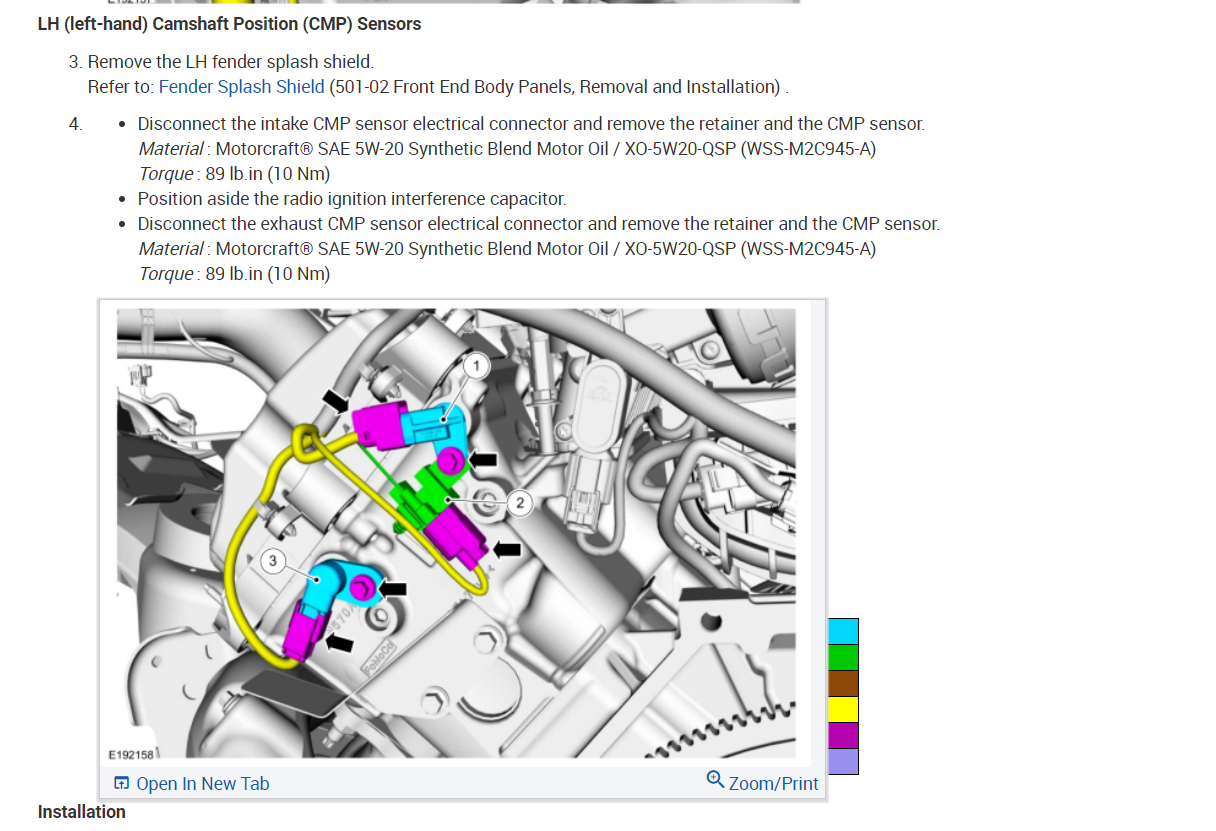

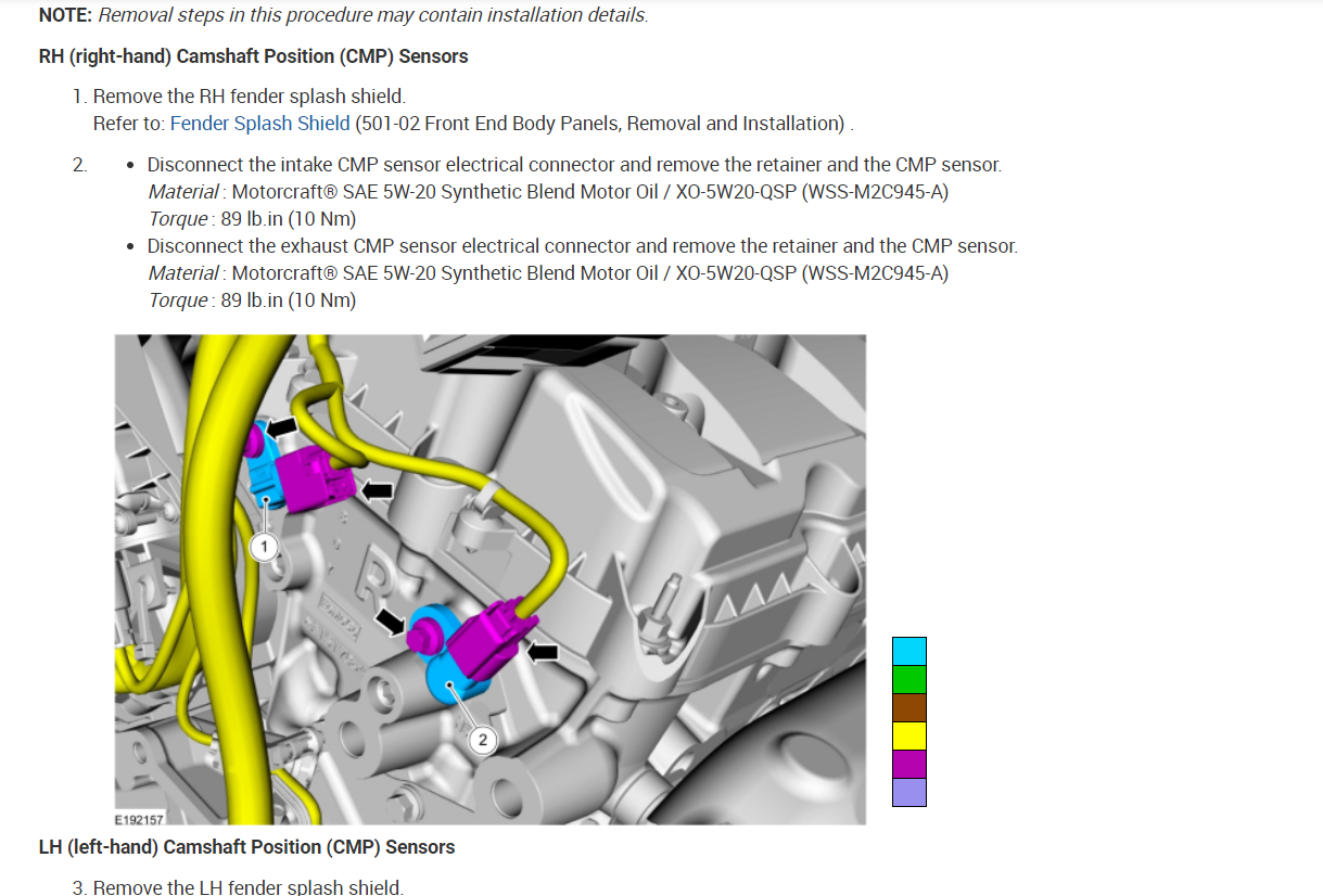

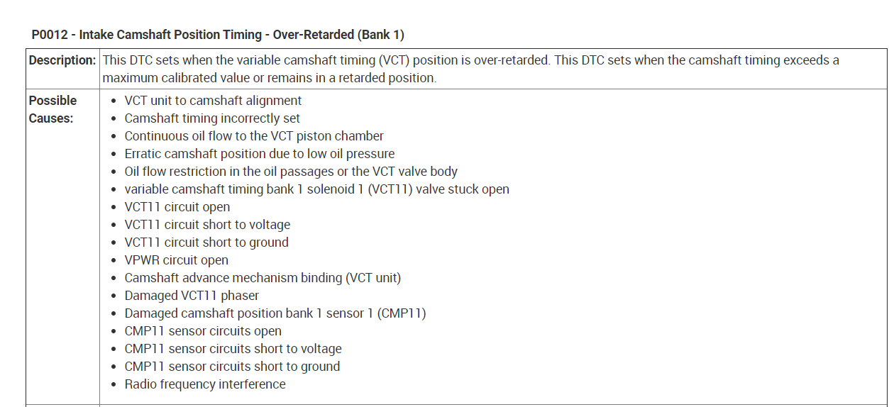

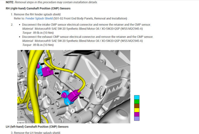

The code is for cam sensor 1 bank 1. That is on the back of the passenger side of the motor, the outer sensor.
https://www.2carpros.com/articles/camshaft-angle-sensor-replacement

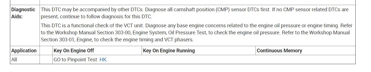

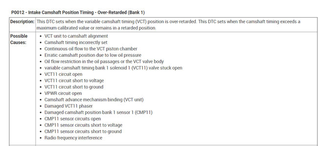

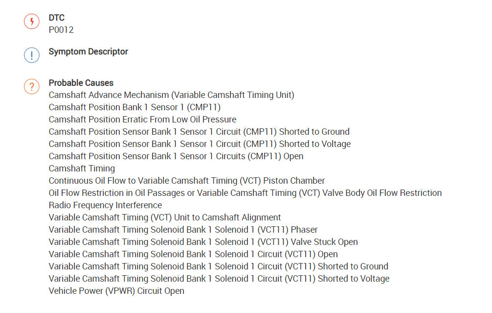

I attached the possibilities and the procedure for you below.

Thank you for your reply! Excuse my ignorance but can you circle the one I should be removing? thanks in advanced.

I attached the picture and circled the sensor. Click to enlarged the image.

Usually when we get that code, it's not the sensor as it's the camshaft phaser not staying in place commanded.
