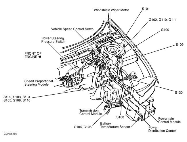

I went to autozone to scan my car and it shows code p01492 battery temp sensor to high I want to know where is that sensor.
Jun 26, 2014 at 2:40 PM

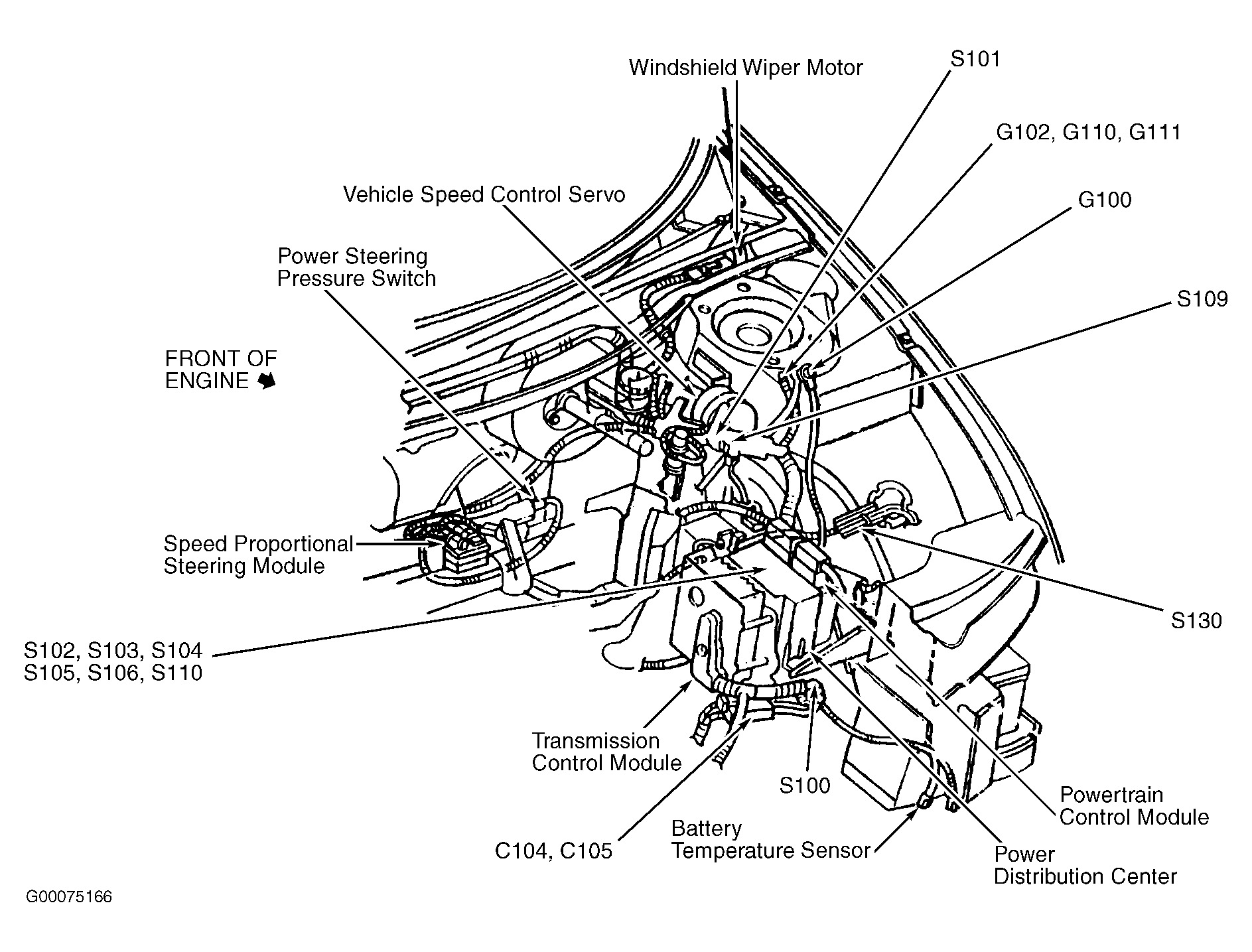

It's on the rear side of the front bumper beam (in front of the battery). See attached pic. Also, note that there are other reasons for this code to be set. The sensor could be fine.
