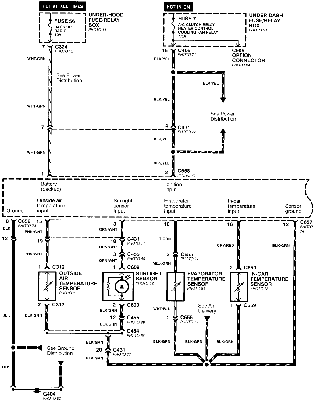

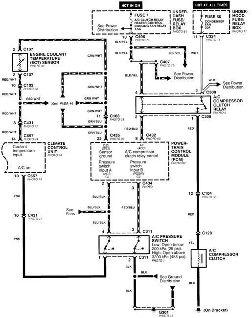

That car has a few items that will stop the AC from operating if they fail. The AC clutch relay is just one piece.
Check fuses 7 in the dash fuse/relay box and 50 in the under hood relay box. The AC relay is in the front of the engine compartment near the upper radiator hose.
