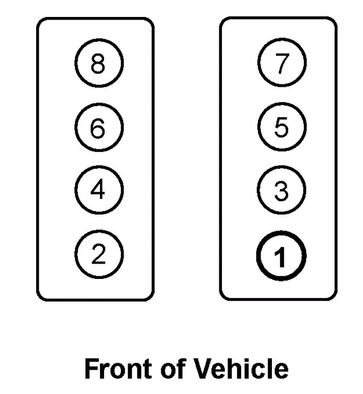

I would like to ask you guys here at 2CarPros where the #2 cylinder is located on the truck listed above nbs (gmt 900)? I cannot seem to find an exact diagram regarding cylinder placement within the motor.

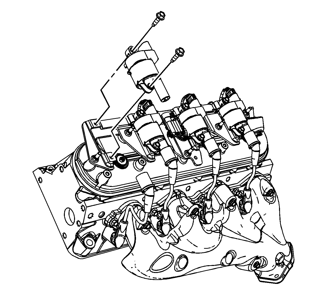

I attached a pic below of the cylinder orientation (pic 1). As far as the misfire, it could be a few things. Yes, it could be a coil or spark plug. The easiest way to determine if it is a coil is to switch the number 2 and 4 cylinders coils and see if the misfire changes cylinders. Basically, does it change from a P0302 to a P0304. If that happens, then replace the coil.

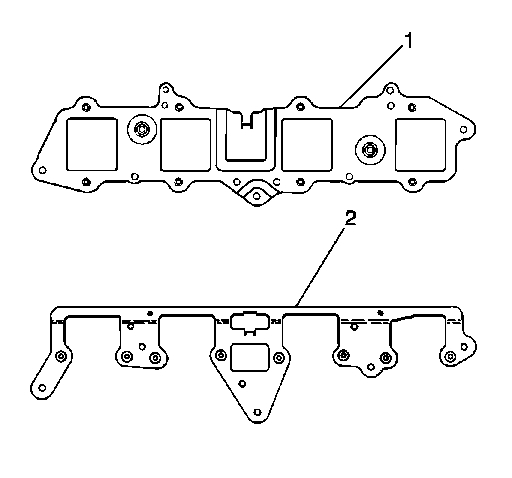

Here are directions for coil/coils replacement. The remaining pics correlate with these directions. You will not be replacing all of them like the directions show. However, the directions are relevant for one or all.

1. Remove the intake manifold sight shield.

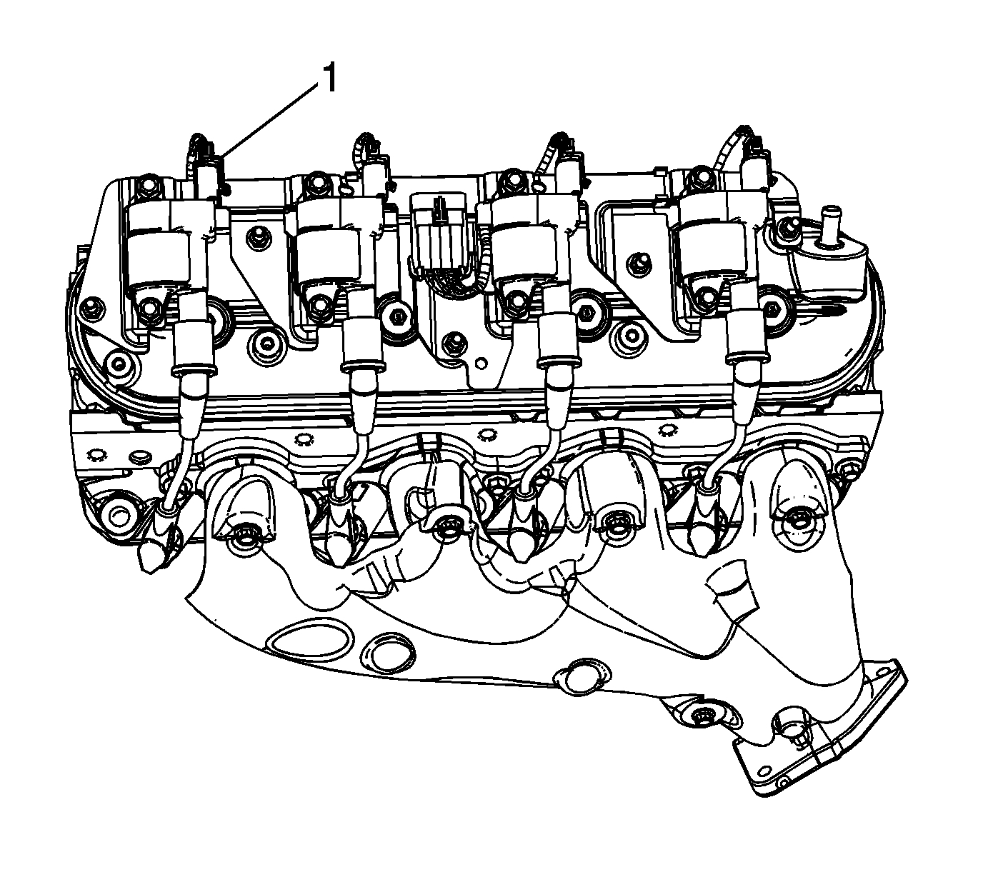

2. Disconnect the ignition coil wiring harness electrical connector (1) from the ignition coil.
pic 3
3. Remove the spark plug wire from the ignition coil.
* Twist the spark plug wire boot a 1/2 turn.
* Pull only on the boot in order to remove the wire from the ignition coil.
4. Remove the ignition coil bolts.
5. Remove the ignition coil from the bracket. (left side shown, right side similar).

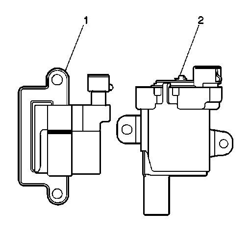

6. There are 2 different manufacturers for the ignition coils and coil brackets. They are as follows:
pic 4
7. The Melco(R) (1) ignition coil is a square design.
8. The Delphi(R) (2) ignition coil is a round design.

9. The Melco(R) ignition coil bracket (1) is a square design.
10. The Delphi(R) ignition coil bracket (2) is a round design.
