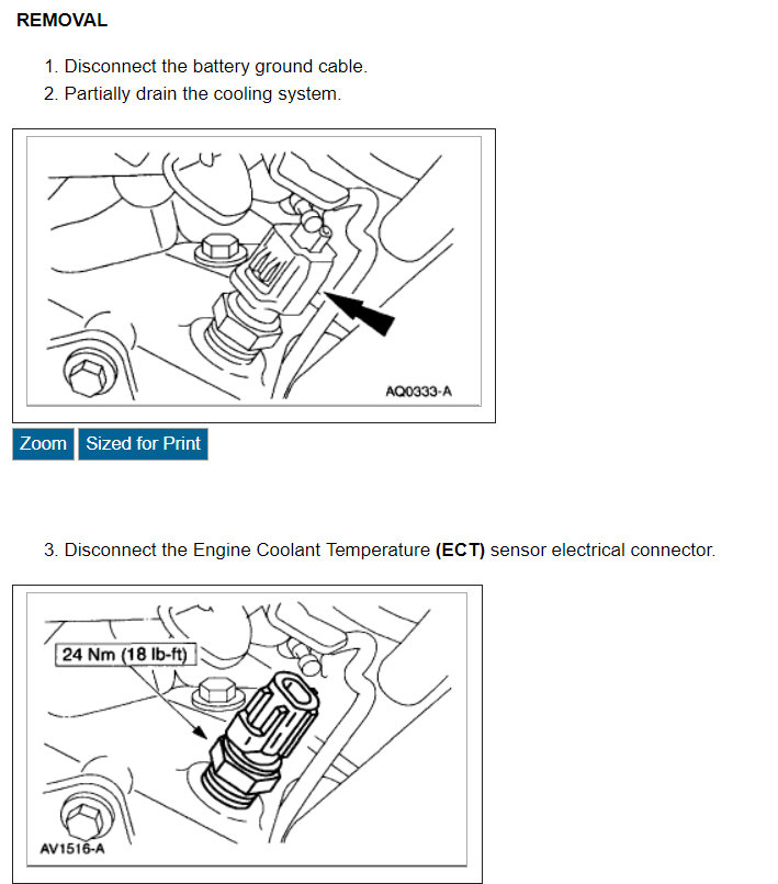

where is located the engine coolant temperature sensor on a windstar 2003?
Aug 27, 2014 at 12:36 PM
Check out the diagrams (Below) Please let us know if you need anything else to get the problem fixed.
