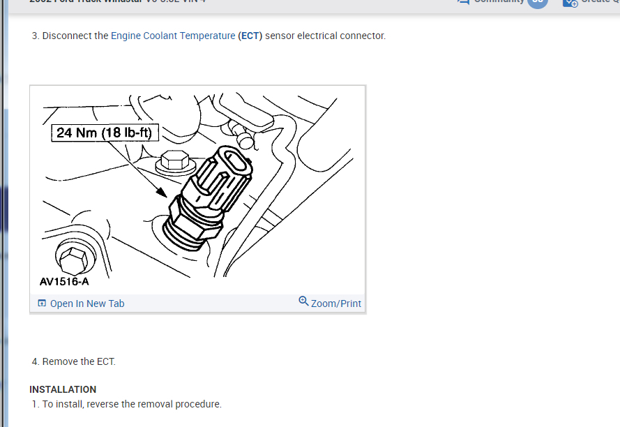

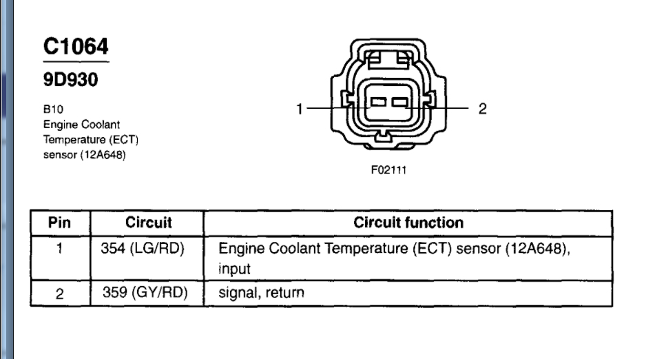

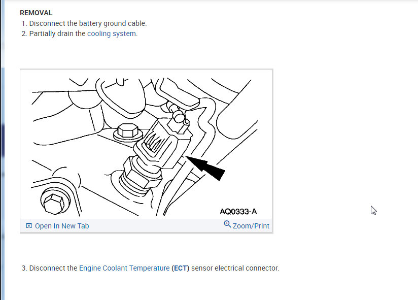

This sensor is on the top of the engine toward the rear. It should actually be in a cylinder head as they are technically called CHT, Cylinder Head Temperature sensors. Here is a guide that will help with this:
https://www.2carpros.com/articles/coolant-temperature-sensor-cts-replacement
Below is the process from the manual. Please let us know if you still can't find it. Thanks
