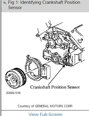

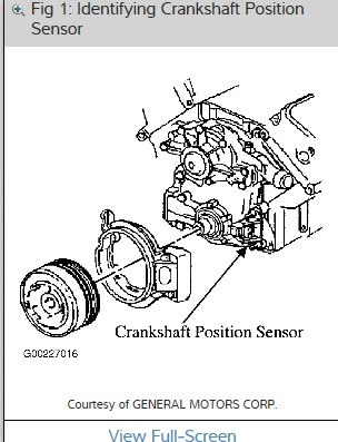

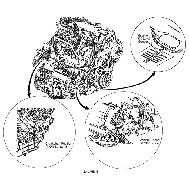

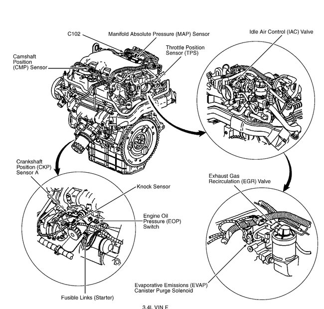

I took my car to have codes checked. I included the list of codes. AutoZone printout suggested replacing CKP. I am not sure where it is located.
Jan 9, 2017 at 6:31 PM
CARADIODOC
  • 34,306 POSTS
Here is the sensor locations. Check out the diagrams (Below). Please let us know if you need anything else to get the problem fixed.
