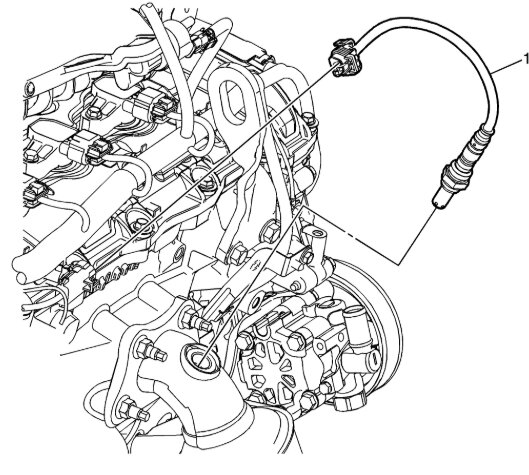

Hi I need help finding bank 1 upstream o2 sensor on a 2014 Chevy Equinox 3.6L AWD.

I can help you, the bank 1 upstream o2 sensor is one the right side of the engine up on the exhaust manifold. Check out the images (below). Let us know if you need anything else.
