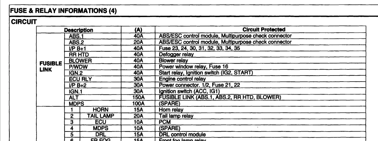

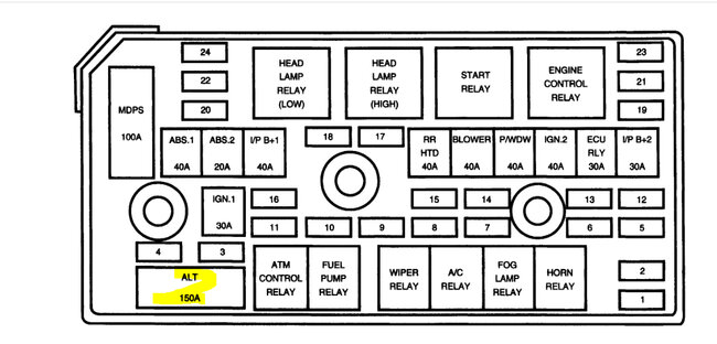

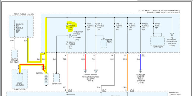

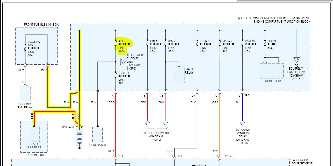

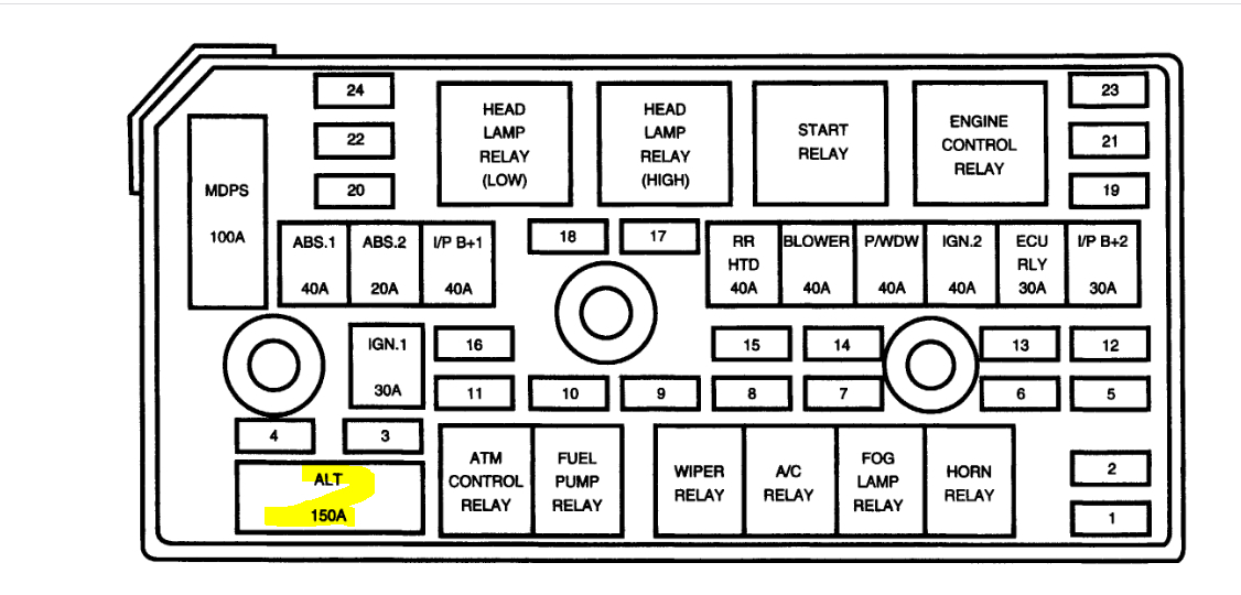

I went through the power distribution schematics and there is only one 150-amp fusible link. It is for the alternator and the ABS system and is located in the engine compartment junction box. See pics below.
