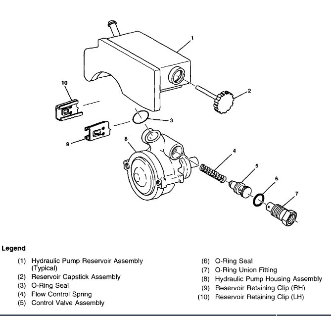

i replaced it and the fluid is just flowing out under the vehicle when i turn it on.

Here is a quick tutorial for you to view on a power steering pump replacement:
https://www.2carpros.com/articles/how-to-replace-a-power-steering-pump
I've attached an exploded view diagram picture below of your vehicles power steering pump.Hope this helps and thanks for using 2CarPros.
Danny-
