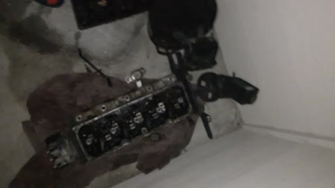

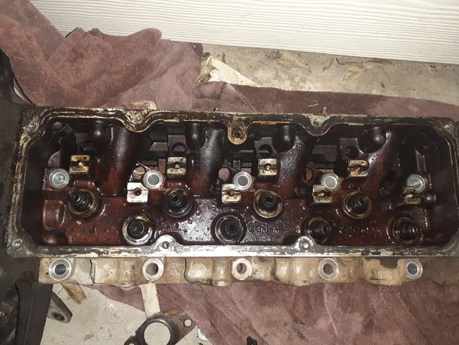

I ended up taking the head off and stripping it bare. The valves i'm going to clean and also reuse everything but not the remaining springs. but there is a problem; I can't find them to buy anywhere! Please help.

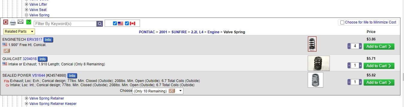

Rock auto has the springs for you. I attached the link to the springs for you.
I would also suggest lapping in the valves providing the margins are still good.

Measure the height of the springs to match up.
Parts stores will carry the tool and ask for a valve grinding compound.
