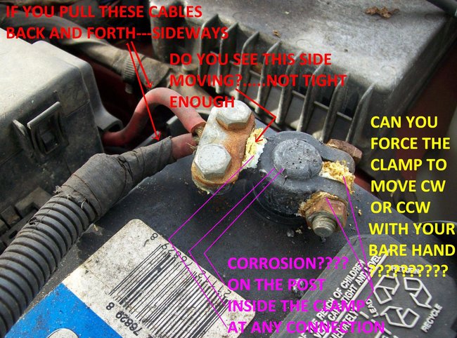

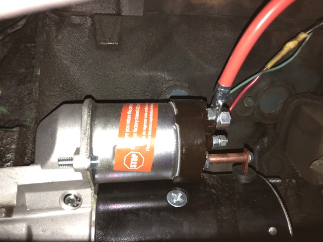

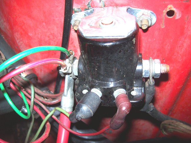

Let's check the connections to this puppy "solenoid" (picture below) (mine may be wired different than yours). Loosen nuts/move the wires around/tighten the nuts back up.
Also, insure you did not accidentally knock one of the little "push on" connectors off of it.
No luck? Do you have a cheap digital voltmeter (Harbor Freight has them for about $5.00)
Send any more information that may help, pictures are nice too!

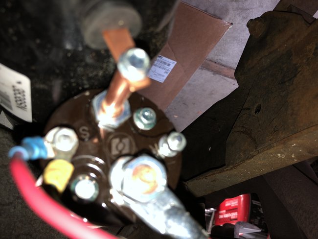

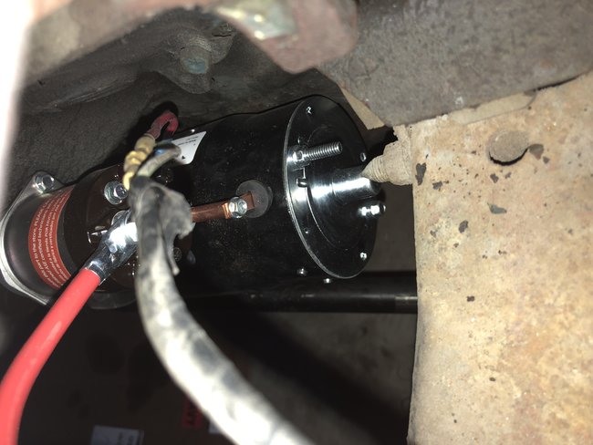

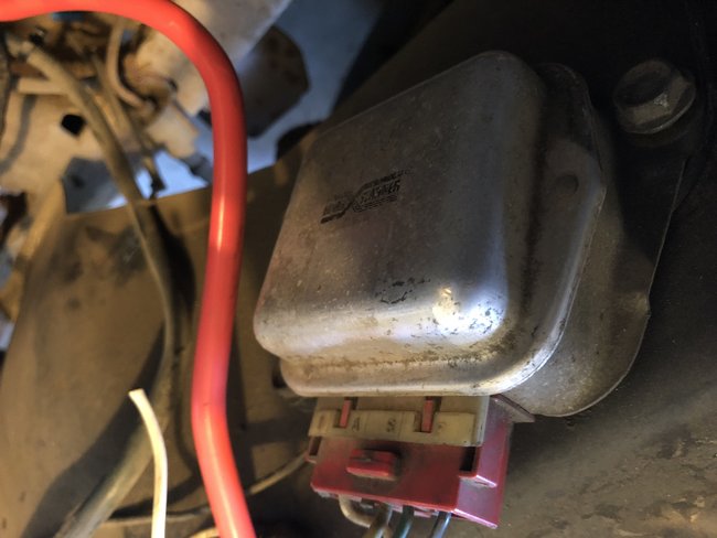

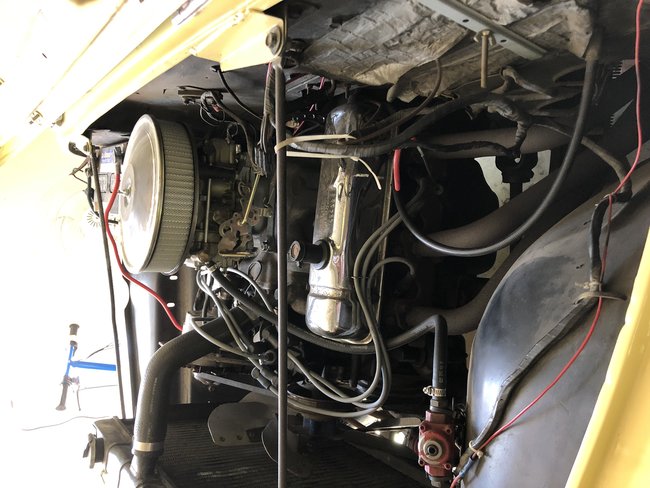

I believe the solenoid is attached to the starter hence came with the starter and is new as well. Only two wires running to it. I connected everything back to the starter and the solenoid as it was to begin with. Also, I have no idea what this little box is that is bolted onto the inside fender. Could that be the voltage regulator? The wires run to the alternator. Could that be the issue? It is baffling because I did not mess with either one while changing the starter.

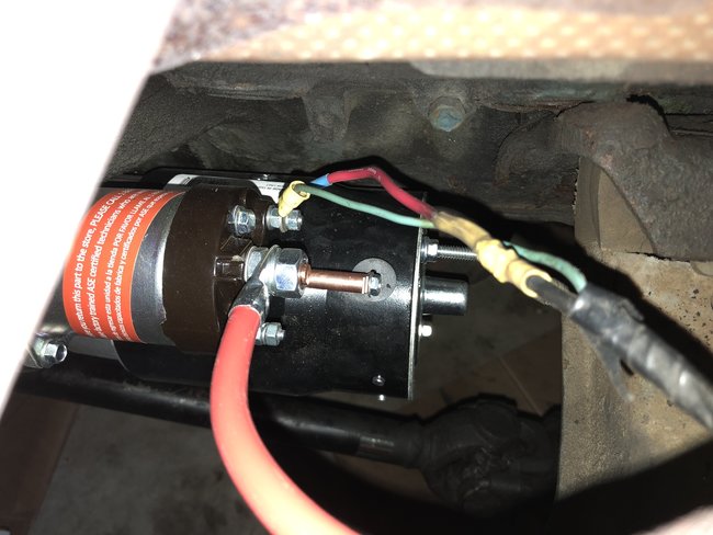

Can you send a picture showing the connections at the solenoid? (So I can see how it is hooked up)
Do you have voltage at the battery cable at the solenoid connection?

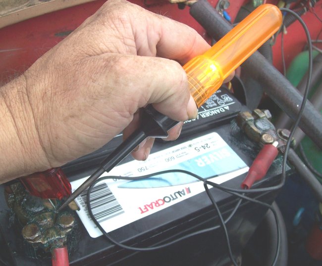

Do you have a voltmeter? One step down- a test light?
Yes! That is the voltage regulator-probably no bearing on the situation at hand.

From the pictures, looks like maybe some of the wiring has been changed.

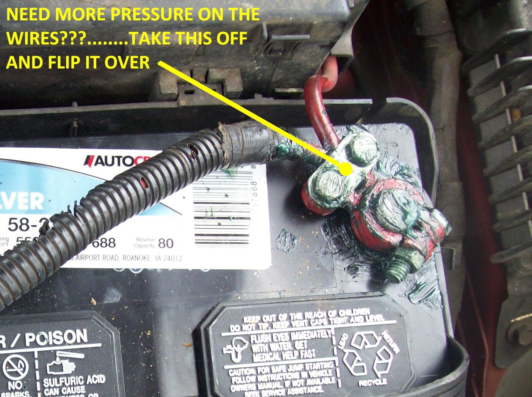

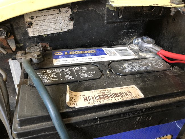

Check the ground wire (both ends) from the battery.
Set your voltmeter to "20 volts DC" (turn it on). Black lead to the battery ground, the red lead on your red wire, wherever it takes you.

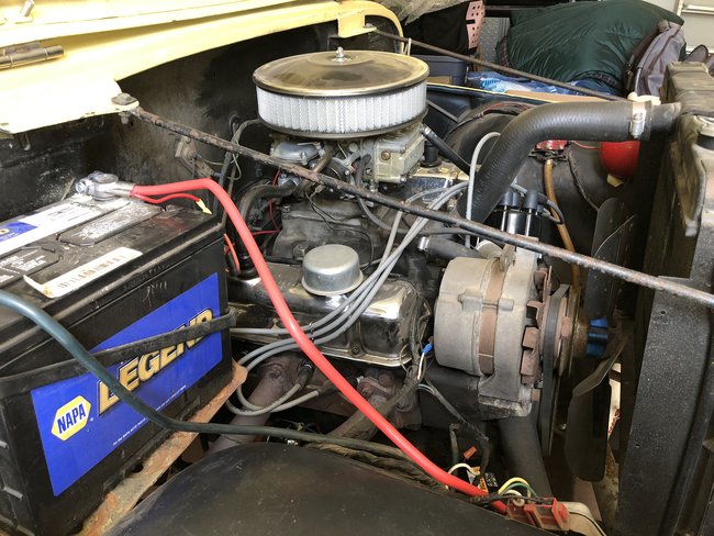

Nice looking engine!
Still use the points system?
Send picture of the Jeep, we like to see them too.

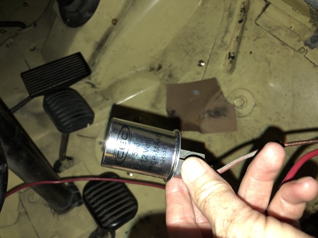

I replaced the red wire coming off of the positive cable which leads to a twelve volt flasher fuse, which I also replaced. There is twelve volts at the wire there. There are two other wires leading into that same fuse, one to the windshield wipers and the other to the headlights. It is a bit of a mess right now, but I will send some picks of the Jeep anyway.
