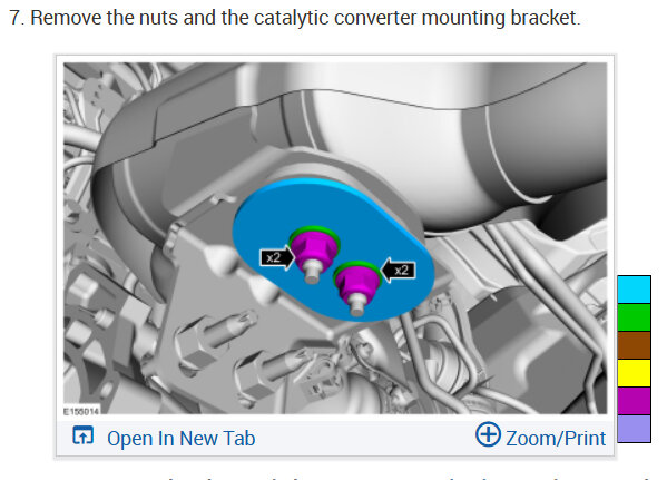

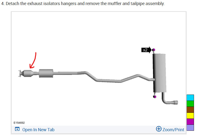

This can have two catalytic converters; the first one is near the exhaust manifold right after the turbo and the other is down on the exhaust system slightly. Here are what they look like.
