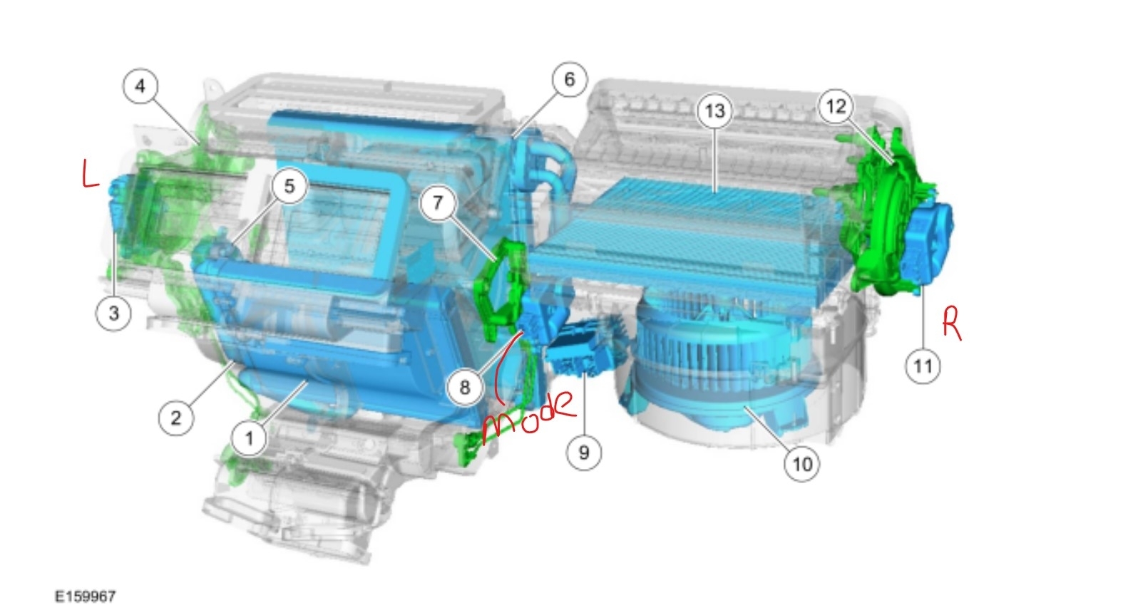

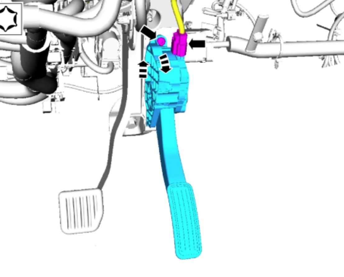

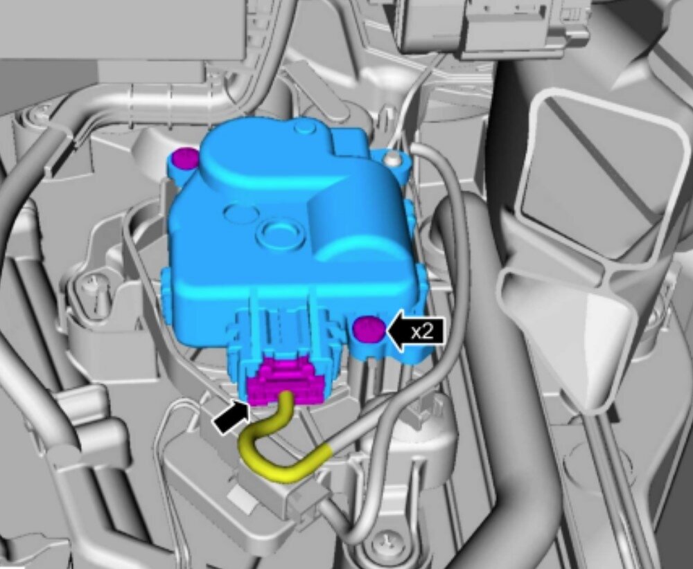

If the right side is working but the left side, isn't you should be able to change only the left side. There are only the three actuators as in the last image. For the left side you remove the throttle pedal and look to the right of it on the HVAC case and the actuator is there. Remove the screws and the electrical connector and reverse the process to install the new one.

How do I get to the mode?

Ok, I was able to find the mode and changed it out and it fixed the issue. Thanks!!!!

That's strange. The mode actuator would be the one in the middle (8) and it just selects where the air goes, not the temperature of it, or is that what you meant originally, that you couldn't select where the air went and not that you couldn't change the temperature? Either way, glad to hear you found the issue.

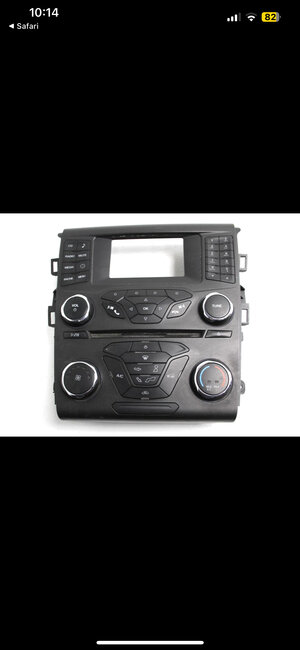

It’s been kinda difficult finding the radio part for my year (2016), would going up one year be possible if it’s the same part ?
Sep 20, 2025 at 7:39 PM
STEVE W.
  • 15,113 POSTS

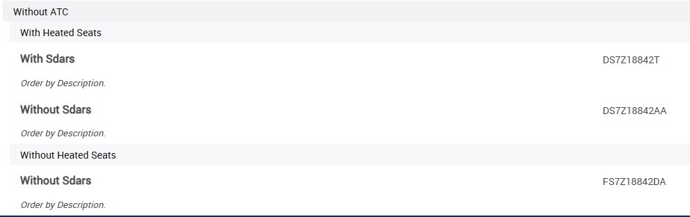

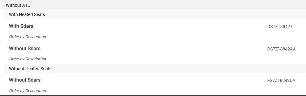

Have you looked on ebay? It looks like there were 3 units available with the manual temp controls. One with heated seats and satellite - DS7Z18842T One with heated seats but no satellite - DS7Z18842AA And the base version with no sat or heated seats - FS7Z18842DA
Search using those and there are a bunch that show up.
