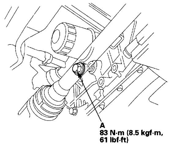

Unfortunately there is no mention of freeze plug replacement or location in the factory service manual. There is however a coolant drain plug located on the back of the engine block, just below the oil filter. Please see the attached picture.
