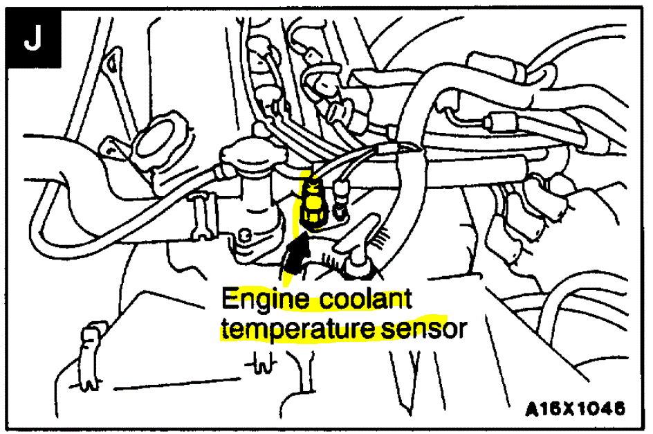

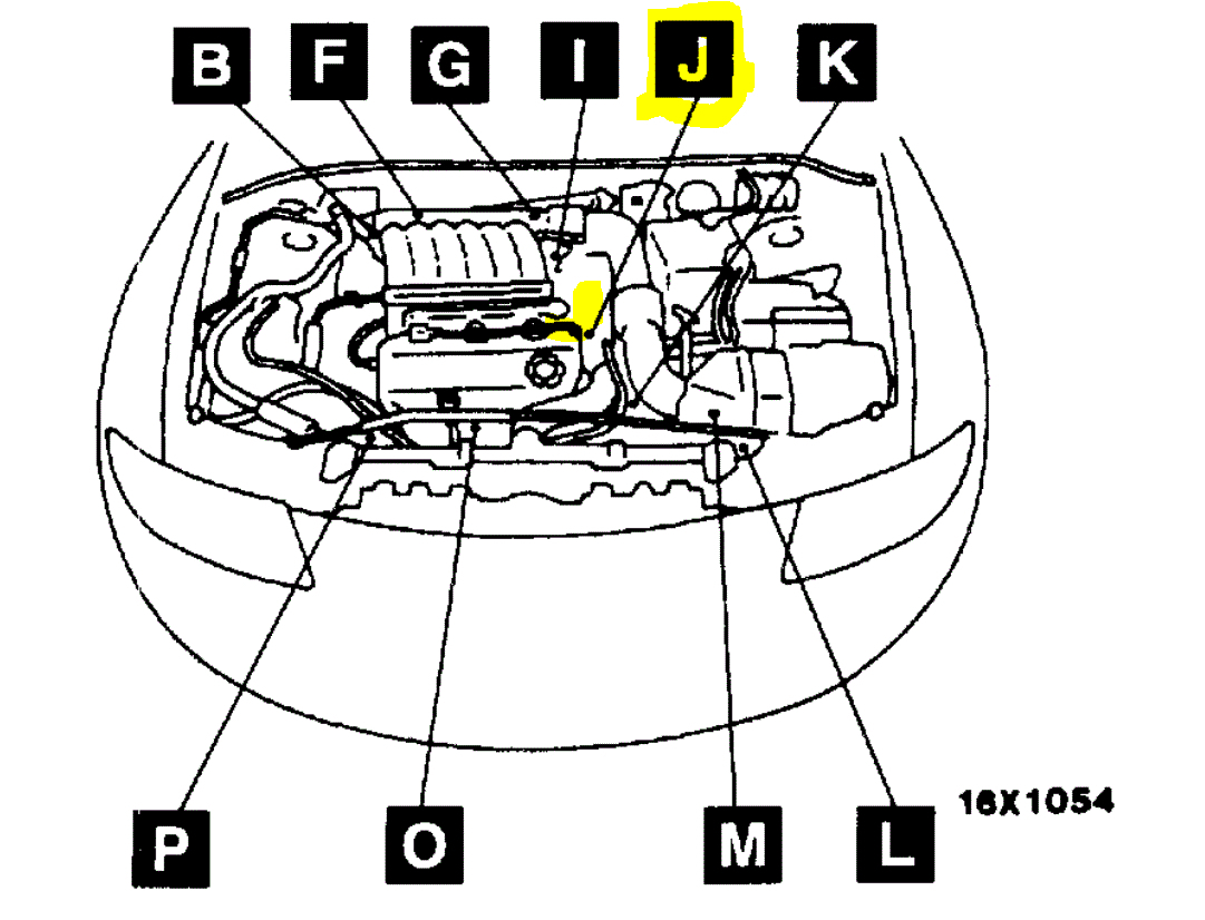

The ECT is located behind the thermostat housing. If you take a look at pic 1 below, it gives an approximate location. Pic 2 shows the sensor.

When you install the new one, you need to use a sealer on the threaded portion of the sensor. Here is the part number for the OEM sealer used but you can use something other than is comparable.
MOPAR Part No. 4318031
See pics below.
