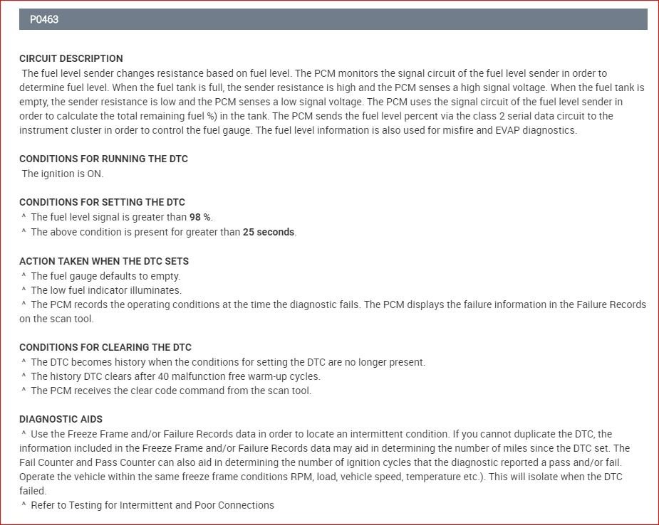

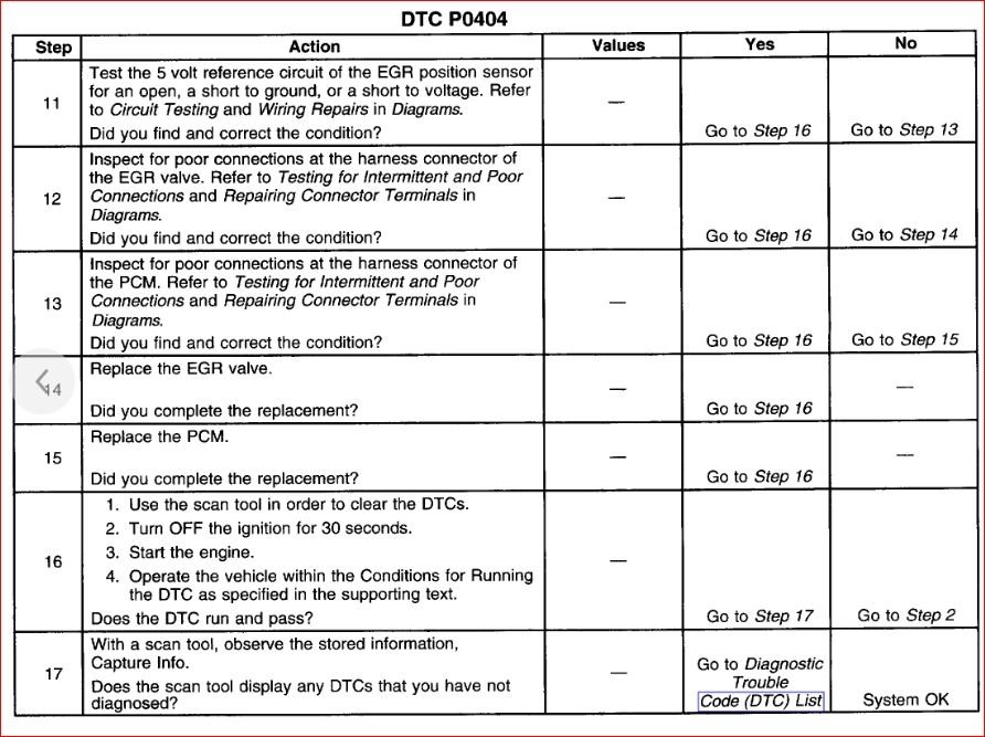

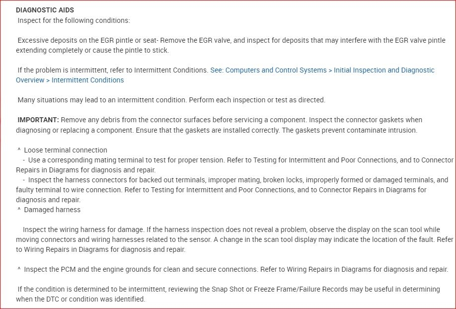

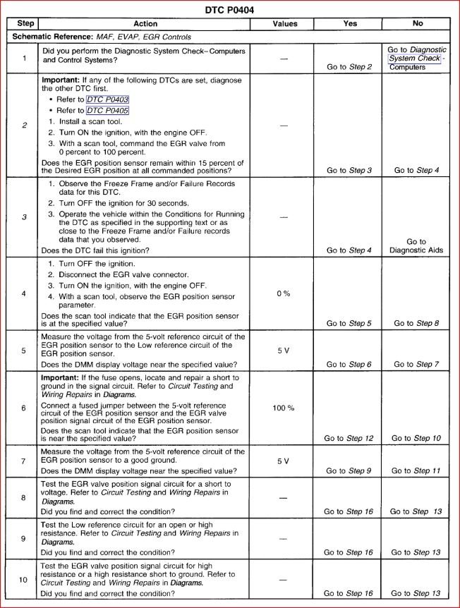

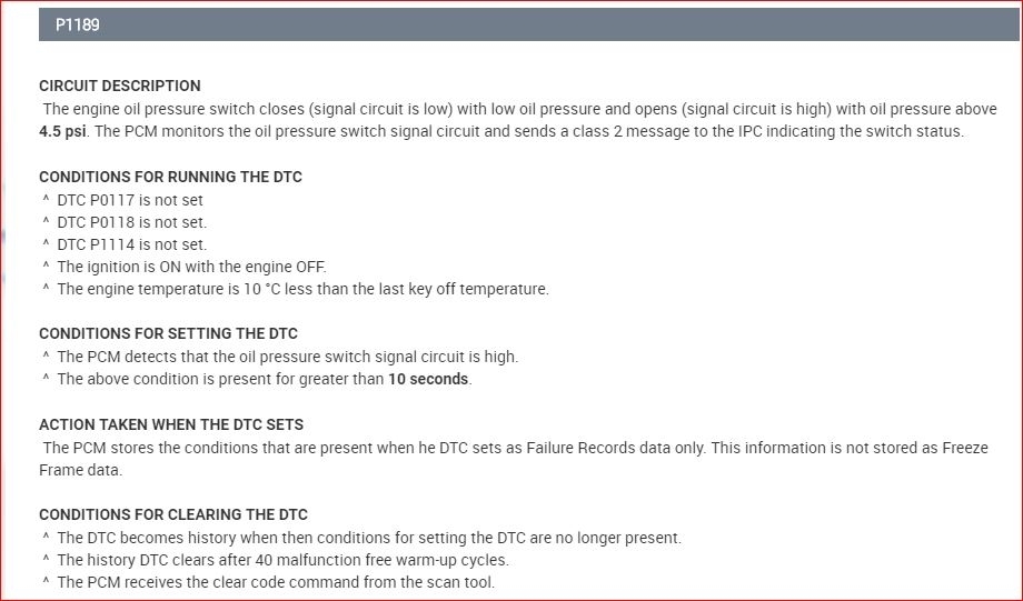

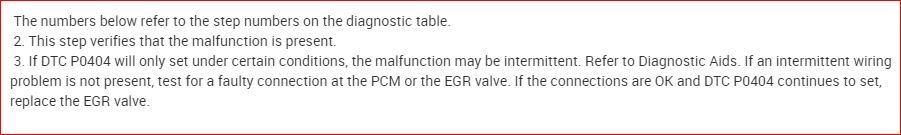

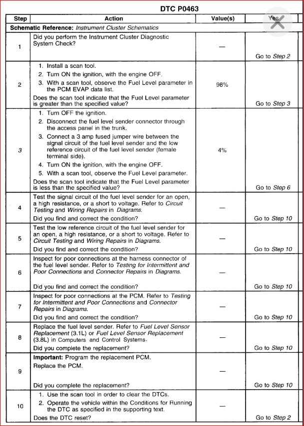

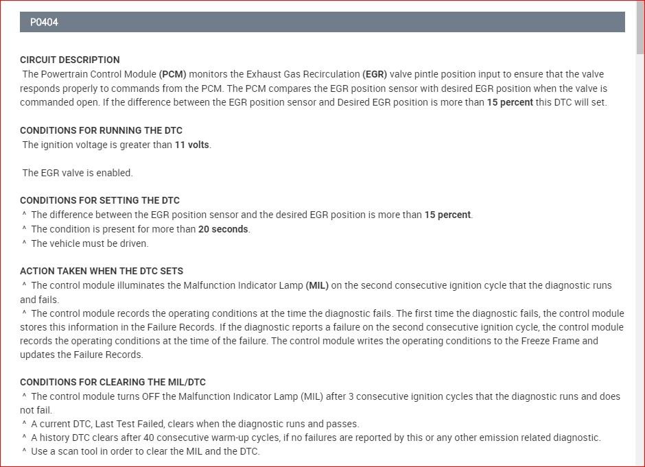

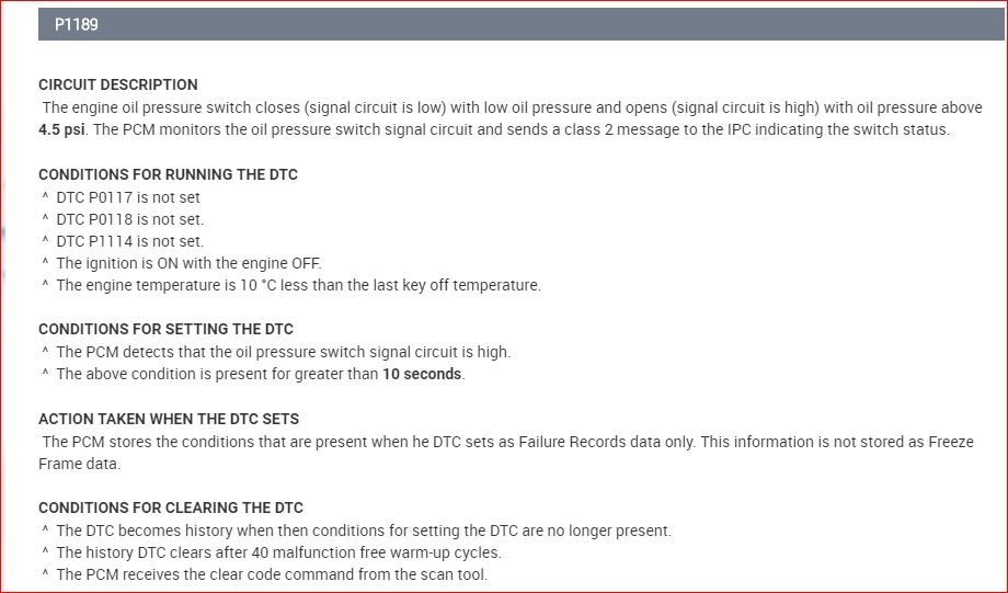

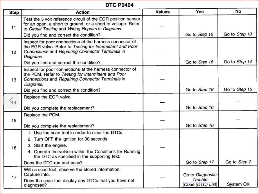

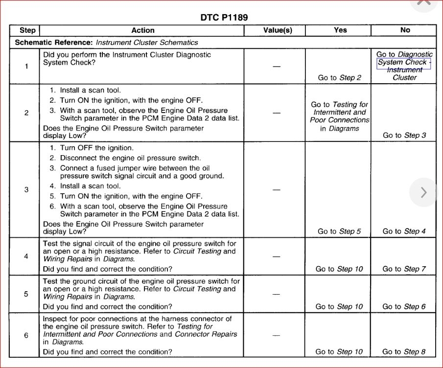

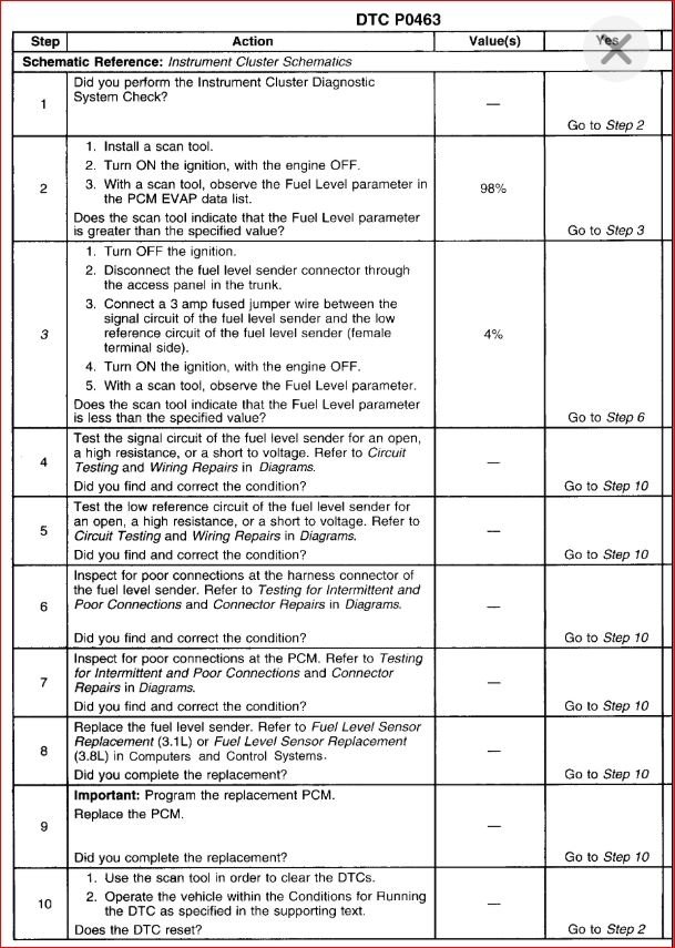

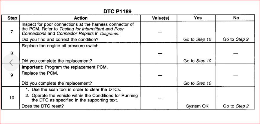

P0404 - EGR valve position
P0463 - Fuel level sender position
P1189 - Oil pressure switch signal

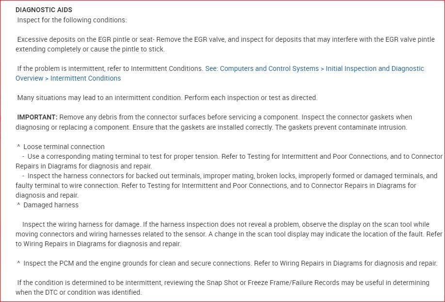

I would suggest starting with the EGR valve code. If this is clogged or stuck it will cause slow acceleration because it affects the PCM's ability to maintain the proper air/fuel ratio. Run through the diag and see what you come up with.
The other two look like sensor issues so I don't think they will cause what you are describing. However, I included the diagnostics for them because they should be addressed. Let me know if you have any questions.
