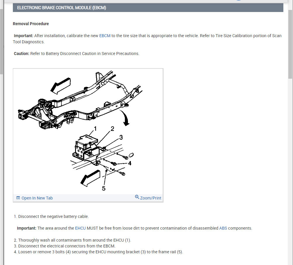

Does a new ABS control module need to reprogram?
2000 CHEVROLET SILVERADO
130,000 MILES • 5.3L • V8 • 2WD • AUTOMATIC
MICHAELMONJE71
Shops are saying needs to be reprogrammed by dealership before putting in .
Sep 18, 2021 at 1:11 PM
JIS001
  • 3,412 POSTS

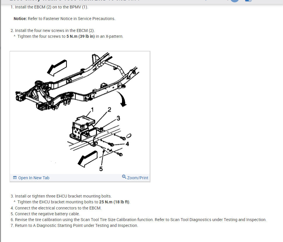

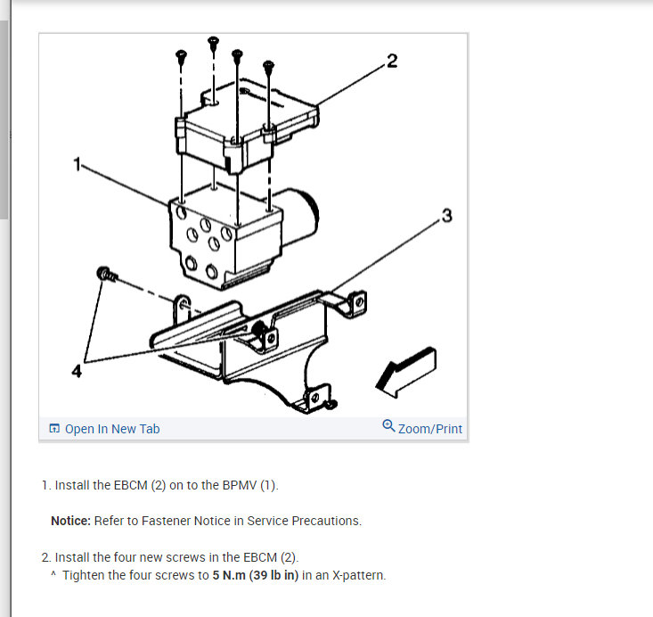

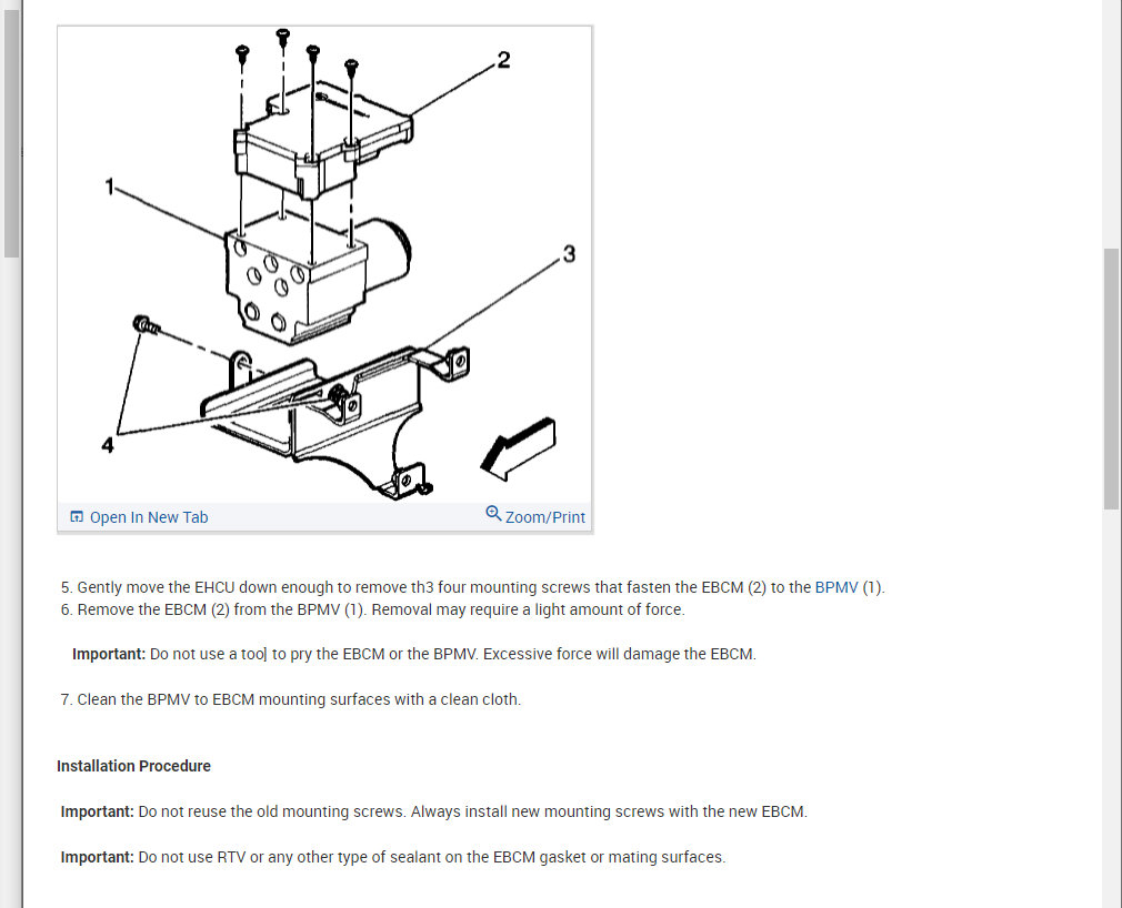

On this model there is no software module to download but you do need a compatible scanner to program the correct tire size to it so that you get an accurate vehicle speed reading. Here is a link on how to replace the module with a video to a vehicle almost similar to yours:
https://www.2carpros.com/articles/how-to-replace-a-abs-controller
You can see the entire process below from the manual.
