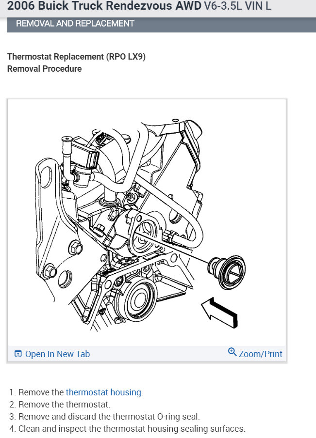

If I pump the gas pedal a few times it won't shut off. If it shuts off it starts right back up and runs awhile longer then does again. If it is below 45 degrees the problem doesn't happen as much if at all. Check engine code read for thermostat. Any ideas? Thanks
