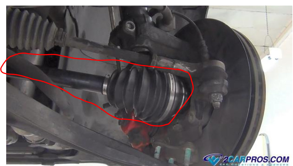

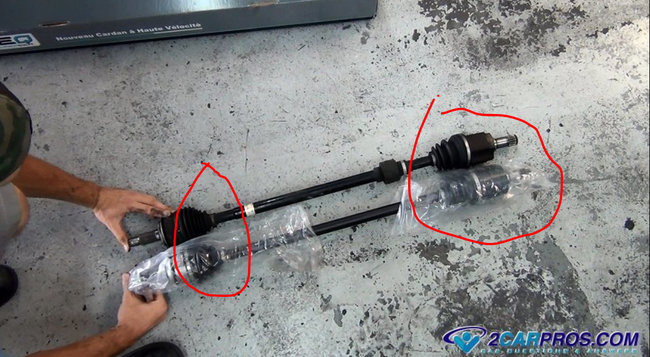

Are you able to drive the vehicle? I need to know that to confirm it isn't a broken CV/axle joint. If not, it sounds like there is an issue with what is called the range selector cable and the vehicle isn't actually shifting into park. The first thing I suggest is to try and adjust the cable.
