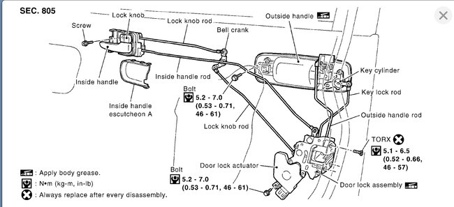

Hello everyone, a bit of a strange one. My vehicle listed above dci seems to lock and unlock the doors constantly as I drive the vehicle. It’s only started today, also the central locking doesn’t seem to work so it’s all very confusing. so if anyone can help with that problem to that would be amazing!
Thanks
Jan 15, 2019 at 7:00 AM

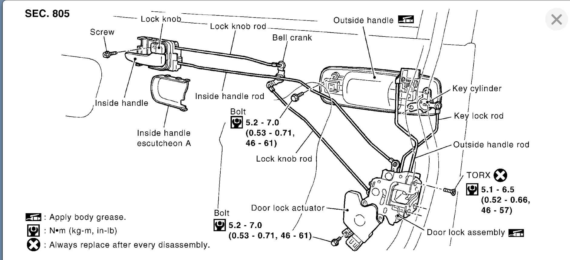

Nine times out of ten it's because the drivers door latch/lock needs to be replaced. Here are diagrams to help you with the repair below. Please let me know what you find. You can unplug the latch and drive it to confirm the issue. Check out the diagrams (below). Please let us know what happens.
