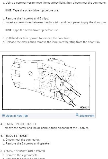

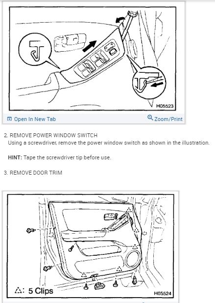

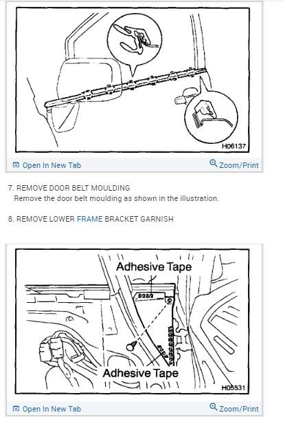

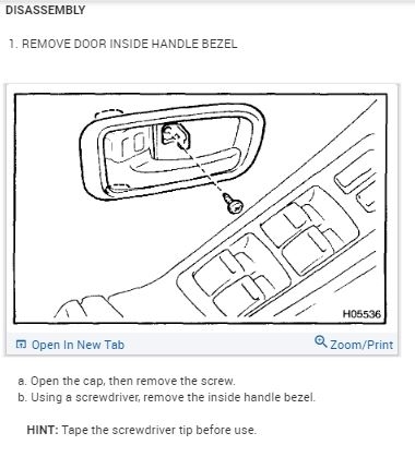

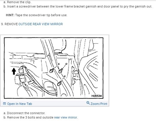

But personally, I think that your latch is simply worn out. When it's cold, the moving parts are sticking a little too close together and the weakened spring can't push the arm back to where the door is latched. It won't be long before it won't latch at all. AllData does not have instructions on removing the latch, but I did find instructions on removing the panel at least. They're attached in the images below.
Check it out and report your findings. We'll go from there.
