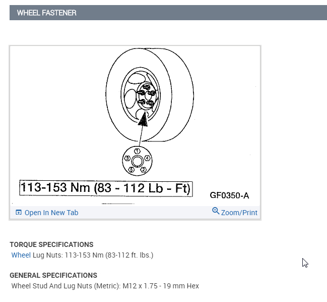

Here are the torque specs for tightening the lugs. I would replace the lugs again and then inspect all the others to make sure they are not stripped and then torque them to the proper spec.
Let me know if this make sense. Thanks

Ford's torque specs for your wheels have a rather broad range of 83 to 112 foot pounds. I wouldn't go much higher than 100 - 105 foot pounds with cast wheels. 110 foot pounds should be good for steel wheels.

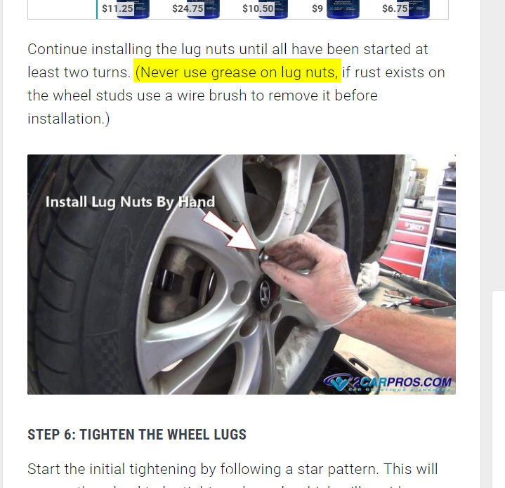

Just to jump back in. You don't want to put anything on the studs like oil, grease, anti seize. The lugs can rust but you just simply brush it off with a wiring brush. If they are bad enough then you replace them. Take a look at the guide that Cariodoc provided (screen shot below).
When you add this to the stud, it actually changes the torque force because it lubricates the threads and allows it to turn more as the friction on the stud to lug is less and you can over torque them again and compromise the stud.
