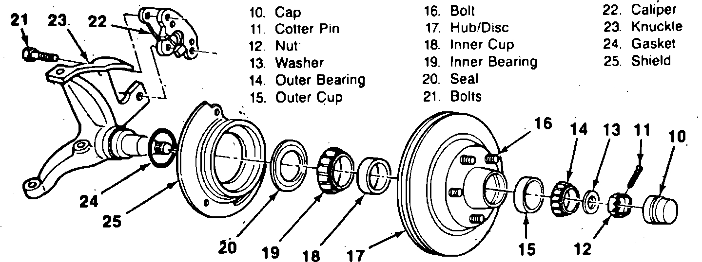

Here are the directions right from Alldata for replacement. Make sure you followed all directions. Additionally, I attached an exploded view of this system. Check to make sure everything is together in the proper order.
