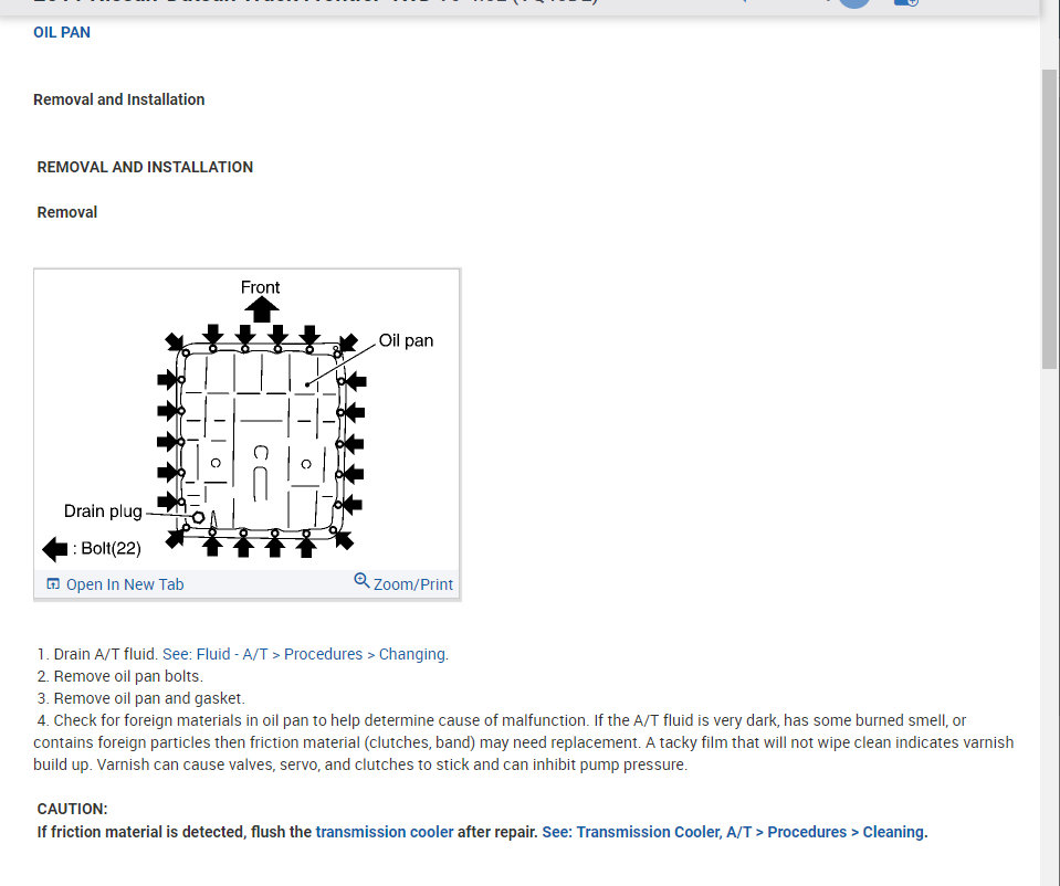

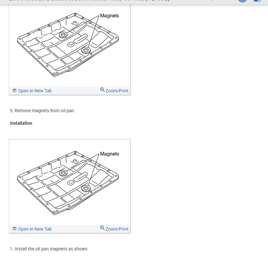

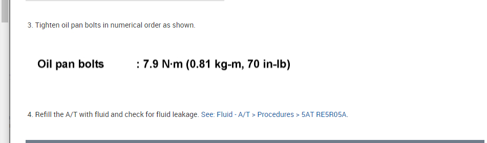

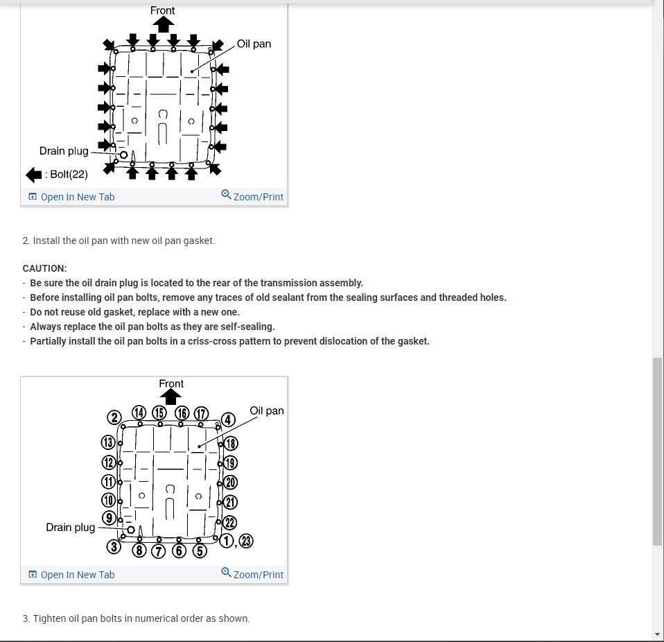

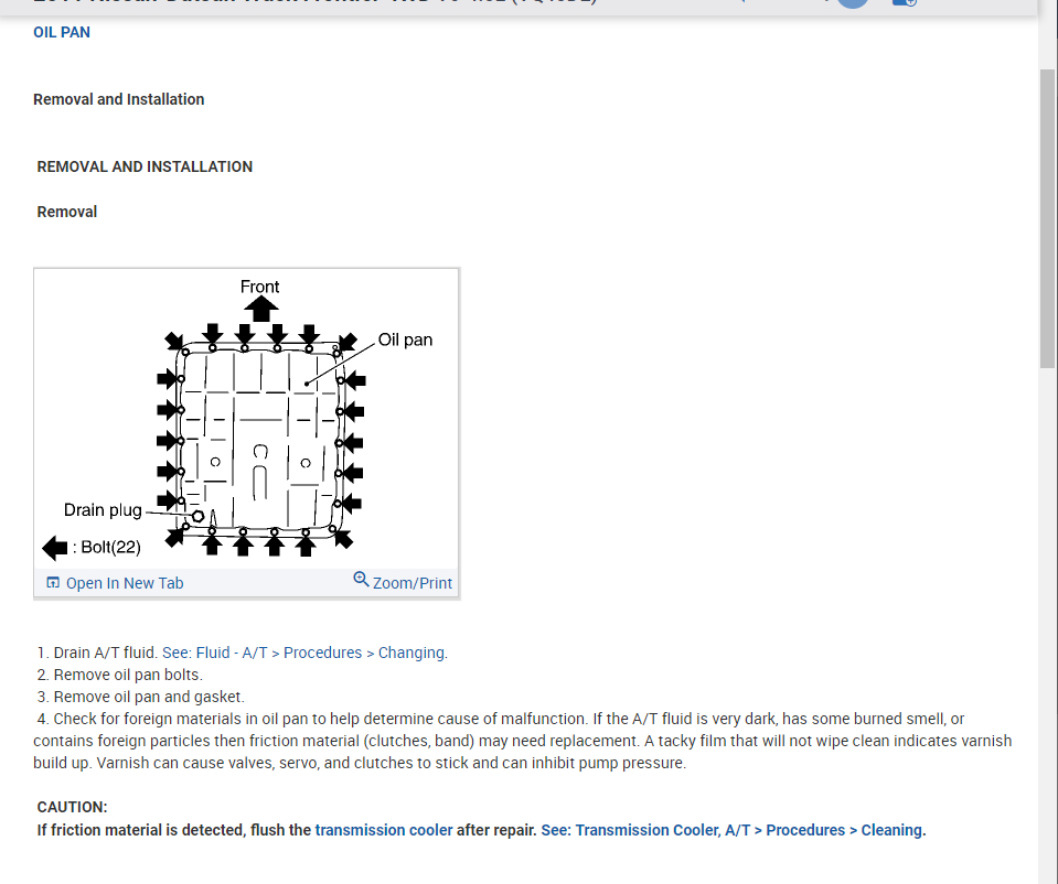

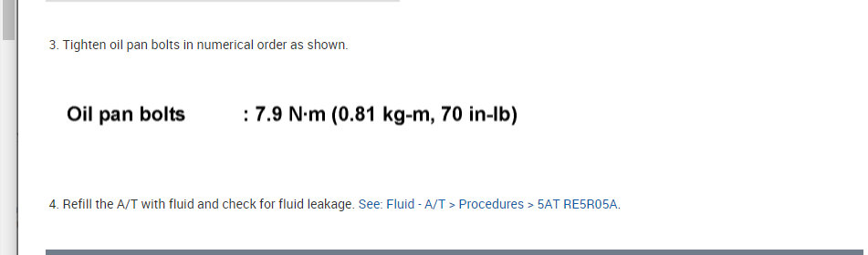

Then we need to more then likely drop the pan and find out if there is metal or clutch debris in the fluid. I attached the info from the manual on how to do this below.
Please run through this info and let us know if you have other questions. Thanks
