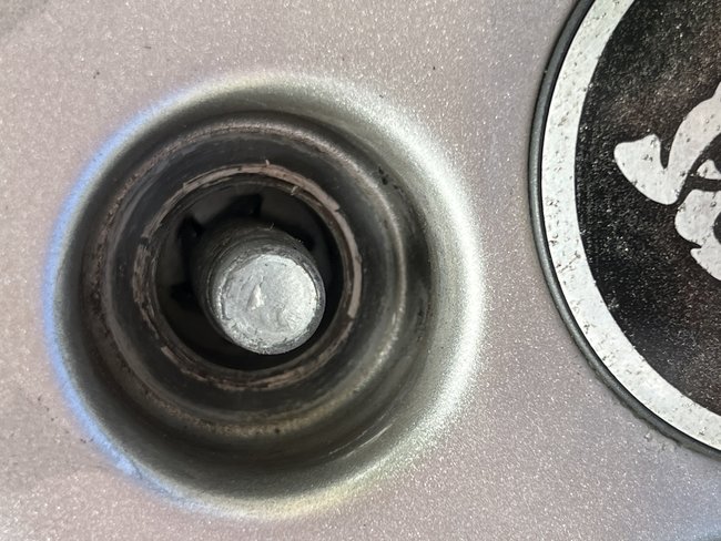

I removed the lug nuts from my car, none were the locking variety. I still cannot remove the wheel. There appears to be some kind of spiral retainer that grips the studs on two of the studs inside the rim. How to remove the wheel is my question and what tool, if any, do I need to do this? There was no special took wheel nut removal tool with the jack.
See the attached photo.

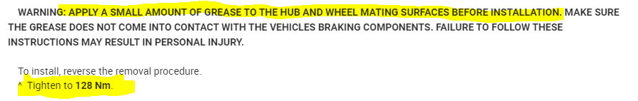

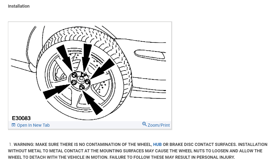

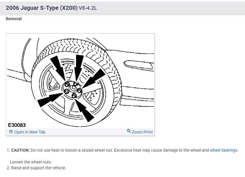

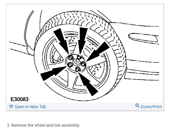

I attached the directions below for removing the wheel. There is nothing other than the lug nuts holding them. However, pay attention to what I highlighted.
Let me know if that helps.

Here is a photo that shows what looks like a star washer inserted two of the studs have this. The other 3 do not. The “washer” grabs the studs.
Sep 6, 2022 at 9:06 AM
I believe that it is a rotor retainer from the factory for production purposes. The wheel should still come off. They use those to prevent the rotor from falling off on the assembly line.

Thank you for your help. They were rotor retainers and not wheel retention devices. The wheels came right off with a little persuasion.
