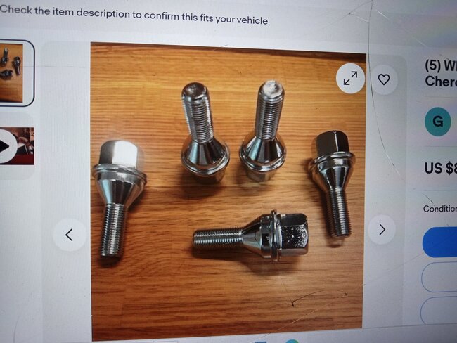

yes I checked the other wheels lug nuts. I retorqued only the rear driver side wheel. The torque wrench turned not even a 1/4 turn . both wheels on the passenger side were good . I did not put antiseize on the studs I torqued them dry. The lug nuts of the jeep are different please look at the pic

I don't know what the advantage is of this design. VW used it a long time ago. I still have a suspicion this problem started a while ago with some other service. Another thing to consider, especially if you live in a state like I do where they throw a pound of salt on an ounce of snow, is corrosion on the backside of the wheel. Aluminum, if scratched, will corrode within seconds and turn a dull gray. That aluminum oxide is a good insulator that prevents further corrosion until it is scratched again. Once that starts, when the wheel is removed, some corrosion can stick to the hub, then hold the wheel from sitting flush when it's reinstalled. Even though it's torqued to specs, any slight movement will grind that corrosion down resulting in the wheel not at full tightness.
A quarter turn on the torque wrench when rechecking them is too much. That suggests the holes in the wheel are already deformed and are wearing away, or the aluminum is being crushed. If this happens again, replace that wheel and studs too.
