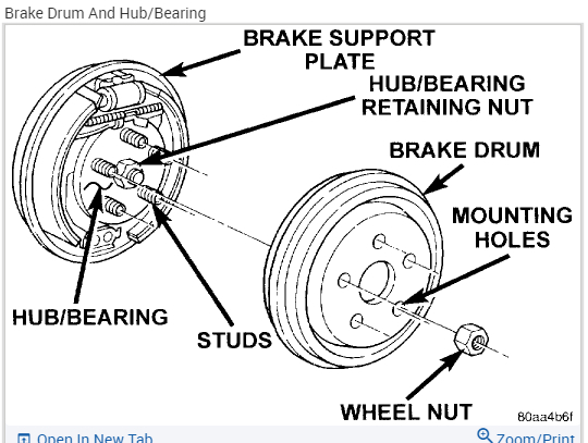

My back tire will not turn all the rest will.

Since your car is a front wheel drive it sounds like your rear hub/bearing assembly has froze up. Here is a tutorial showing how a front hub is replaced.Yours is a little different being the rear.
https://www.2carpros.com/articles/bearing-hub-replacement
I've attached a picture below.Hope this helps and thanks for using 2CarPros.
