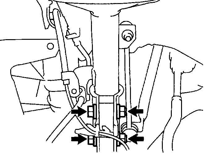

1. REMOVE FRONT WHEEL
Picture 1

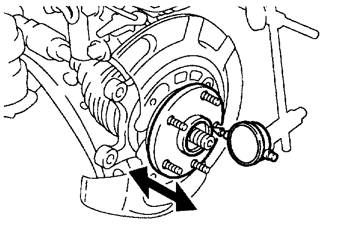

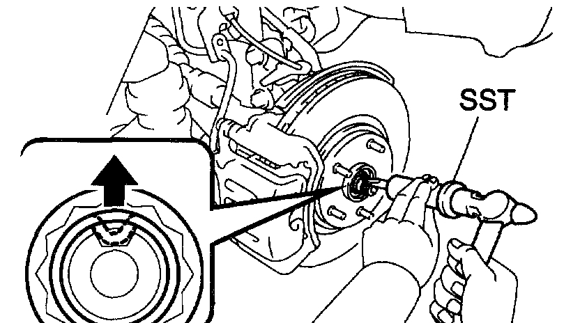

2. REMOVE FRONT AXLE HUB LH NUT
a. Using SST and a hammer, unstake the staked part of the lock nut.
SST 09930-00010
b. While applying the brakes, remove the lock nut.

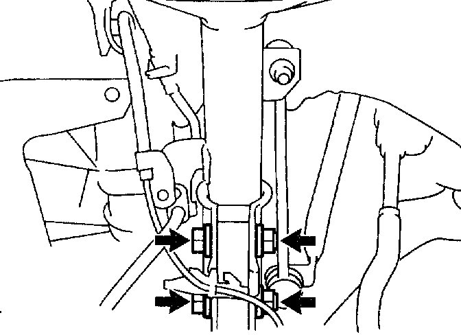

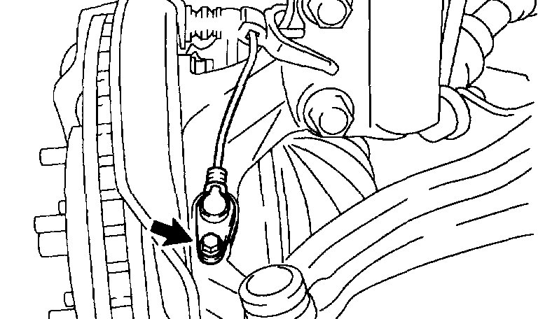

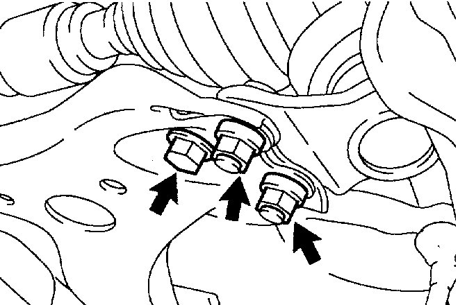

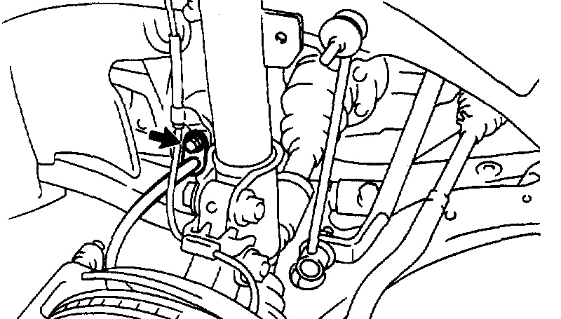

3. SEPARATE SPEED SENSOR FRONT LH
Picture 2

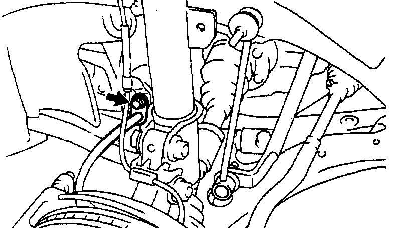

a. Remove the bolt, separate the sensor wire and flexible hose from the shock absorber.
Picture 3
b. Remove the bolt and separate the speed sensor from the steering knuckle.

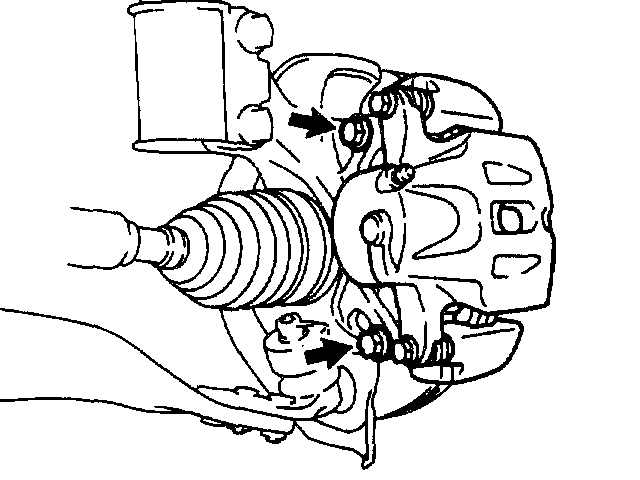

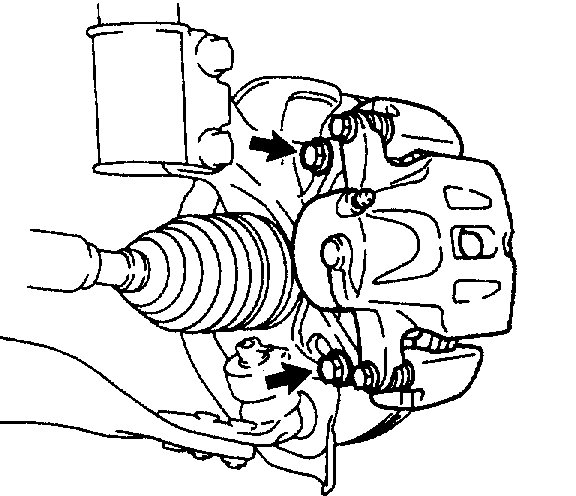

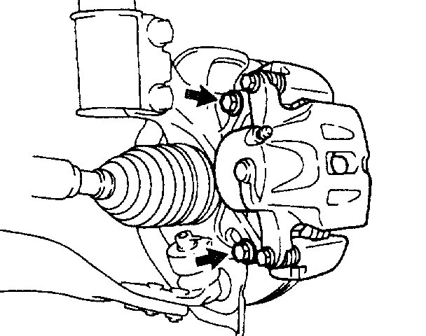

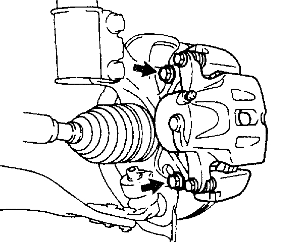

4. SEPARATE FRONT DISC BRAKE CALIPER ASSY LH
a. Remove the 2 bolts, separate the brake caliper from the drive shaft.

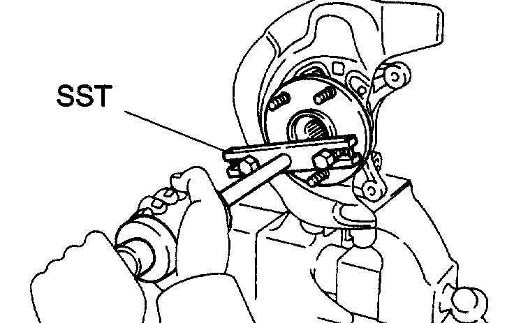

6. SEPARATE TIE ROD ASSY LH
a. Remove the cotter pin and nut.
b. Using SST, separate the tie rod end from the steering knuckle.
SST 09628-62011

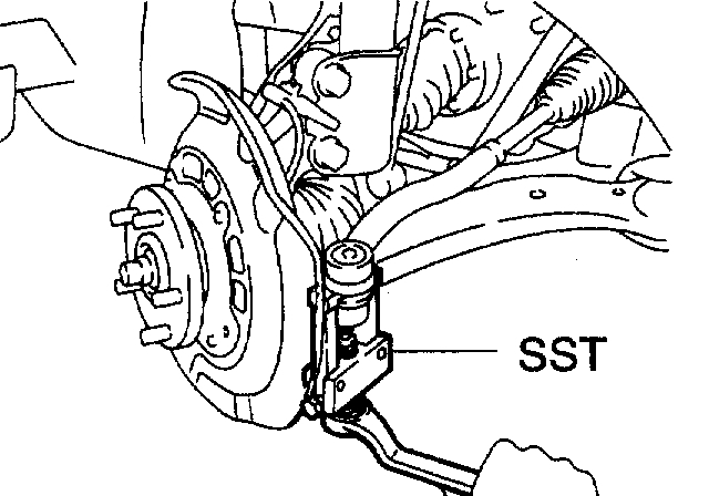

9. REMOVE LOWER BALL JOINT ASSY FRONT LH
Picture 7
Picture 8
b. Using SST, remove the ball joint.
SST 09628-62011

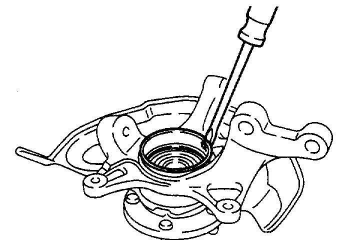

10. REMOVE FRONT WHEEL BEARING DUST DEFLECTOR NO. 1 LH
a. Using a screwdriver, remove the dust deflector.
Picture 10

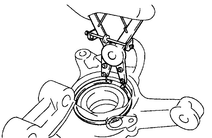

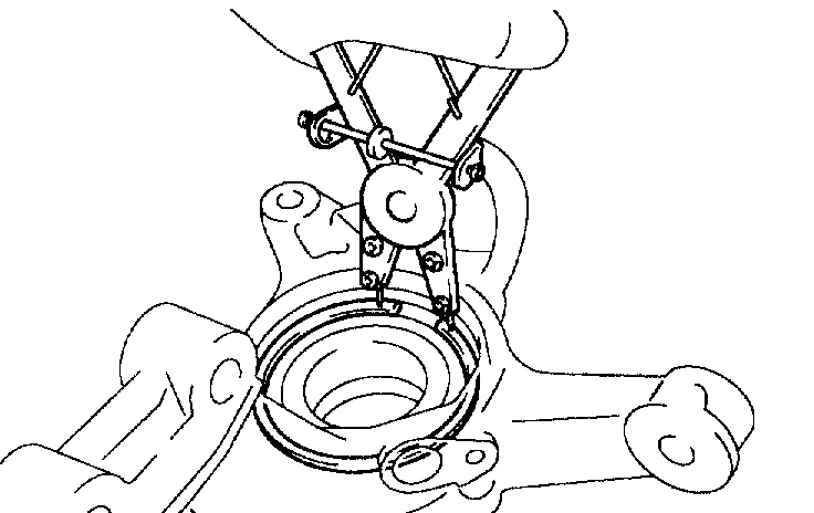

11. REMOVE FRONT AXLE HUB LH HOLE SNAP RING
a. Using a snap ring plier, remove the snap ring.

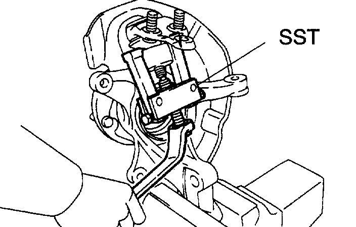

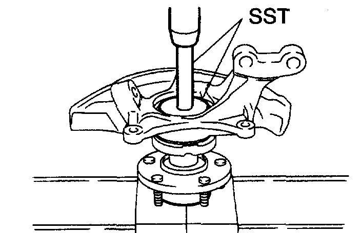

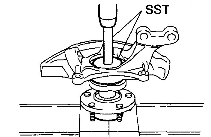

12. REMOVE FRONT AXLE HUB SUB-ASSY LH
Picture 11
a. Using SST, remove the axle hub.
SST 09520-00031

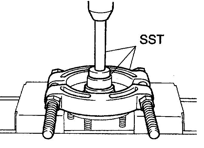

Picture 12
b. Using SST and a press, remove the inner race (outside) from the axle hub.
SST 09950-00020, 09950-60010 (09951-00410), 09950-70010 (09951-07100)

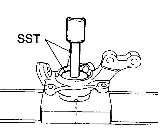

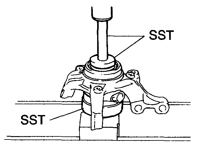

14. REMOVE FRONT AXLE HUB LH BEARING
a. Place the inner race (outside) on the bearing.
Picture 13
b. Using SST and a press, press the bearing until it contacts with the SST.
SST 09527-17011, 09950-60010 (09951-00600), 09950-70010 (09951-07100)

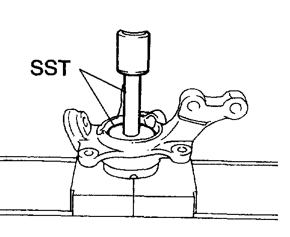

Picture 14
c. Using a spanner to make the steering knuckle horizontal, fix it to the V block as shown in the illustration.
NOTICE: Be sure the steering knuckle is horizontally positioned.
d. Using SST and a press, remove the bearing.
SST 09950-60010 (09951-00600), 09950-70010 (09951-07100)

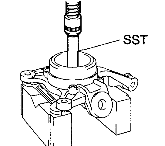

15. INSTALL FRONT AXLE HUB LH BEARING
a. Using SST and a press, install a new bearing to the steering knuckle.
SST 09950-60020 (09951-00680), 09950-70010 (09951-07100)

17. INSTALL FRONT AXLE HUB SUB-ASSY LH
a. Using SST and a press, install the axle hub.
SST 09608-32010, 09950-60020 (09951-00680), 09950-70010 (09951-07100)

18. INSTALL FRONT AXLE HUB LH HOLE SNAP RING
a. Using snap ring plier, install a new snap ring.

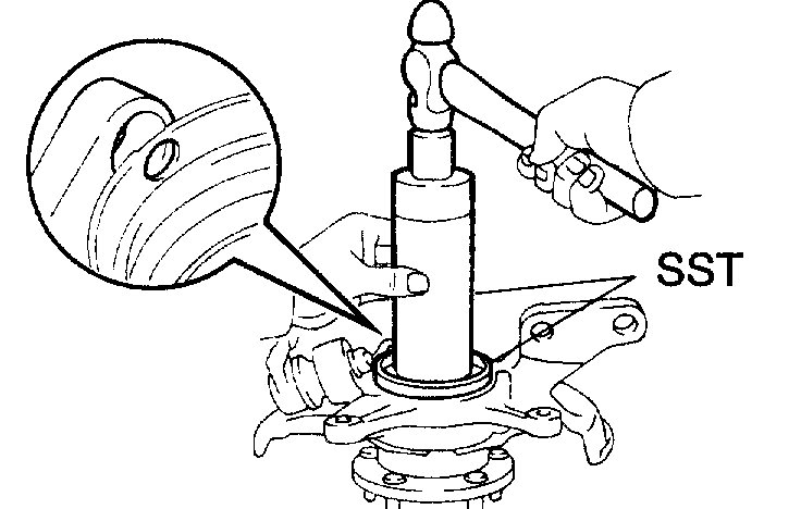

19. FRONT WHEEL BEARING DUST DEFLECTOR NO. 1 LH
a. Using SST and a hammer, install a new dust deflector.
SST 09316-60011 (09316-00011, 09316-00031), 09608-32010
HINT: Align the holes for the ABS speed sensor in the dust deflector with steering knuckle.

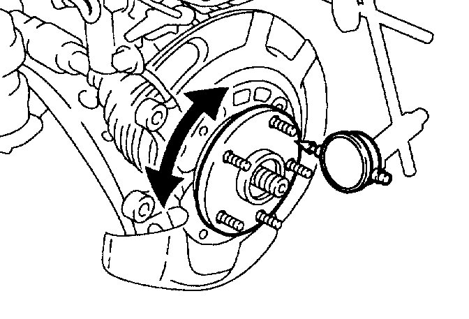

29. INSPECT BEARING BACKLASH
a. Using a dial indicator, check the backlash near the center of the axle hub.
Maximum: 0.05 mm (0.0020 inch)
If the backlash exceeds the maximum, replace the bearing.

30. INSPECT AXLE HUB DEVIATION
a. Using a dial indicator, check the deviation at the surface of the axle hub outside the hub bolt.
Maximum: 0.07 mm (0.0027 inch)
If the backlash exceeds the maximum, replace the axle hub.
