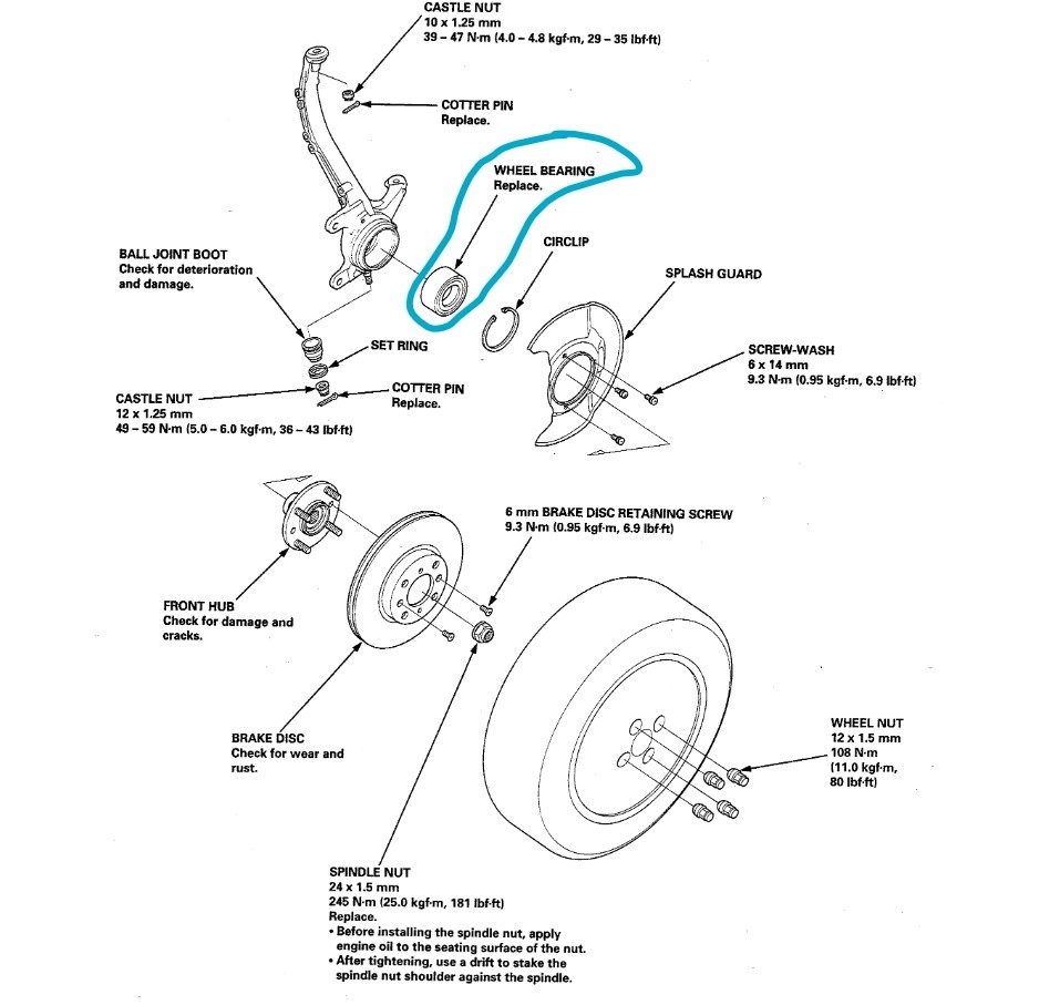

While the parts would fit it's very doubtful that you could get the hub and bearing apart without damaging the bearing. They are not a bolt together item on that car. There is a bearing and the hub. I have never had a bearing come out in one piece on them. You remove the wheel, brake caliper and rotor. Then you have to remove the retainer clip but usually you can't access it as the hub is in the way, then you remove the hub. 99% of the time that is done with a slide hammer. The inner bearing race generally fails, and you end up with a bad bearing. Then you remove the rest of the bearing from the knuckle and the race off the hub.

If you mean swapping over the entire knuckle that includes all of the parts in that image except the tire, you might be able to, but then you add in a lot more work and will need an alignment as well as chancing the damage to the bearing when you remove the axle from the hub itself. However, if you look at the bearing itself, you can buy them for about $30.00. Then you can get the tools used in the video at many parts stores as loaner tools and swap them out in less time than taking the suspension apart on 2 vehicles.
