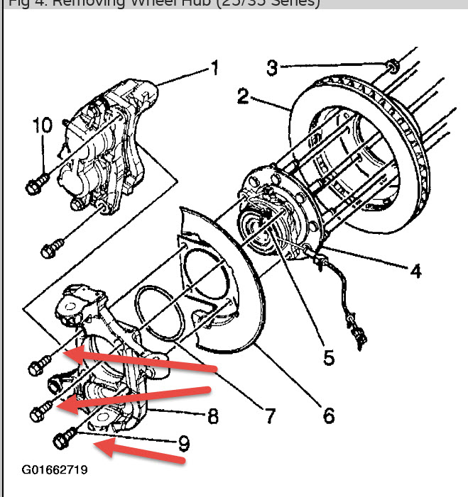

Wheel hub bearing assembly size socket needed.
Dec 22, 2016 at 12:03 PM
HMAC300
CERTIFIED EXPERT
48,601 POSTS
for the one to remove axle it is either a 34 or 36mm for the ones marked in picture are either 15mm or 18mm I forgot on the axle bolt.
