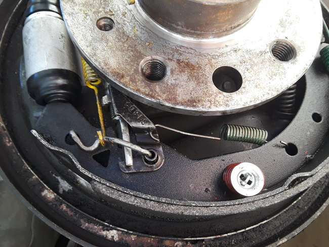

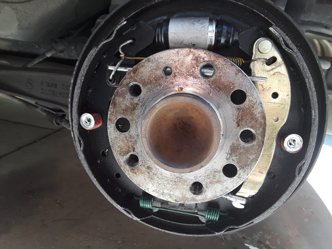

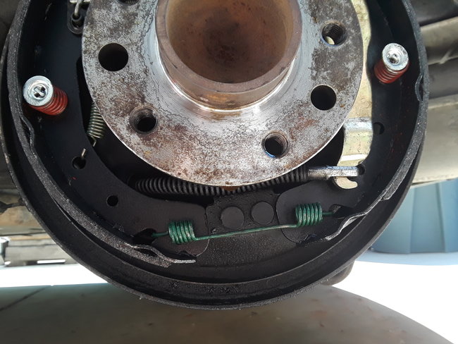

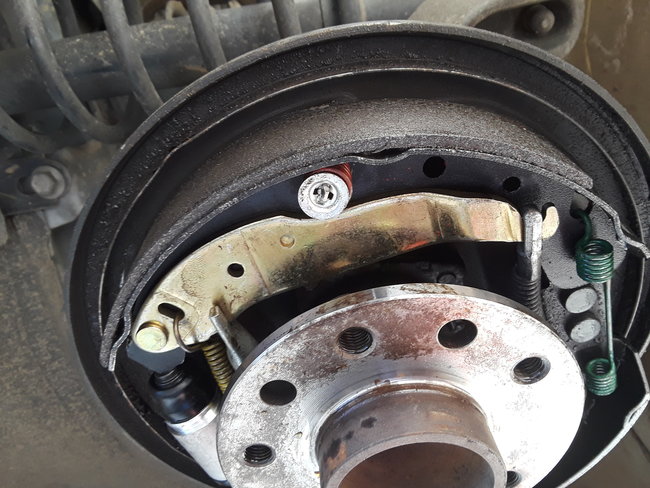

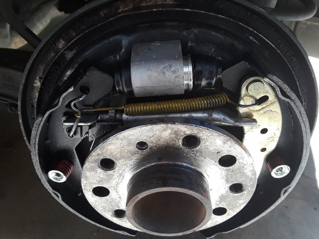

Here are the pictures and (wheel cylinder is fixed and double checked to make sure the seal is back to the way it should be):

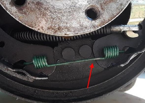

Dandy. How about we just give up and fix it? I expanded your middle photo. This is called a "non-servo brake", meaning the front and rear shoes work independently, one going forward, and the other when going rearward. Chrysler used that on the K-cars, and when the front ones wore out, you could switch them and get double the life out of them. Here they put the parking brake lever on them, but if those can be transferred and if the linings are the same length, you can do that too. The lining length is important to maintain balanced braking front-to-rear.
With "duo-servo brakes" the front shoe has a shorter lining and its only purpose is to grab the rotating drum and try to rotate with it. It pushes on the star wheel adjuster which pushes the bottom of the rear shoe into the drum. The wheel cylinder pushes the top of that shoe into the drum, so the rear shoe does all the stopping, and it has a longer lining. Two forces are acting on it.
With the non-servo brake, you have a fixed anchor at the bottom. The two shoes don't interact at all. In this case, if you look at my nifty red arrow, you'll see the shoe is in front of that anchor. It should look the same as the front shoe. This will let the rear shoe rotate too far away from the wheel cylinder. I promise you are not the first person to do this. Every brake system specialist has done something like this. Some just admit and some don't. I'm surprised you were able to get the drum on without that shoe rubbing on it.

Thanks for the help and all the information you shared it was interesting and I learned a few things so thanks again. I'm heading to the car now to see how this goes, I'll let you know what happens and hopefully it's all good news.
Apr 7, 2019 at 9:12 AM
JULIANV
  • 4 POSTS
Thank your for all the help it was a great success and learning experience. thanks I appreciate it.

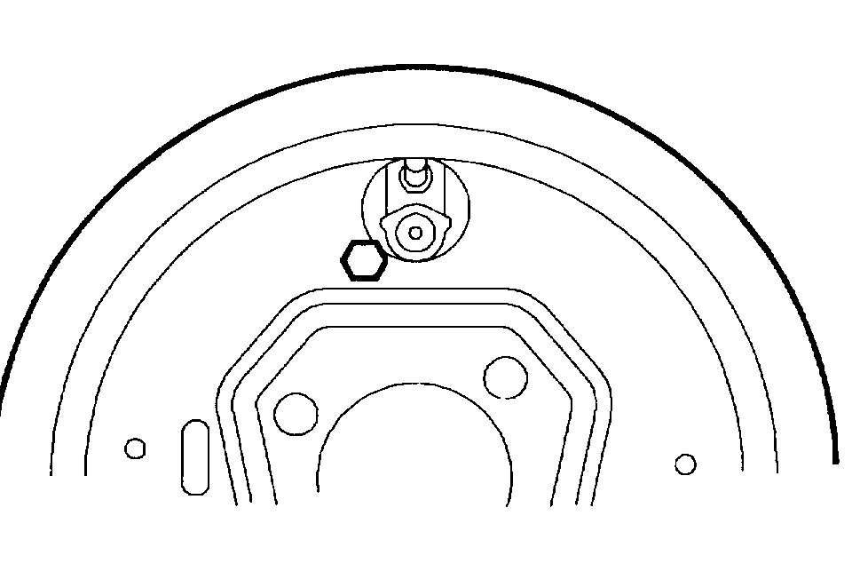

Started on the driver side replacing the wheel cylinder. haven't looked at the other side yet because of this bolt.. Please tell me i don't have to remove or loosen the 4 nuts holding the hub on just to get room to the retainer bolt...
Oct 7, 2020 at 12:14 PM (Merged)

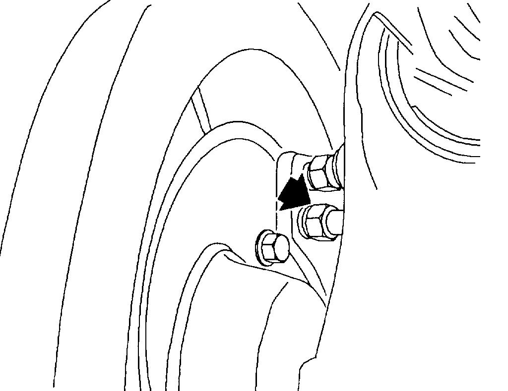

I'm not sure exactly what you are referring to. Here are the directions for removal and replacement and nothing indicates removal of the hub. The two attached pics correlate with the directions.

pic 1
3. Disconnect brake pipe at rear wheel cylinder. Plug open brake pipes to prevent brake fluid loss and contamination.
4. Disassemble rear drum brake assembly.
5. Remove wheel cylinder fastener and remove wheel cylinder.
INSTALLATION
pic 2
1. Install new wheel cylinder onto backing plate with fastener.
Torque: Wheel Cylinder-to-Backing Plate Bolt: 9 Nm (80 inch lbs.)
