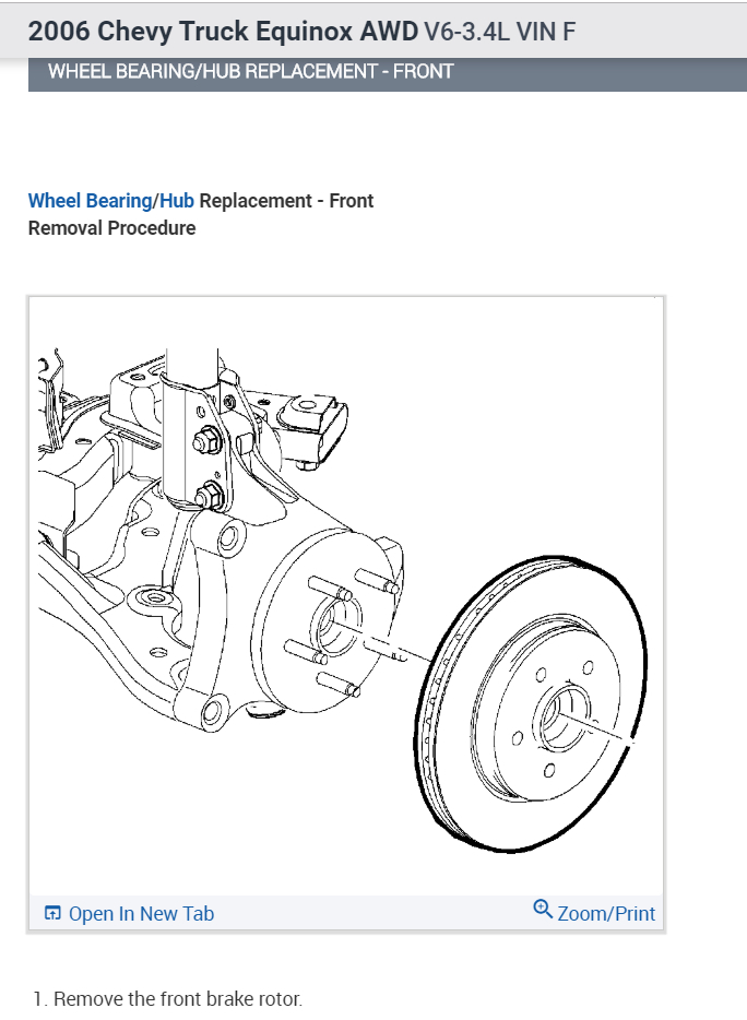

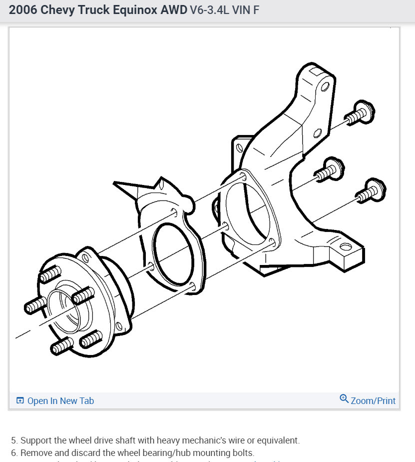

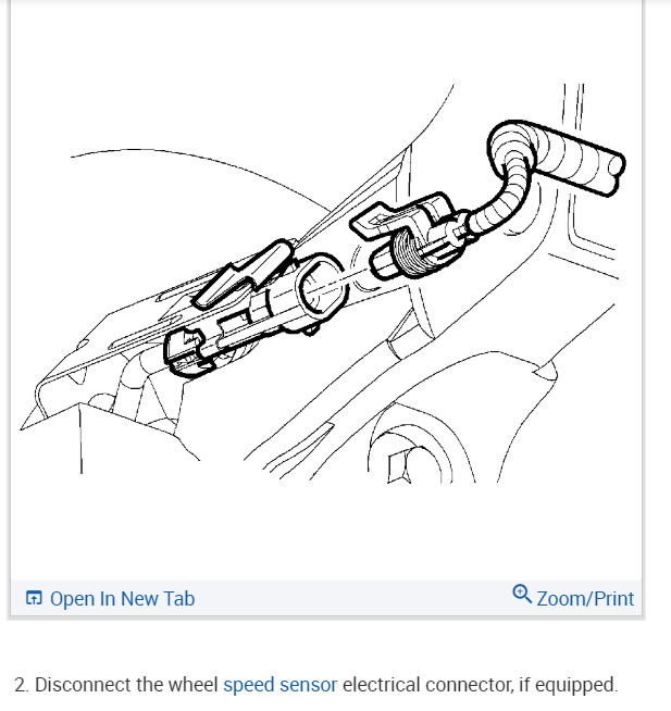

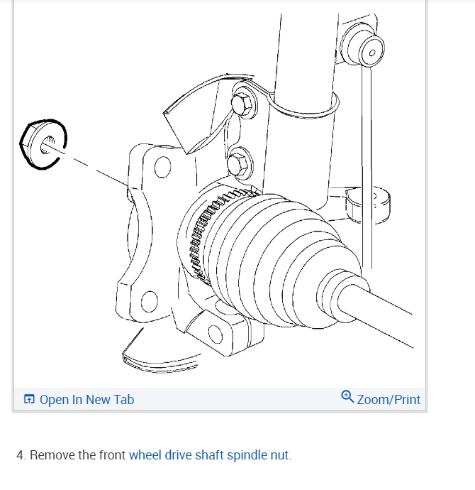

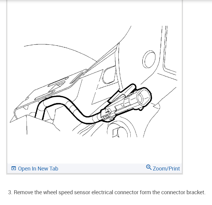

Here is how the job is done correctly in the diagrams below. Please let us know if you need anything else to get the problem fixed.
