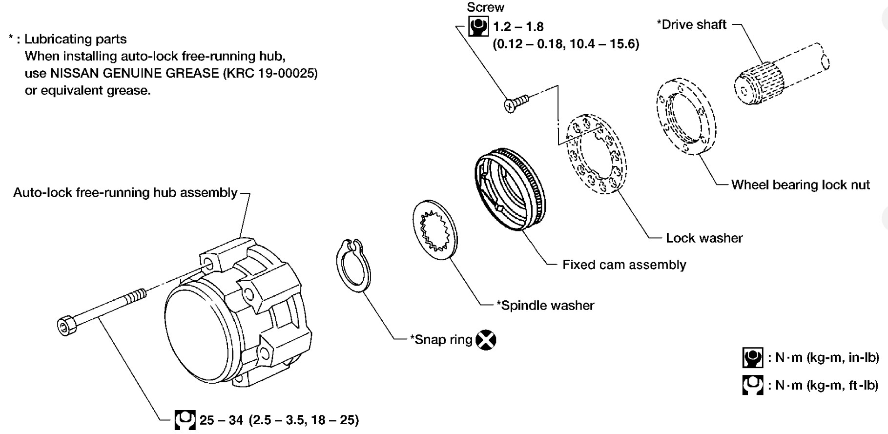

I was told my wheel bearing needed to be replaced. For my model it did not come assembled so I've had to assemble it myself. Once I put it all back on to test drive it keeps making a clicking noise or like you put a card on the spokes of a wheel and my automatic locking hub busted but I still have the center cap. What is causing the issue or what am I doing wrong?
