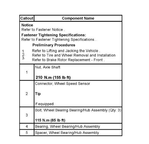

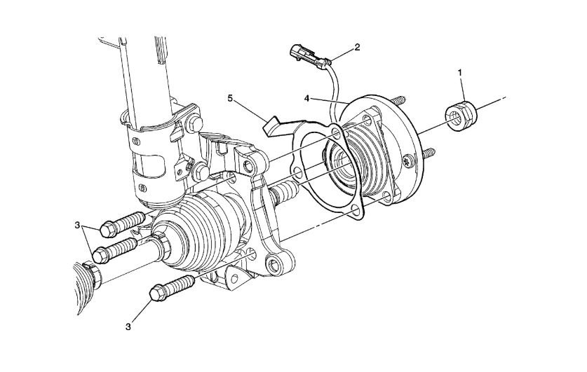

Can you remove your hub assembly without a three jaw puller?

Yes you can. They recommend using it to push the axle stub through the hub but in most cases, you can push them out using a rubber mallet.
Could you verify your year and model? Is it US?
There should be attaching bolts behind the hub to release it from the spindle as well.
https://www.2carpros.com/articles/bearing-hub-replacement

Okay, that is better.
I attached the procedure and picture for you to view.
The simple answer is no, you do not need the puller. Just a rubber mallet to release the axle shaft.
