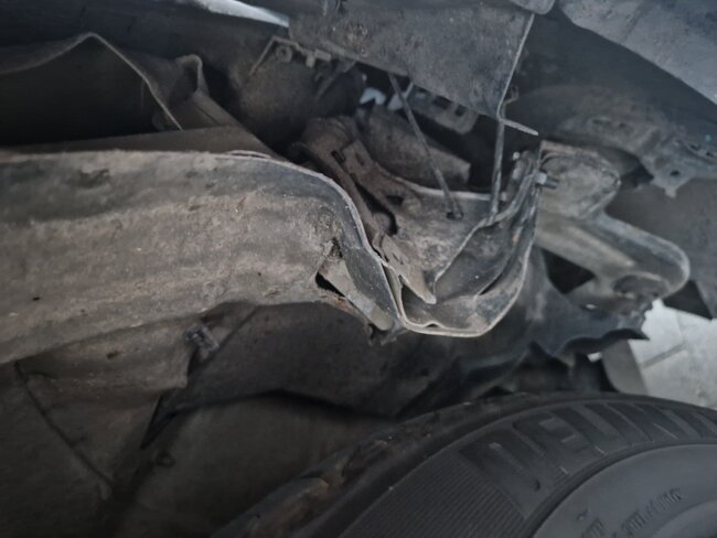

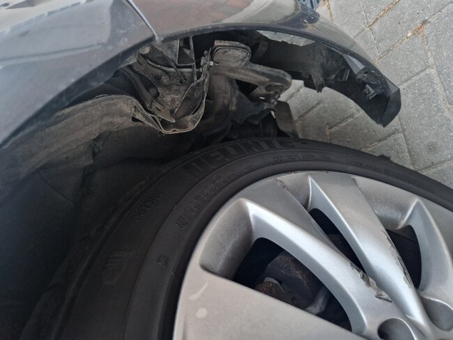

From the images it doesn't look like it was hardly repaired at all. It looks like they removed the damaged parts, stuck other better parts over the damage and called it done. From the images it looks like the upper frame rail for the front end is damaged as well as the support structure. If it were me, I would be looking into returning the vehicle and getting the money back. If there is any form of warranty, I would use it and possibly the law to get out of that vehicle. Price wise it's hard to say as I'm in the US but here that would be a 3–4-thousand-dollar repair at least, could go higher depending on what can be repaired versus replaced. It looks like the front bumper support is damaged the upper frame rail, the core support and that there is nothing supporting the bumper cover on that side but luck.
Sorry to be the bearer of bad news but that will be an expensive repair to have done correctly. I would also suspect things like the air bags and seat belts will need to be checked to see if they were actually replaced if they deployed.
