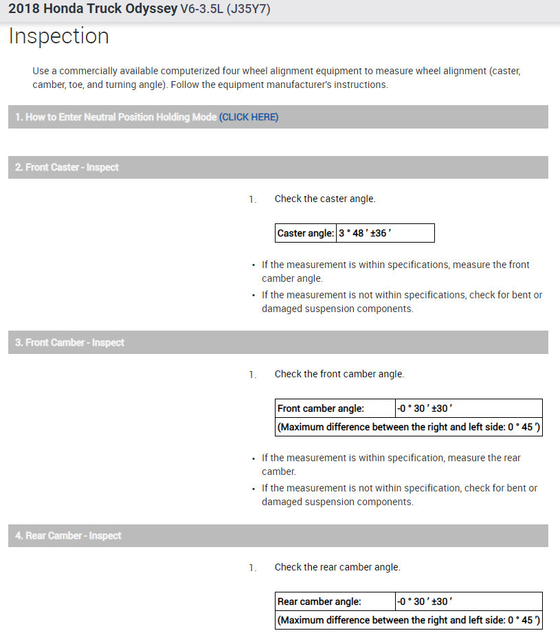

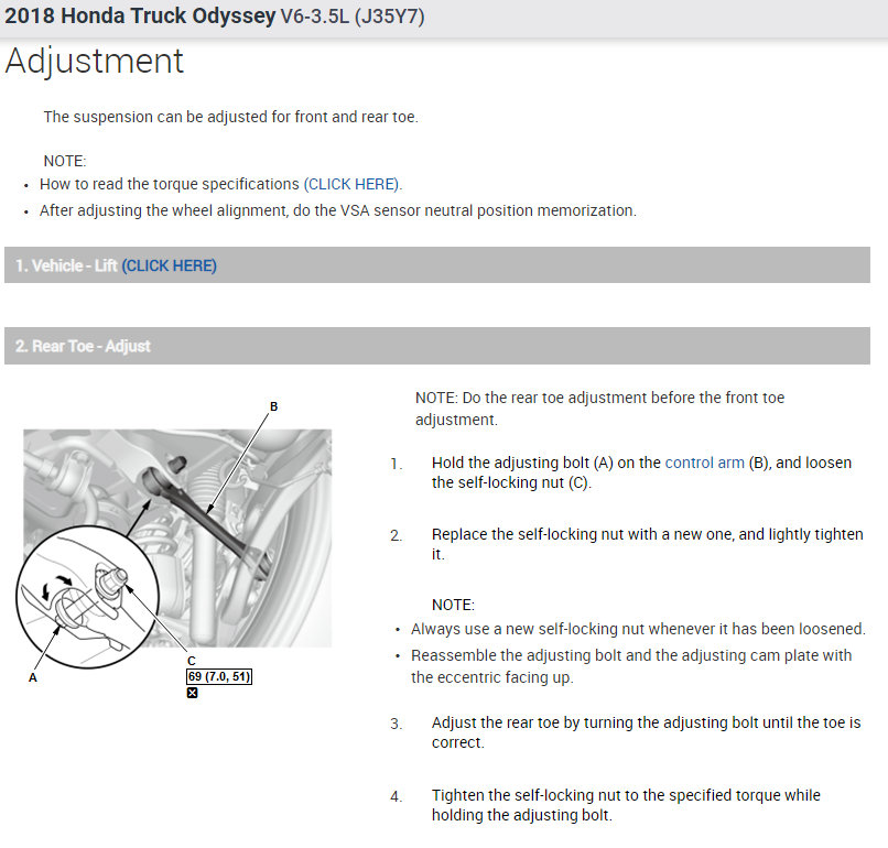

My brother bought the van listed above 2018/2019 3.6V6 EX-L after an accident. I need to know the alignment specifications as well as complete alignment procedures.
It is the van from USA and my service do not have this car in option car which can choose (I don't know how it explain in English). He needs to know all technical data which relates to wheel alignment - degree, mm, tilt angle, wheel alignment 0 or - or + (how many mm). I don't know how it all name, but it should be data values from. Mm or degree to. Mm or degree.
