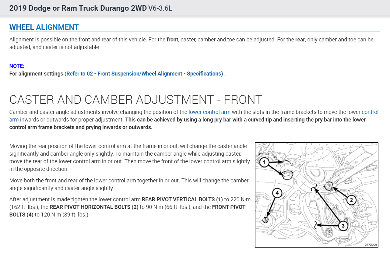

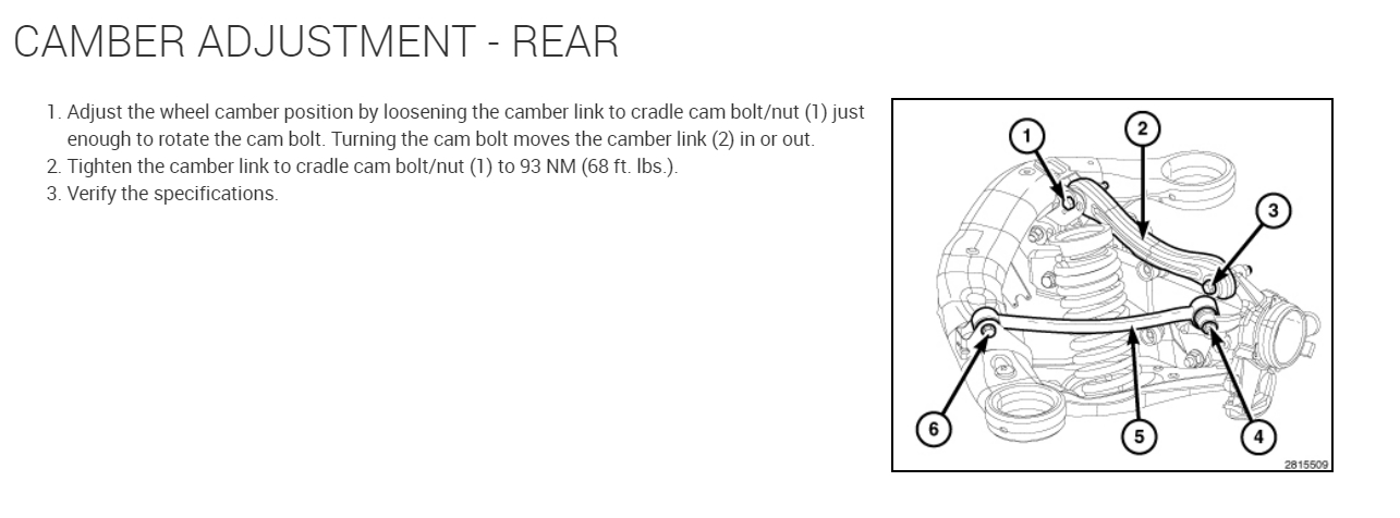

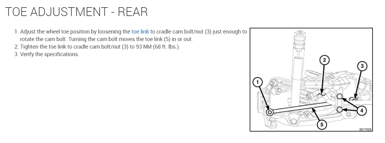

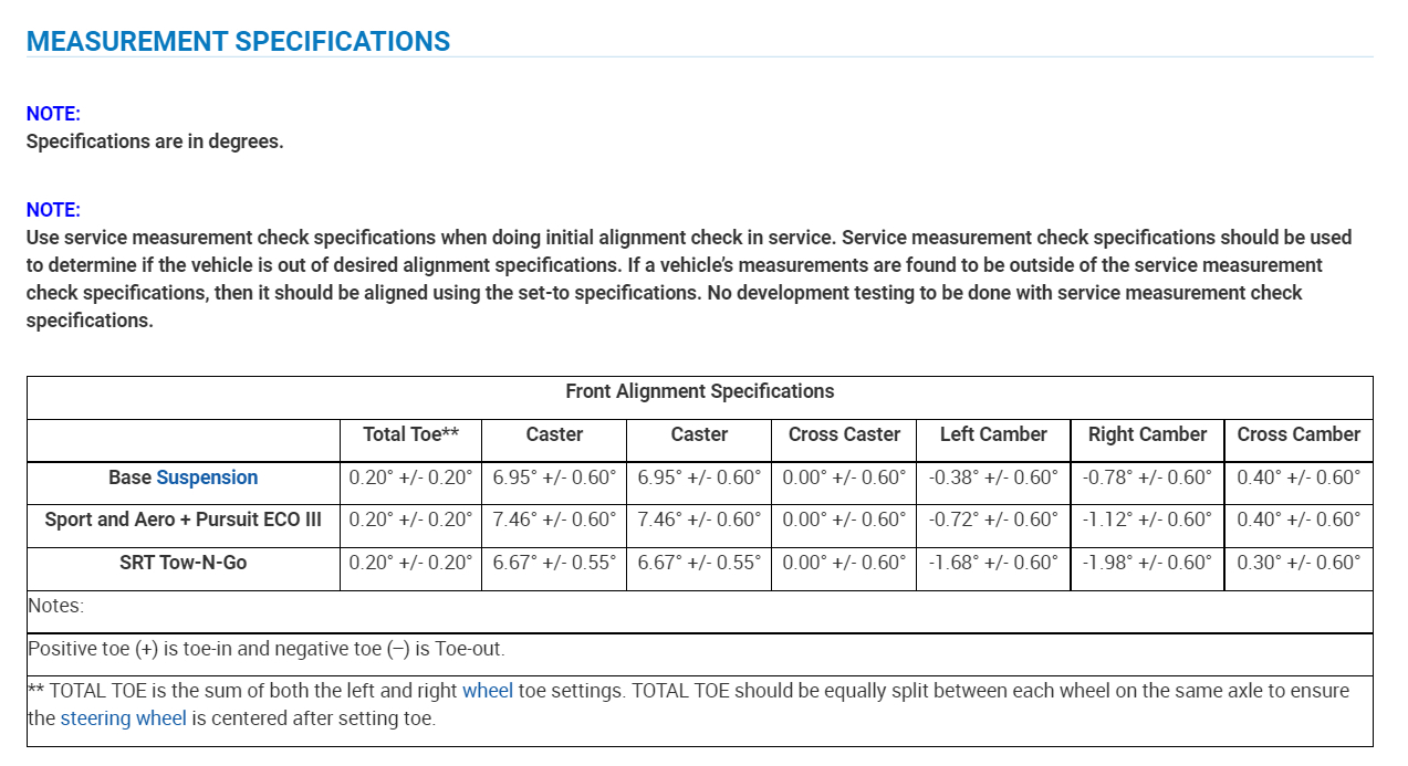

I am asking about the alignment procedures and specifications for my car.
I would like to know all technical data which relates to wheel alignment - degree, mm, tilt angle, wheel alignment 0 or - or + (how many mm). I don't know how it all name, but it should be data values from mm or degree to mm or degree.
