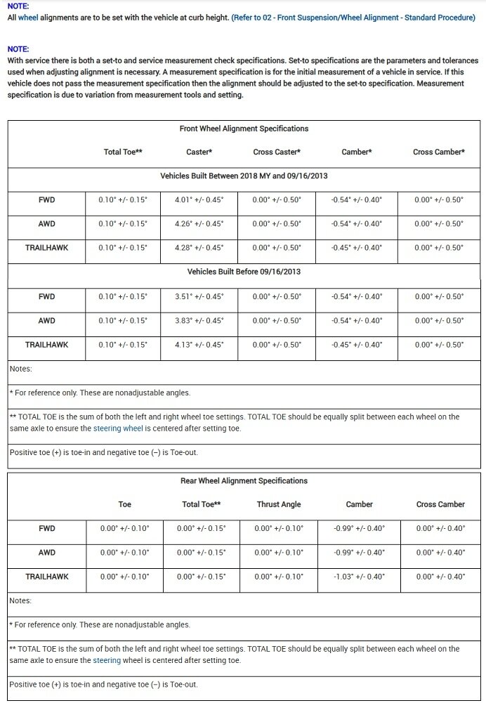

Can you please tell me the wheel alignment specs rear and front for the car.

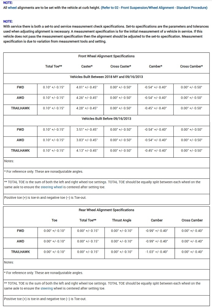

Here's for the 4wd model. If this comes out too small to read, try to copy and paste it into a typing program where it can be expanded. I use MS Word, but there are other free versions that work just as well. Let me know if you need help.

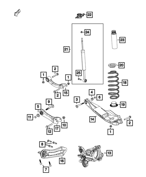

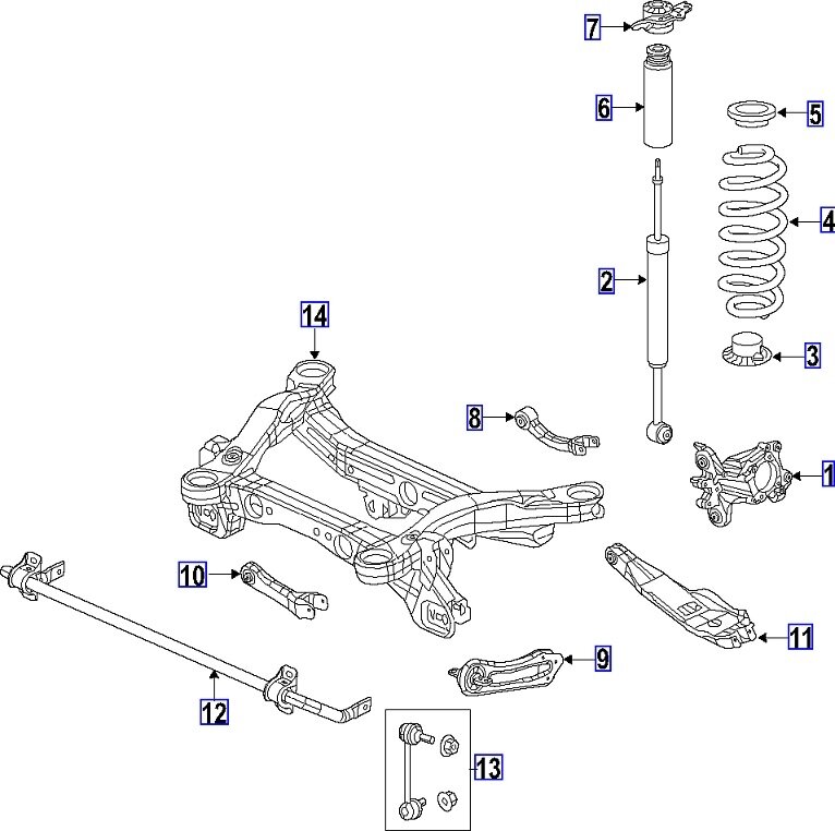

is it everything in the table in degrees? I am focusing on adjusting the rear wheels first. so which link is for camber? And which link is for toe? when I checked the car only the spring link # 14 in the pic and the front lower link #17 in pic that have adjustable bolts in them. the top link #15 in pic has no adjustable bolt.

Yes. They show everything in degrees. I always set my computers up to read toe in inches. As I recall, if you take toe in degrees and cut it in half, that will be close to toe in inches, so 0.10 degrees total toe is the same as 0.06 inches, which was a common value for front-wheel-drive vehicles.
When I entered numbers manually, I could enter them in degrees, then the computer would convert them automatically if I switched to inches.
Are you able to read the numbers in the photo?

So which link is for camber? And which link is for toe? When I checked the car only the spring link # 14 in the pic and the front lower link #17 in pic that have adjustable bolts in them. The top link #15 in pic has no adjustable bolt. Yes i am able to read the numbers. please see picture

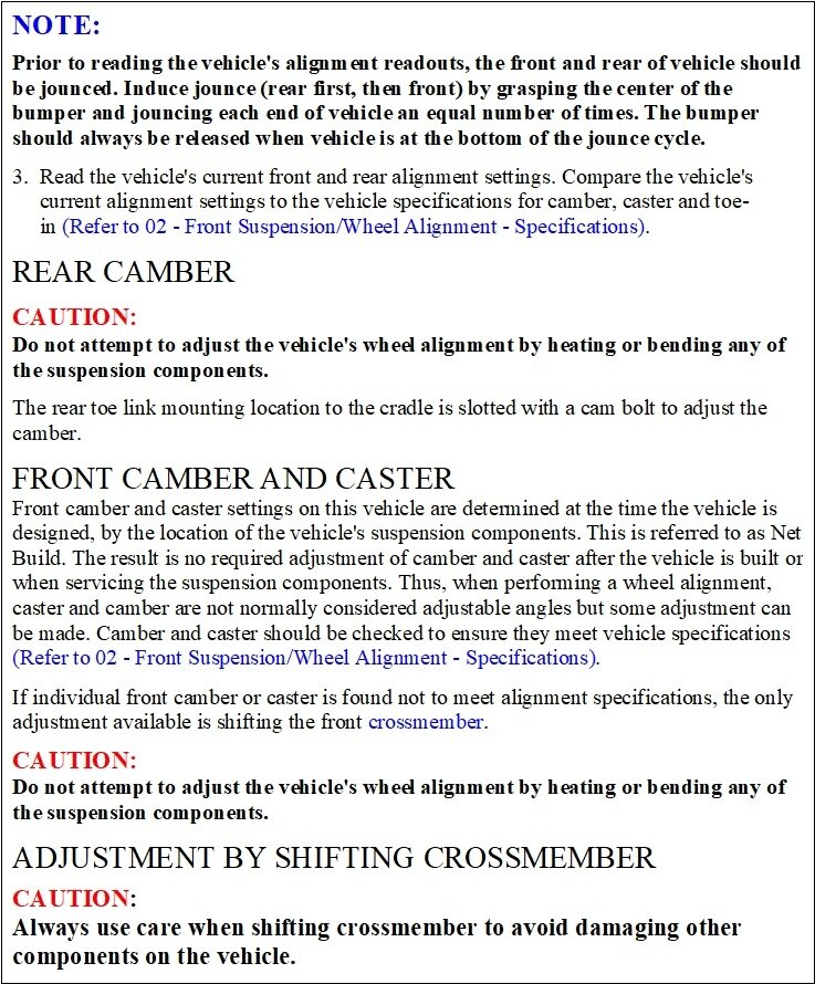

It looks to me like you're going to have to jockey both of them to set both camber and toe. They list separate items, but they're going to interact.
I see the cam bolts, numbers 3 and 9, on your exploded view. Those correspond to the parts you mentioned.

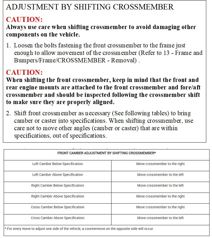

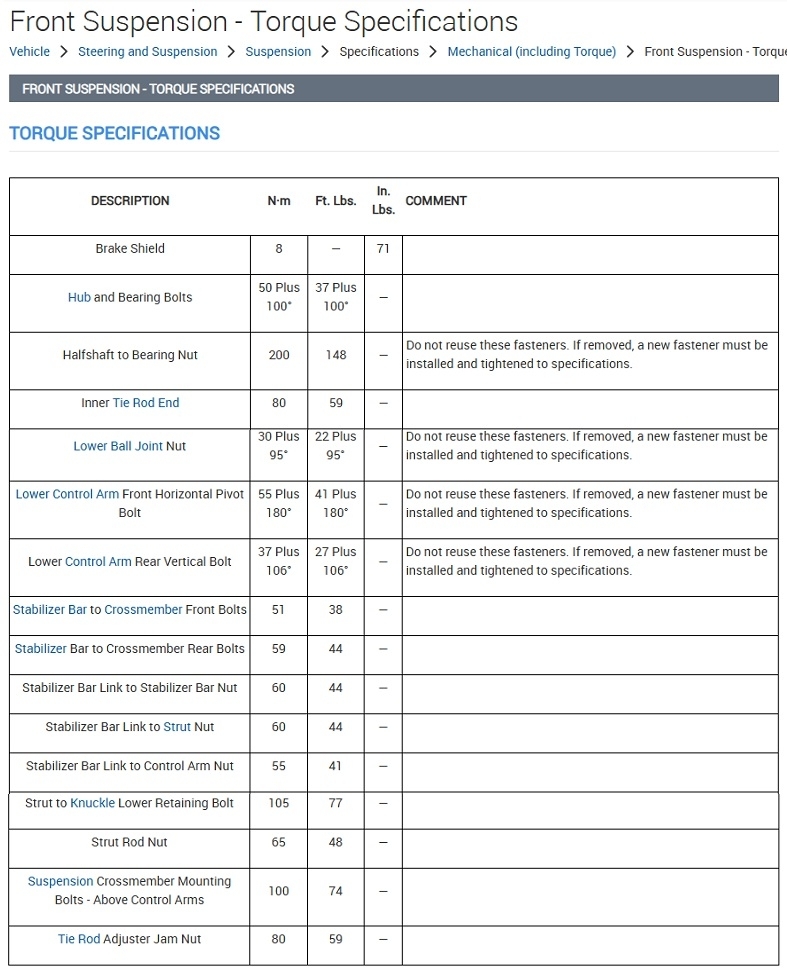

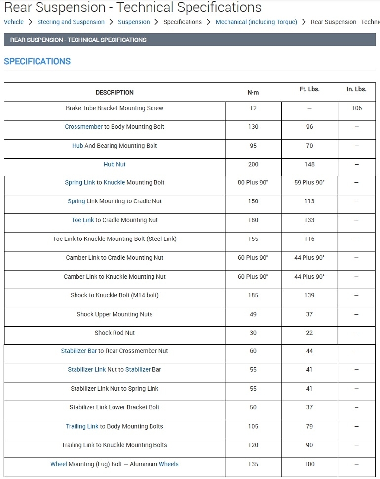

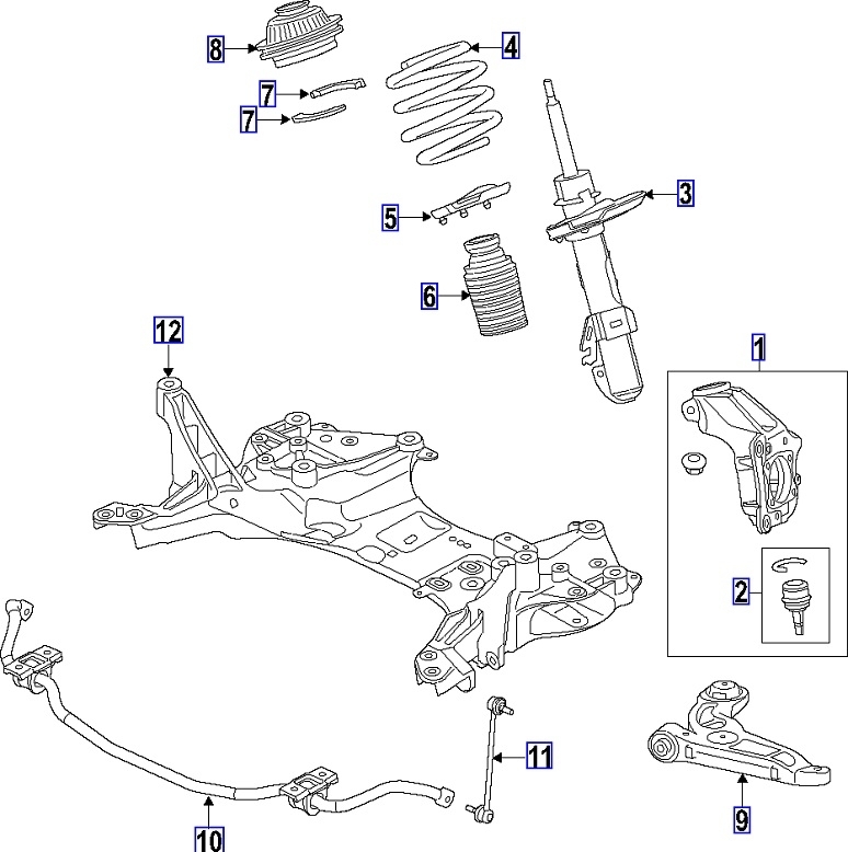

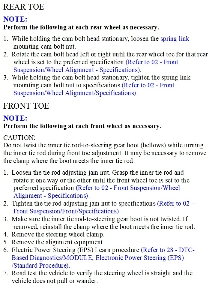

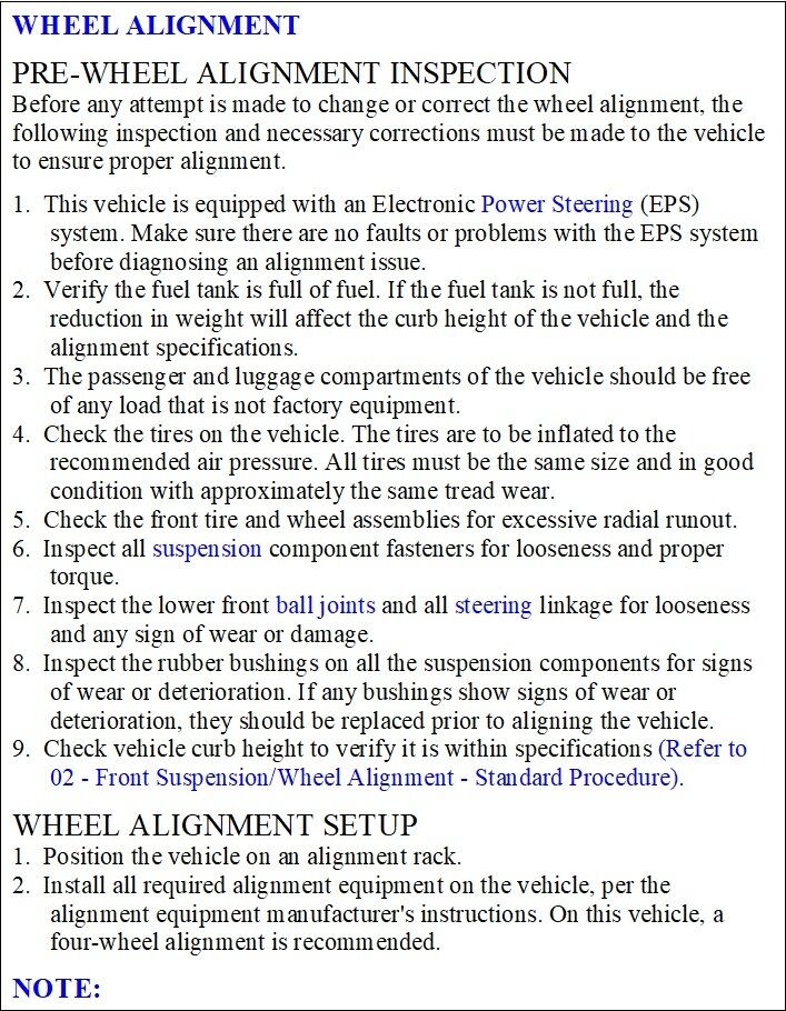

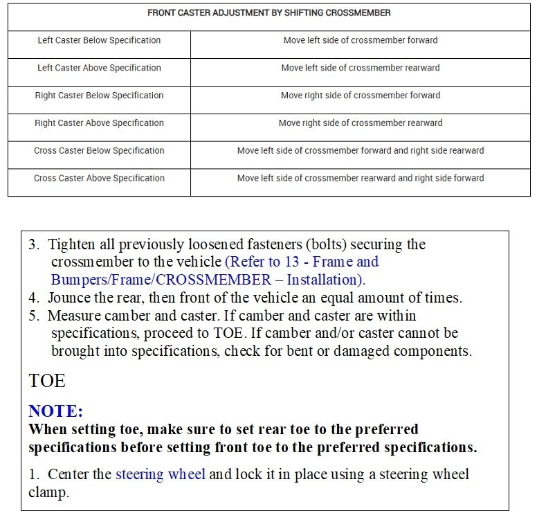

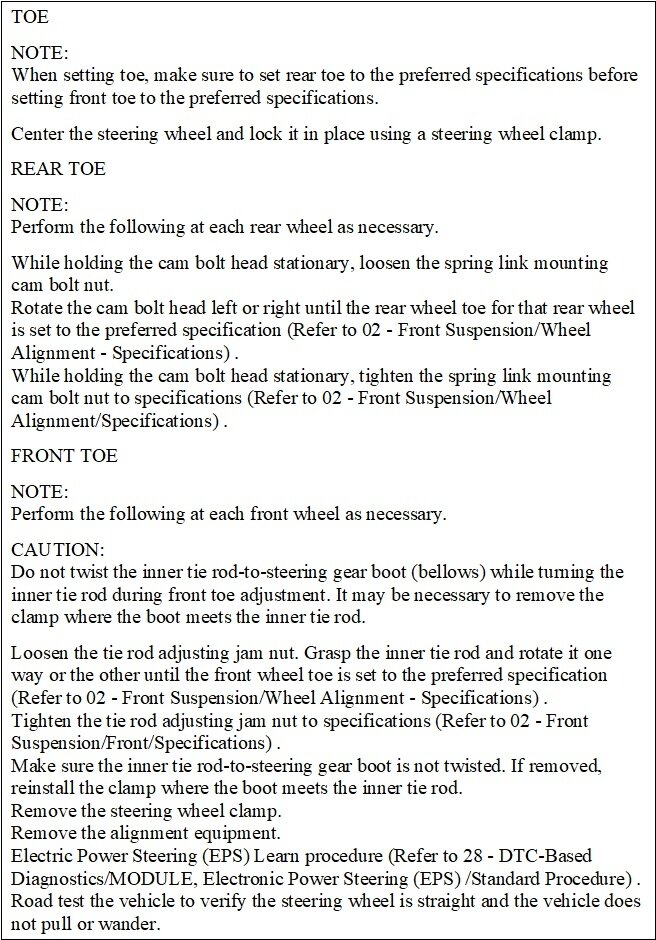

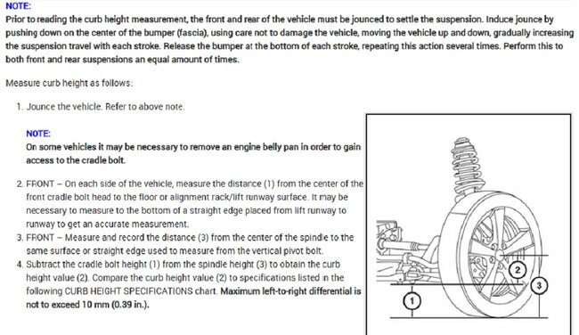

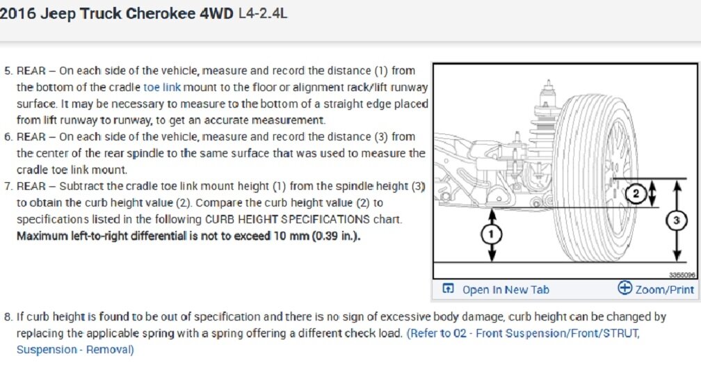

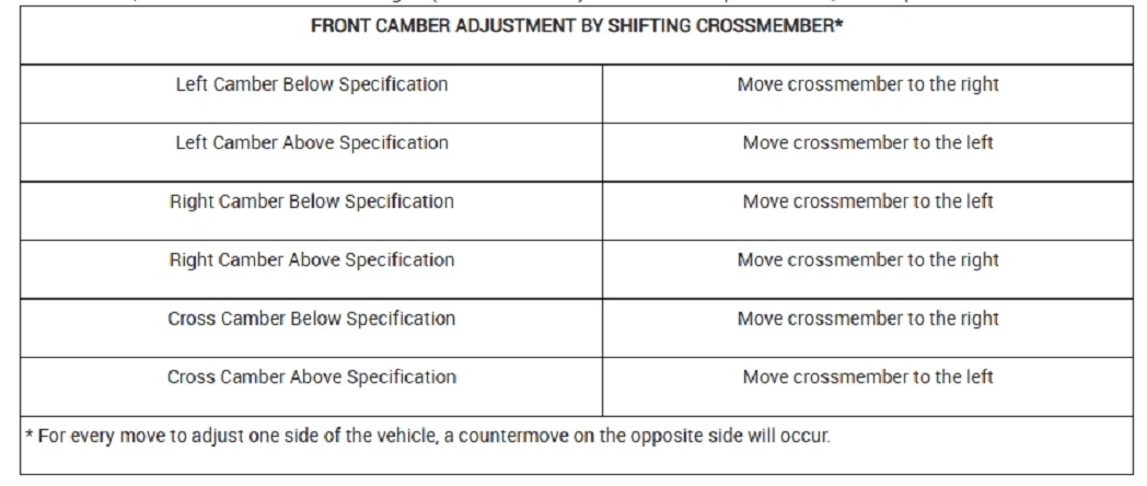

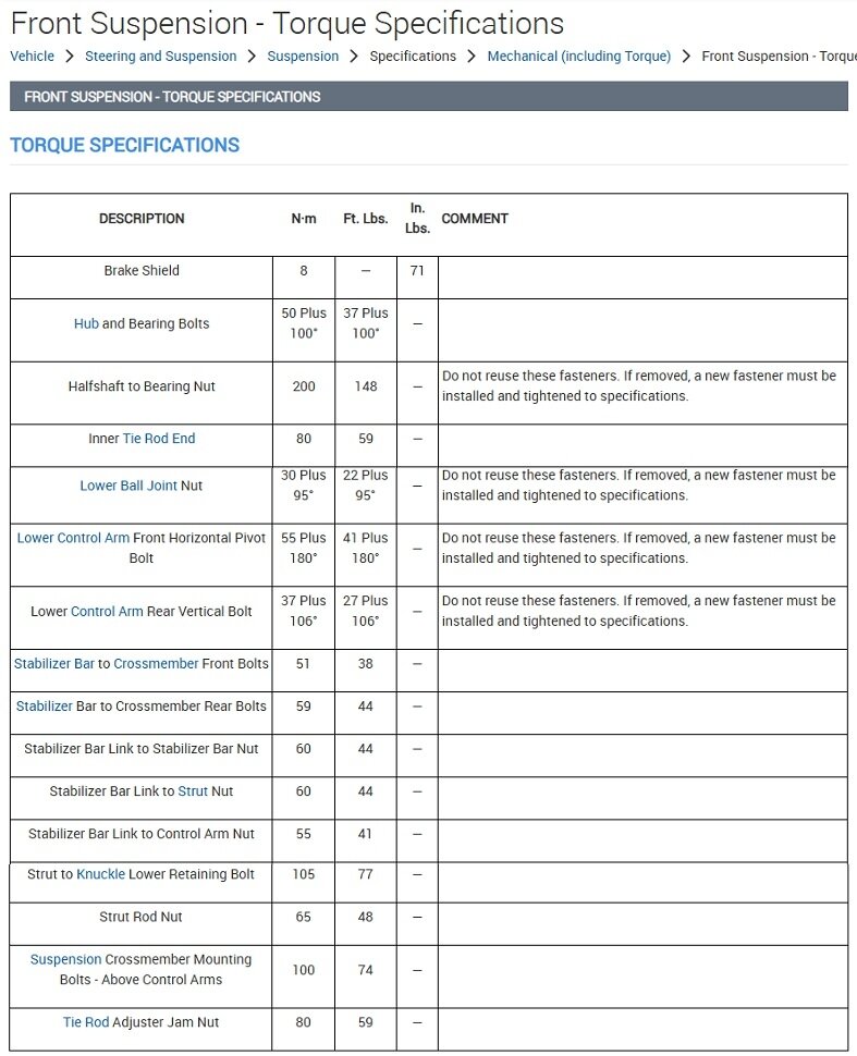

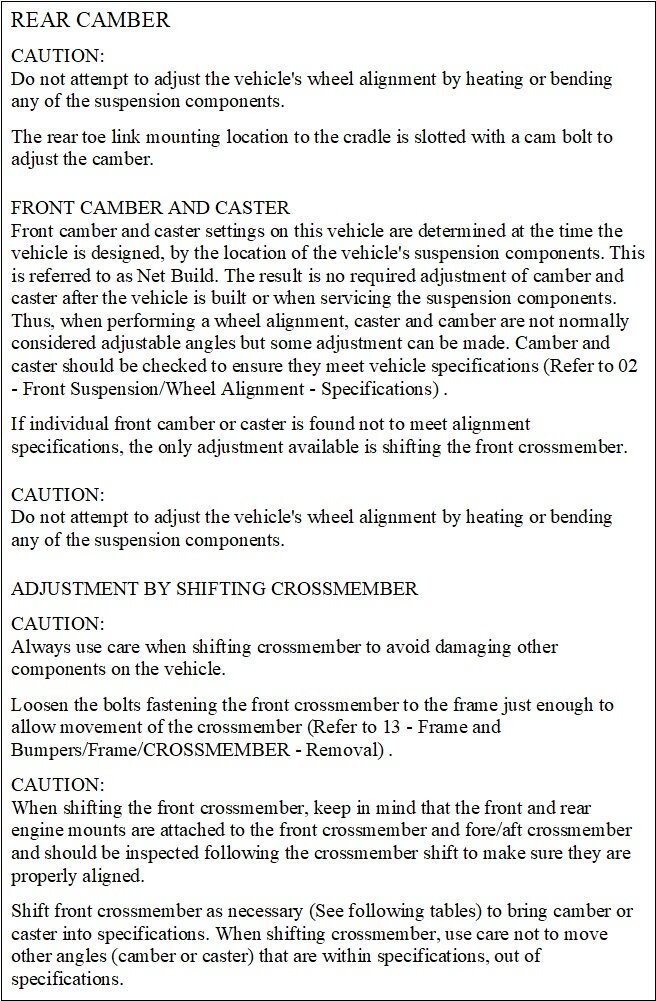

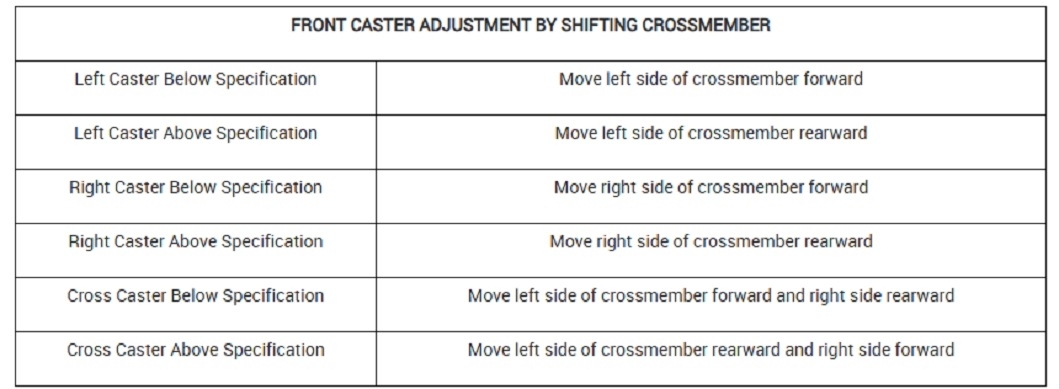

Here's what I put together. The first seven images are the alignment procedures. Next is the specs. I hope you can make them readable. If not, I'll cut them up so the parts can be expanded. Next two are the suspension exploded views, in case you need them. The last two are the front and rear torque specs.

so, what I read is that to adjust rear CAMBER I have to loosen and adjust the cam bolt on the TOE link. and to adjust the rear TOE I have to loosen and adjust the cam bolt on the SPRING link. is my understanding correct?
so why they called it toe link and it's used to adjust camber? weird
Dec 9, 2025 at 1:54 PM
CARADIODOC
  • 34,306 POSTS
It's due to the geometric relationship of the control arms, how high up they are and how long they are. When you move any one of them, you're going to see both camber and toe change. It can be frustrating at first, but you have to jockey them around until you give up and say, (under your breath), "that's good enough".
You probably know this, but you need to have slip plates under the rear tires so they can move around freely as you make the adjustments. Some old drive-on hoists don't have provisions for making adjustments on the rear. If those plates have accumulated rust or dirt making them bind, some of what you adjust gets bound up in the suspension bushings, then the settings are all wrong once the vehicle is driving down the road.

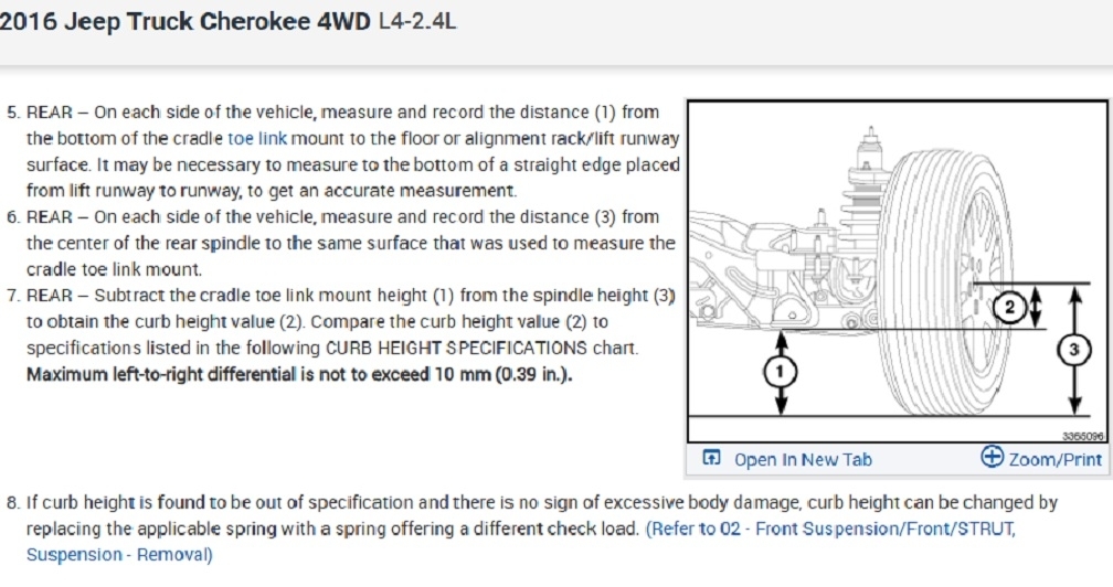

You can continue this conversation with any other questions if they're related to this topic, but for new questions, we do ask you to start a new one. That's because these get categorized by topic and by model to make it possible for others to research a similar problem without writing their own post. Also, once you get the first reply, it becomes a private conversation between the two of us, unlike in other forums where anyone can jump in and confuse the issue. As such, when you ask a new question, one of the other experts might be much more qualified to answer, but he won't ever see your new question. By posting a new one, everyone gets the chance to reply. Often we will ignore a question because we know someone else is the better person to reply.

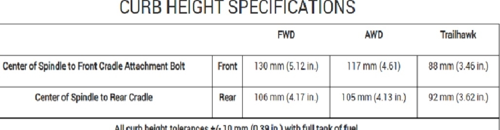

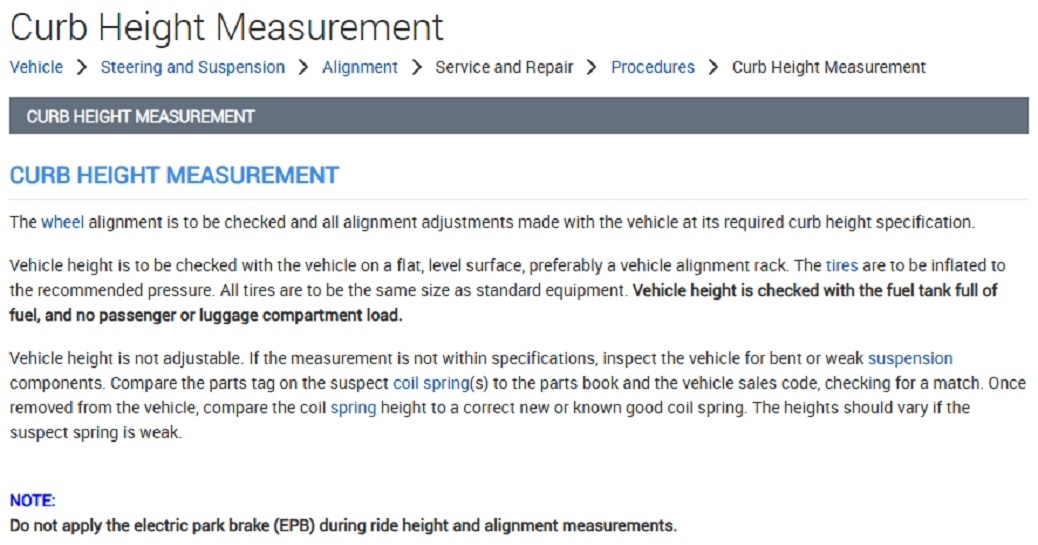

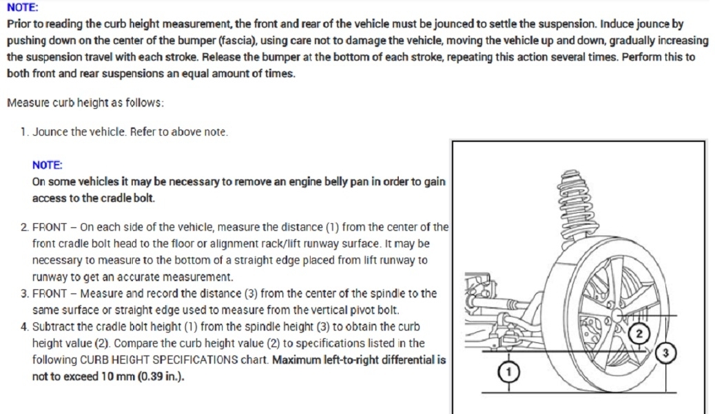

As for those bolts, welcome to my world. I live in Wisconsin where they throw a pound of salt onto an ounce of snow. One thing I didn't mention earlier is chassis ride height. Check that first. If it has sagged, the geometric relationship of the suspension parts will be all wrong. The wheels will go through the wrong motions as the vehicle bounces up and down, so there will be horrid tire wear even though the numbers on the alignment computer are perfect. Very often correcting ride height eliminates the need to make alignment adjustments. As an example, while working for a very nice Chrysler dealership in the 1990s, a lot of Dakotas came in with pulling and tire wear problems. In probably 80 percent of those, I found the right front to be very low, and of course, camber was way off on both front wheels. Simply cranking up the right torsion bar brought everything back, and no other adjustments were needed. For some reason, that sag only happened once per truck, and always on the right side.
On most models, ride height is corrected by replacing weak / aged coil springs. When you do have torsion bars, they interact from side to side. When you raise one corner up one inch with its torsion bar, the other side of the vehicle will go up about a half inch. Always start with the lowest side, then you may have to do nothing to the other side.
Ride height has less detrimental effect on small front-wheel-drive cars with strut suspension in the front, but the three-link systems need correct ride height to keep that geometric relationship to keep the wheel in alignment while it's bouncing down the road.

One thing I forgot to mention is the procedure for checking ride height. It looks complicated, but Chrysler has done it this way since at least the 1970s. Imagine if the height adjustments were perfect, then you drive all four tires up onto pieces of 2"x6" lumber. Most manufacturers have you measure from one specified point, often on the bumper or to a side marker light. By driving onto pieces of lumber, every measuring point will be 1 1/2" too high, yet nothing has changed the geometric relationship of the suspension parts. Chassis ride height hadn't changed. The same error occurs when you switch to an optional tire size. Now you have to know that was done, and you have to correct for that. With Chrysler's method of taking two readings and calculating the different, tire size doesn't matter. You're ending up with the correct reading that gives the correct geometric relationship of the steering and suspension systems
