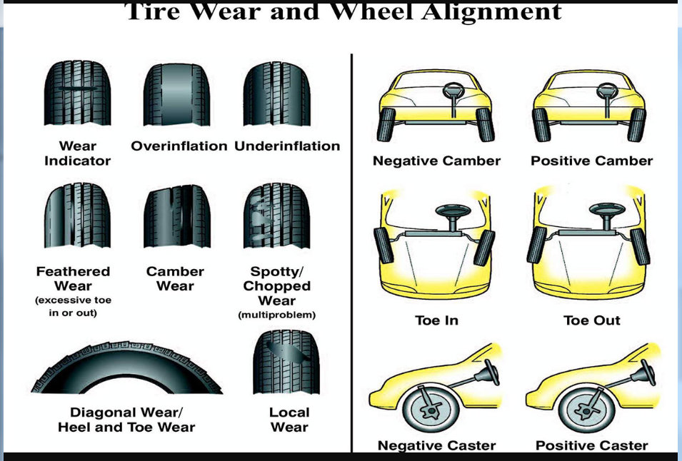

Also we need to check for wear using this guide and the chart attached below:
https://www.2carpros.com/articles/how-car-tires-work
If that doesn't work then possibly alignment out of specific. You would need to take it to a shop for that as they would need to use an alignment machine.
