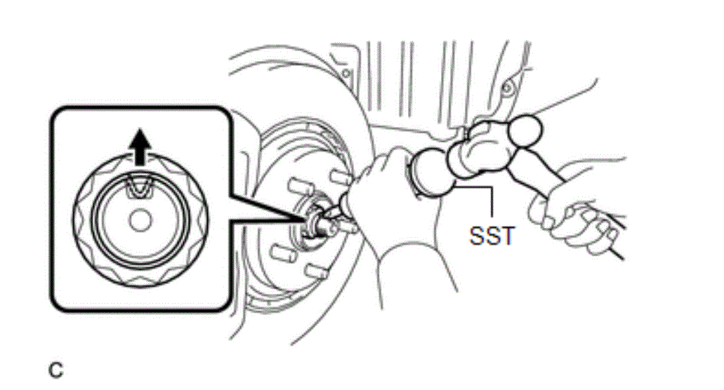

REMOVE FRONT AXLE SHAFT NUT
Using SST and a hammer, release the staked part of the front axle shaft nut.
SST : 09930-00010
NOTICE:
Loosen the staked part of the front axle shaft nut completely, otherwise the threads of the drive shaft may be damaged.
While applying the brakes, remove the front axle shaft nut.

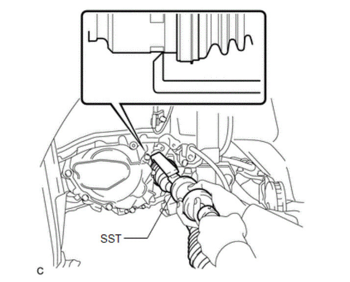

SEPARATE FRONT DRIVE SHAFT ASSEMBLY
Click here [ AXLE AND DIFFERENTIAL: FRONT AXLE HUB: REMOVAL+ ]
REMOVE FRONT DRIVE SHAFT ASSEMBLY LH
Using SST, remove the front drive shaft assembly LH.
