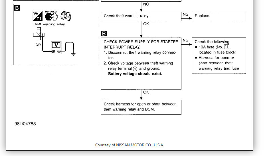

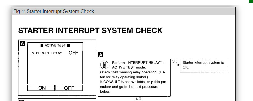

Okay, so in the diagrams down below I have included what the vehicle manufacturer says to do when this situation arises. If your vehicle is at a shop maybe you can take this guide and give it to your mechanic and see what he can do with it? I hope this helps. Please get back to us with how everything turns out.
Thanks,
Alex
