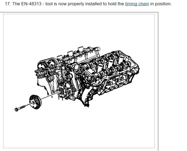

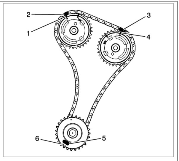

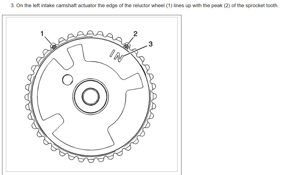

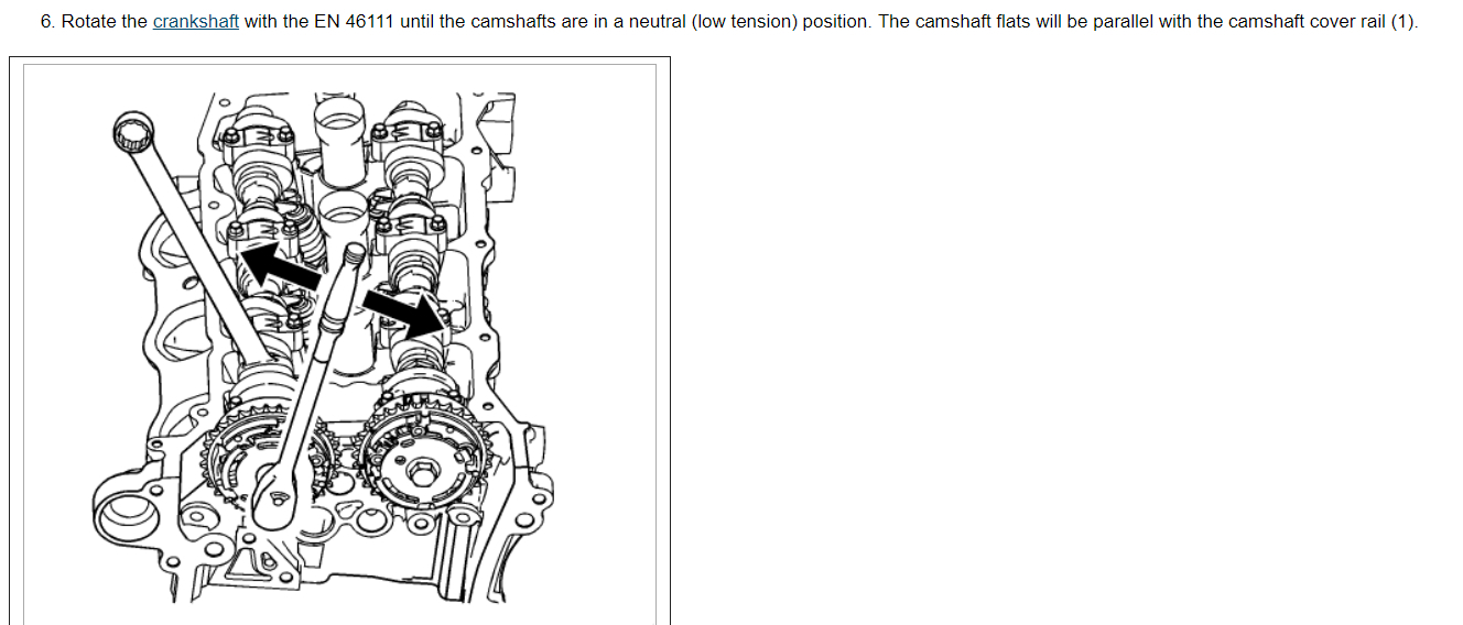

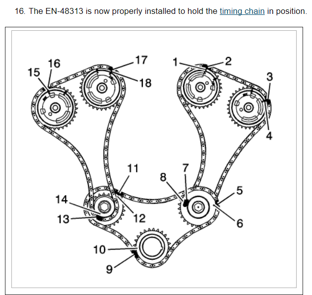

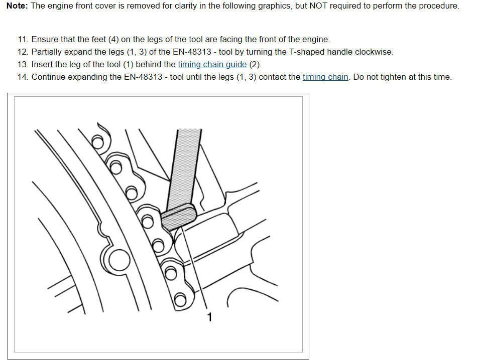

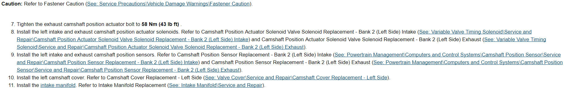

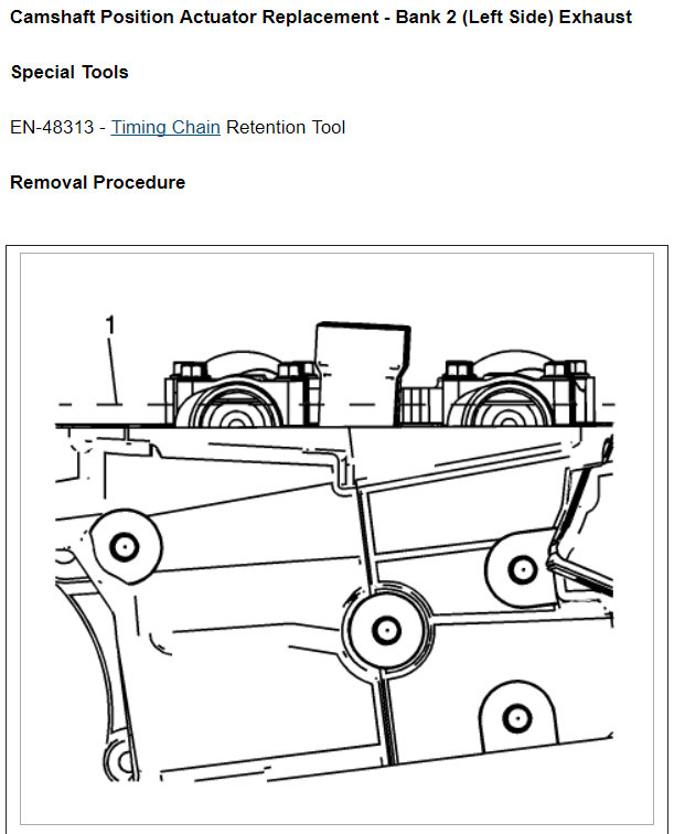

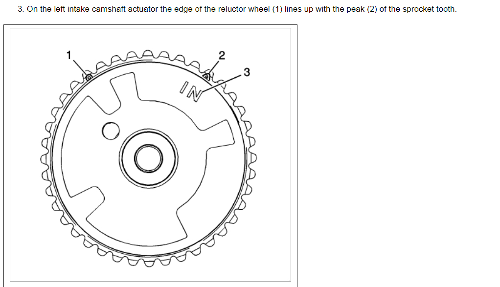

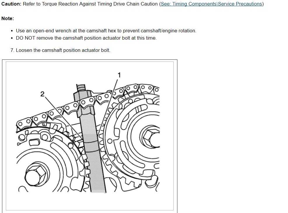

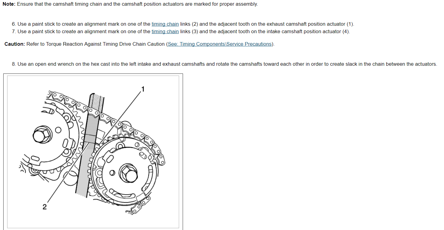

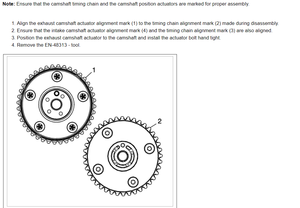

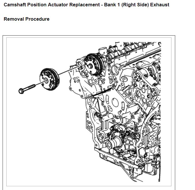

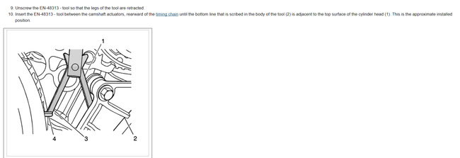

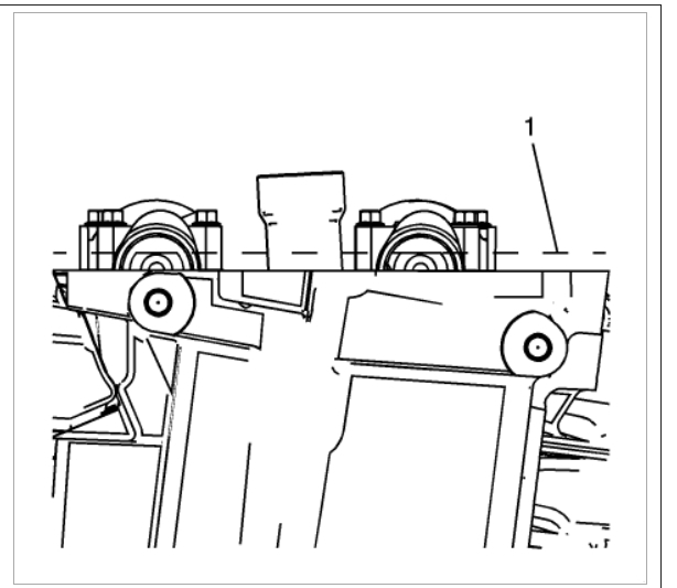

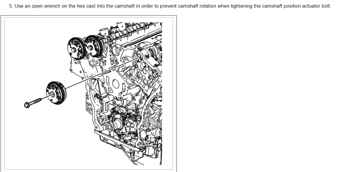

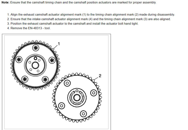

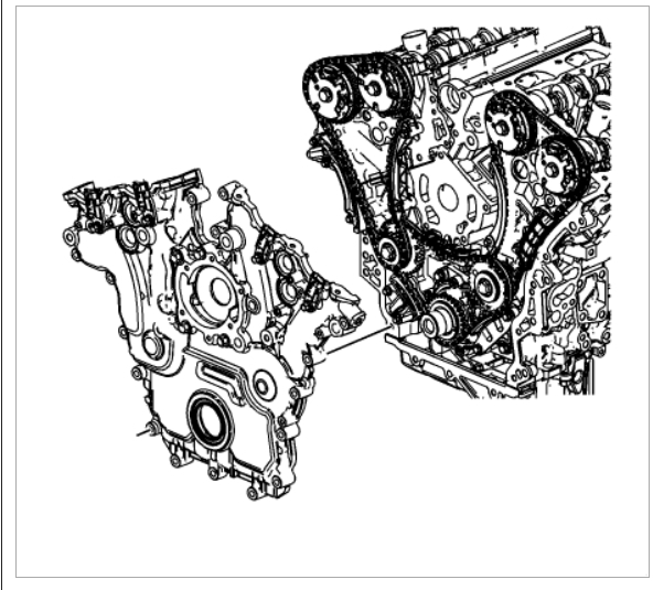

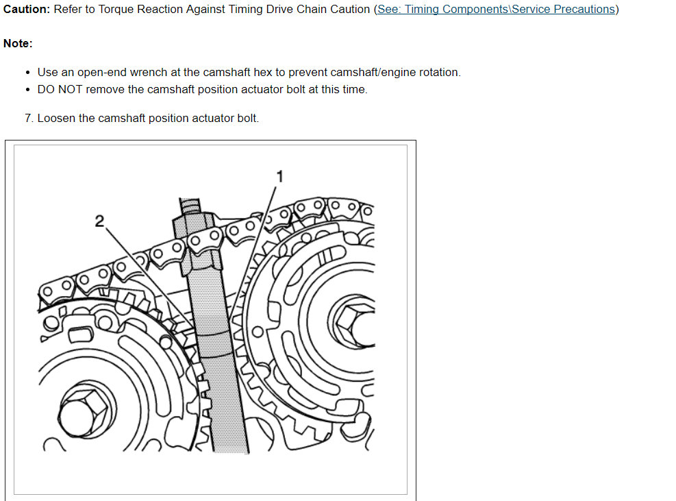

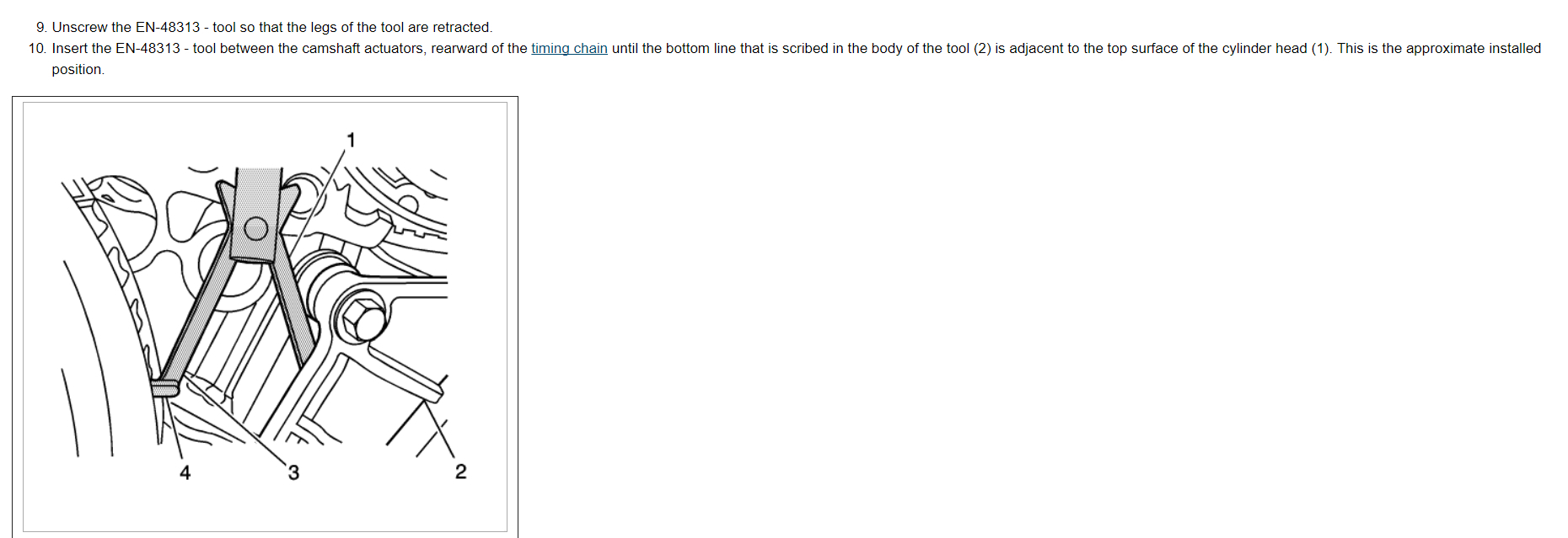

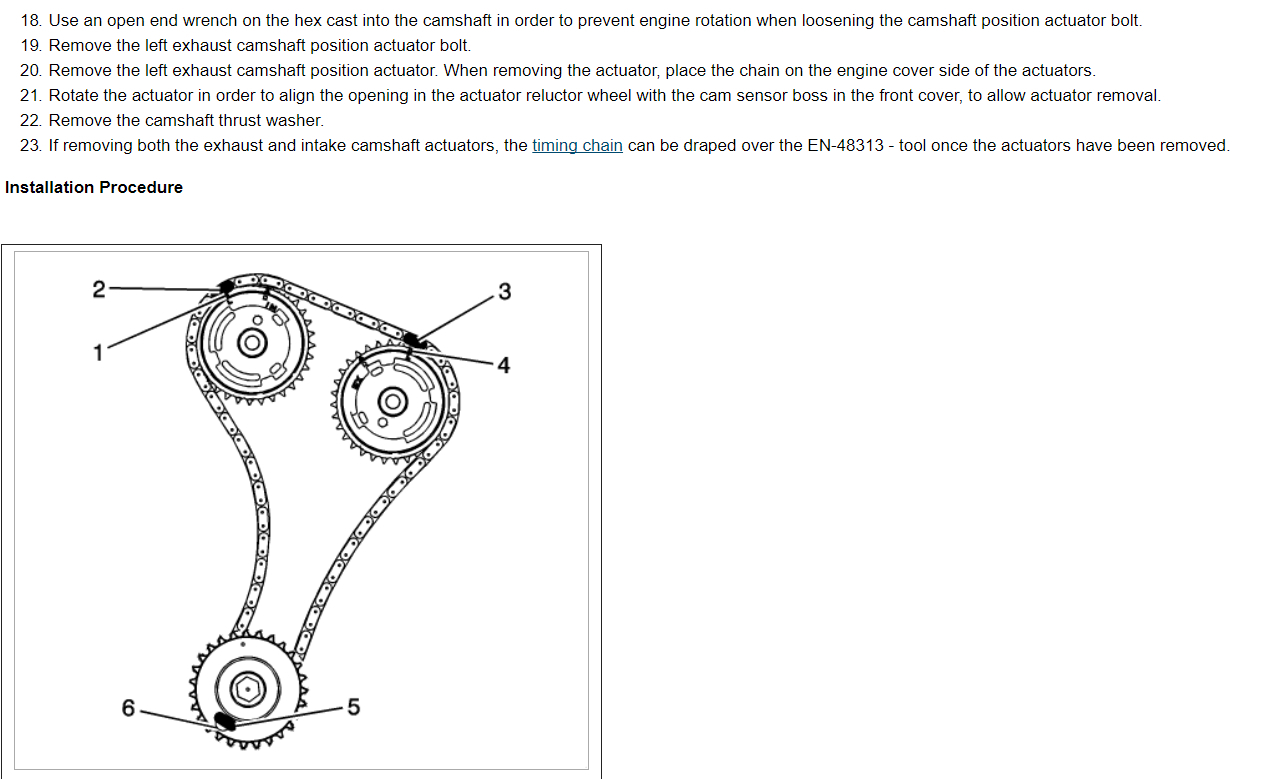

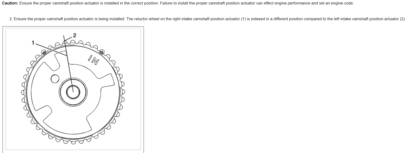

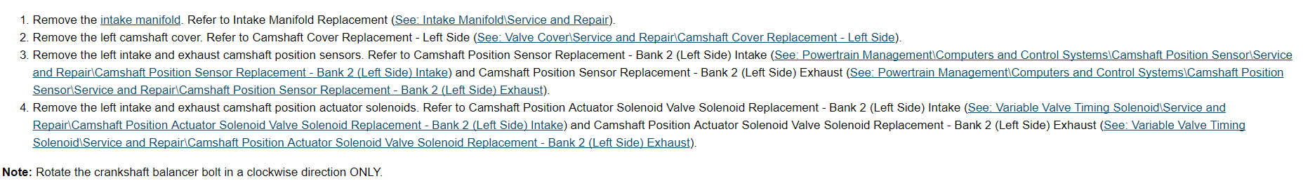

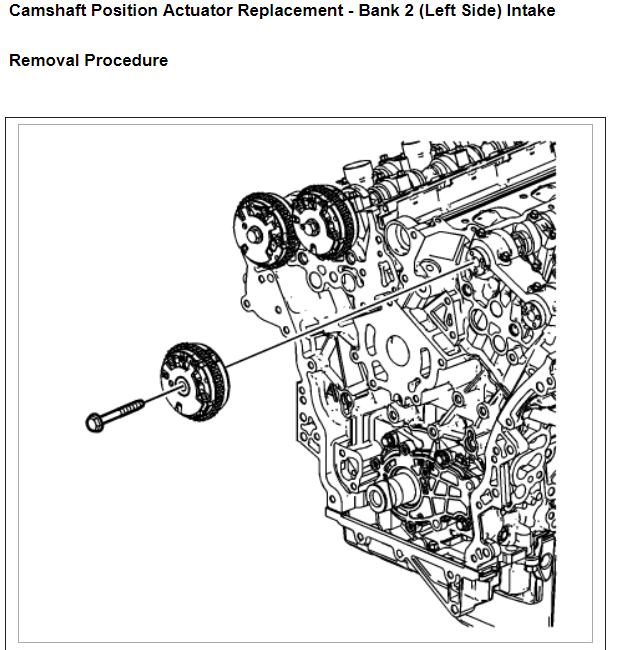

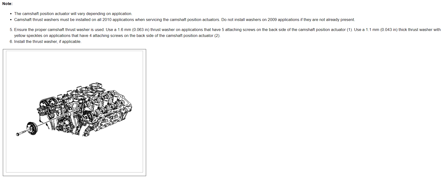

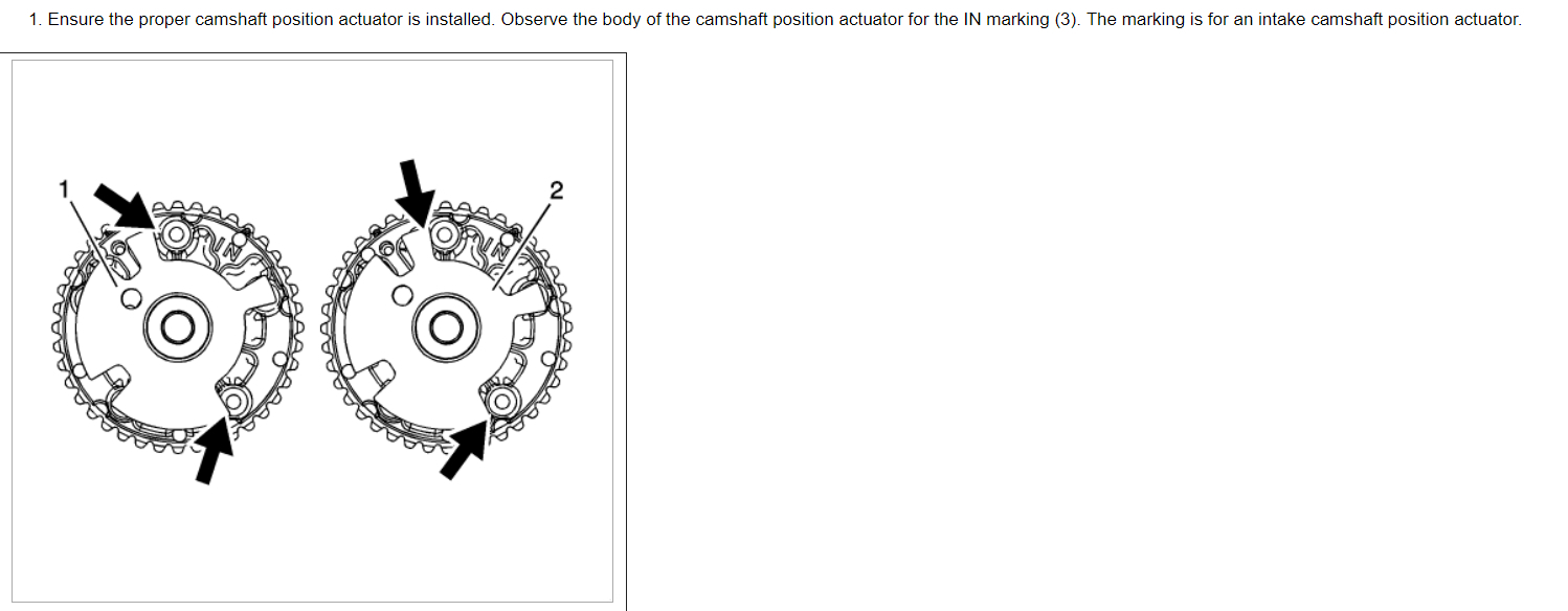

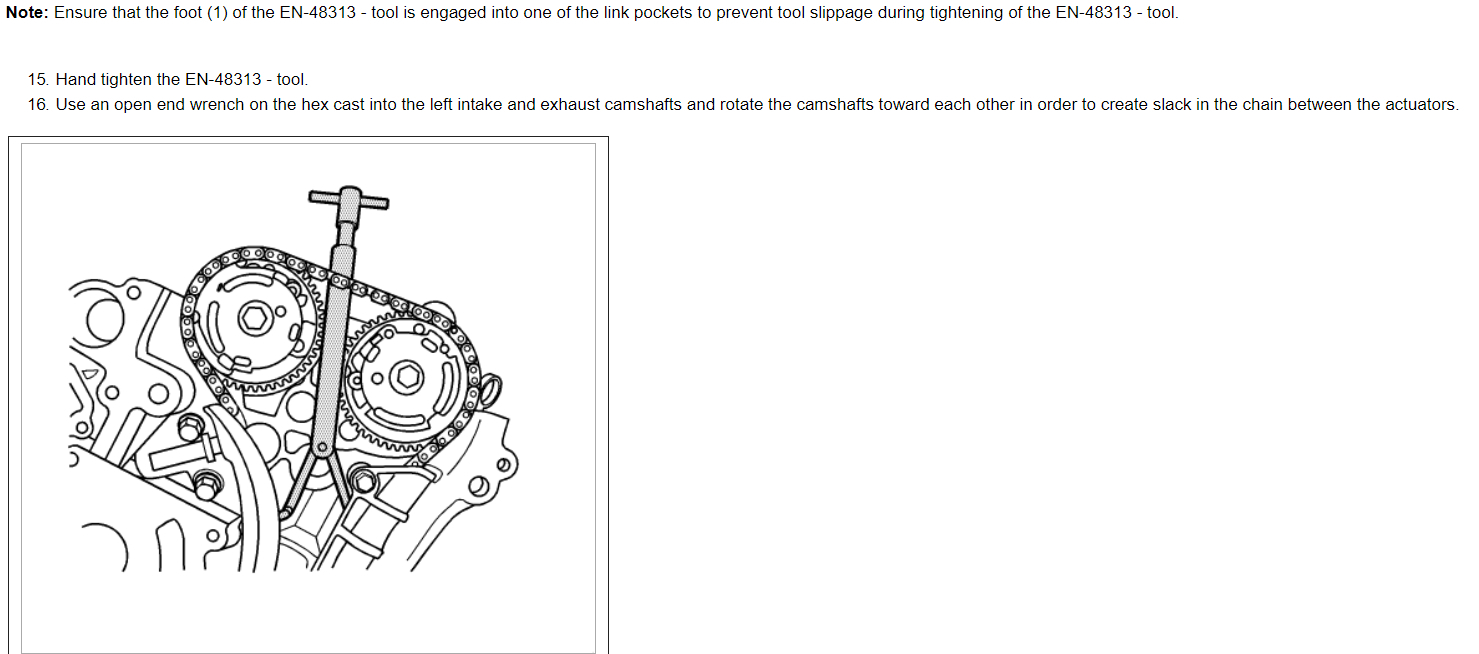

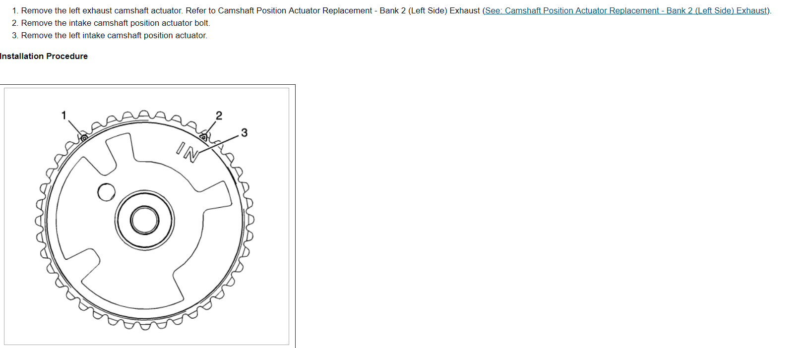

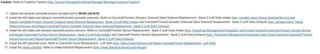

It sounds like you have a camshaft actuator/timing chain issue with the engine which is common. Below are diagrams on how to do the job.
You will need to pull the balancer here is a guide:

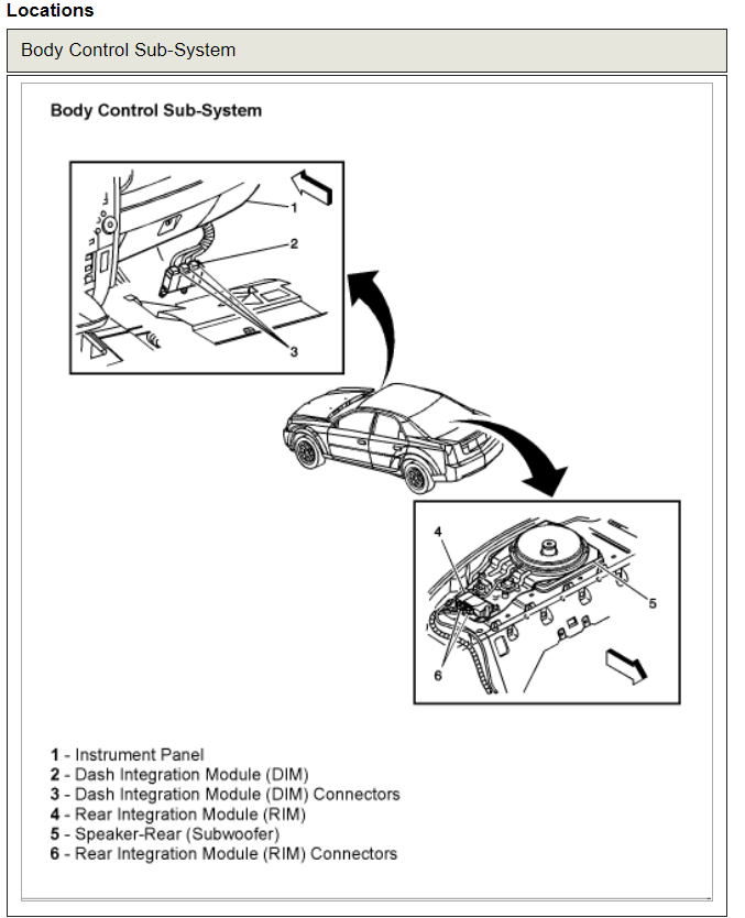

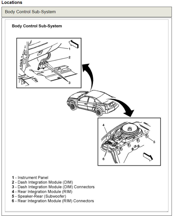

It sounds like a BCM issue which contains the security system. I would have the BCM codes run to confirm the issue. If you need it replaced a shop will need to program it for you. Below is the location.
Check out the diagrams (below).
