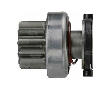

It sounds like the starter Bendix gear is either staying engaged or is touching the ring gear of the flex plate.
I would suggest removing the starter again and comparing the Bendix gear with the old starter. It might be longer than the original gear. See image below.
