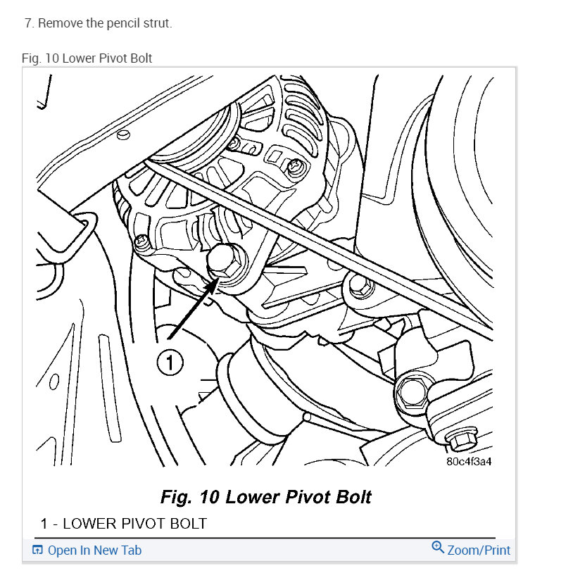

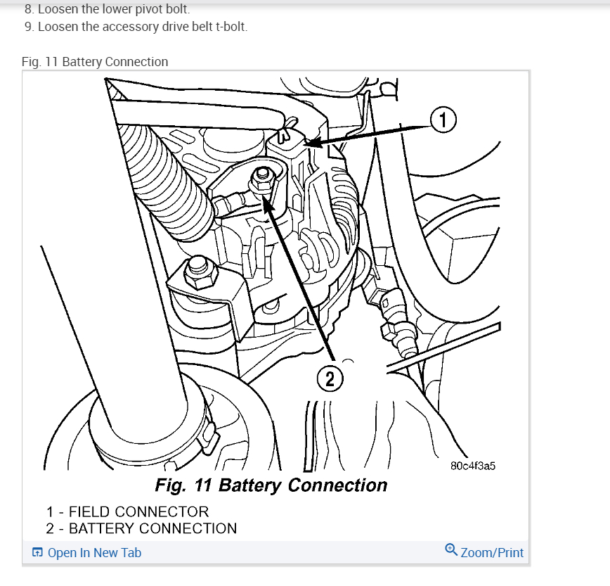

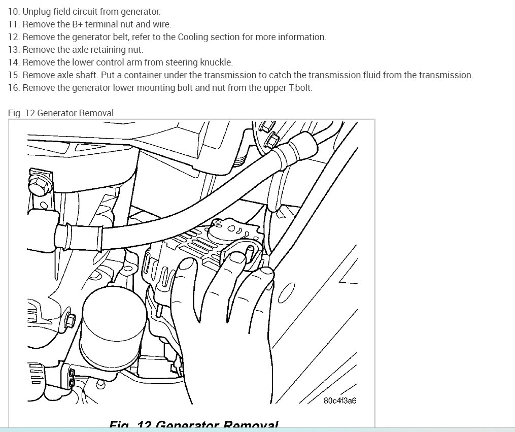

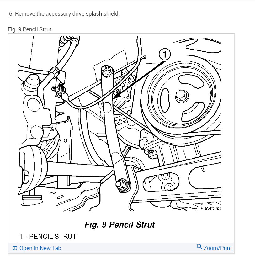

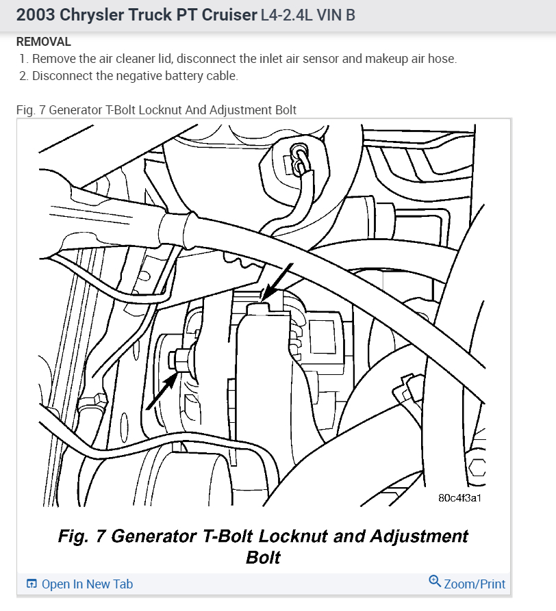

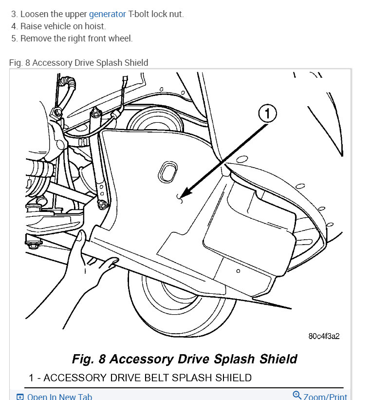

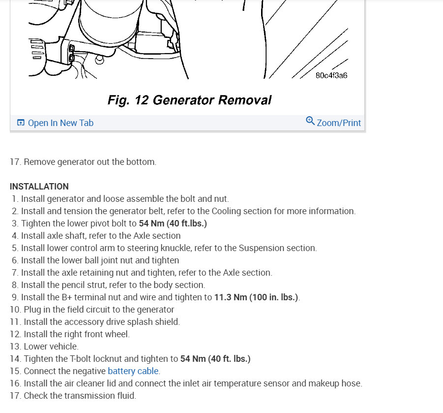

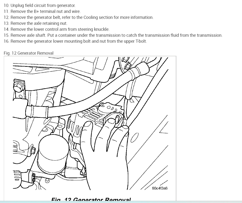

Here is how to change the unit out in the images below with a generic guide to help walk you through the steps:
https://www.2carpros.com/articles/how-to-replace-an-alternator
Disconnect the battery first. Check out the images (below). Please let us know if you need anything else to get the problem fixed.
