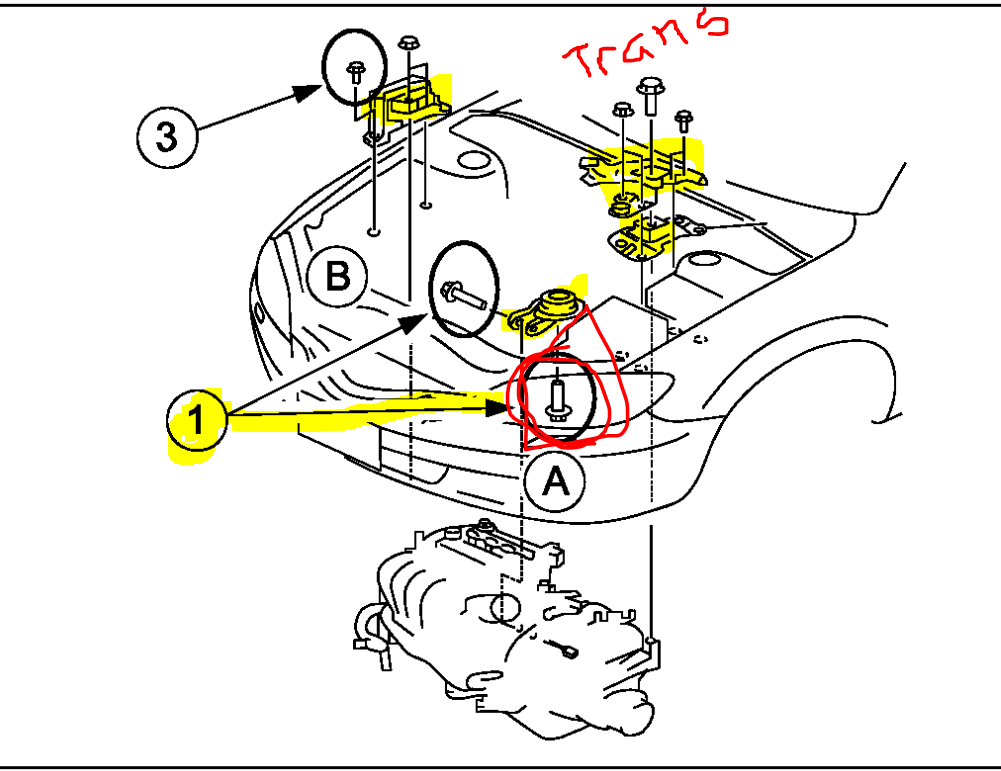

pic 1

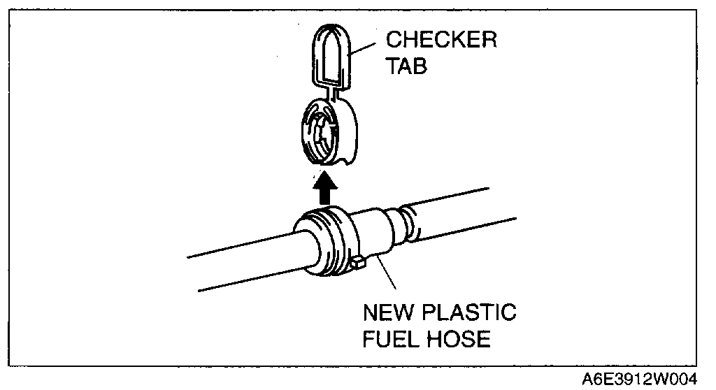

pic 2

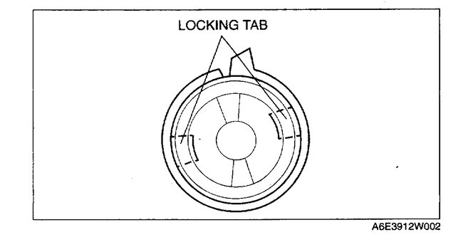

1. Push the tab on the locking coupler 90 degrees until it stops.
2. Pull the fuel hose straight back.
NOTE:
- The stopper may be removed from the quick connector. Take care not to loose it. Reinstall it to the quick release connector before reconnecting the fuel line.

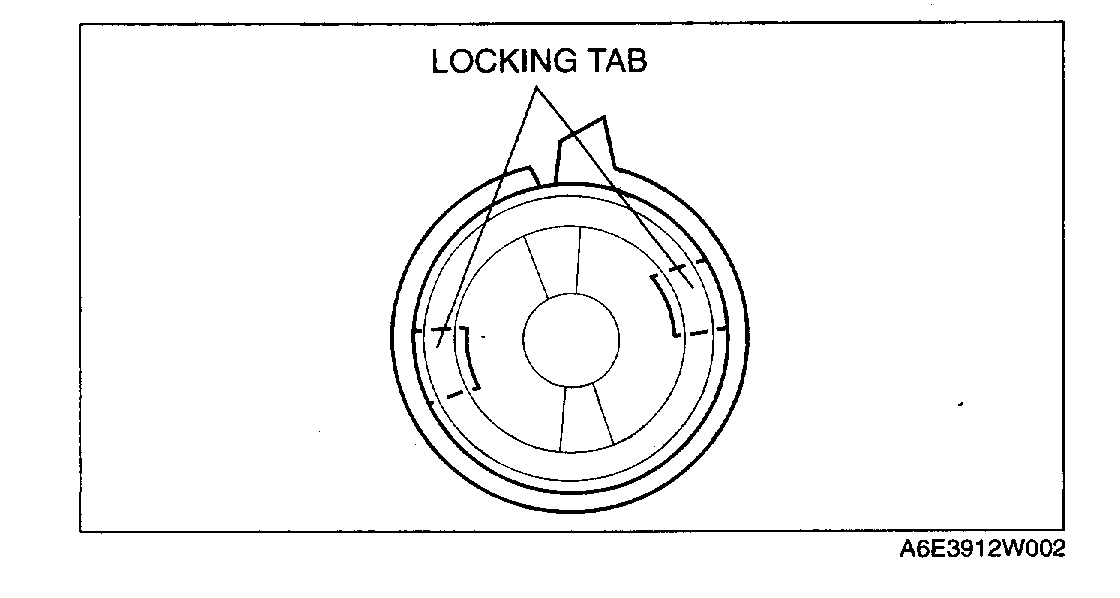

- The locking coupler has two internal locking tabs which distributor pipe. Be sure that the tab on the locking coupler is rotated until it stops to release two internal locking tabs.

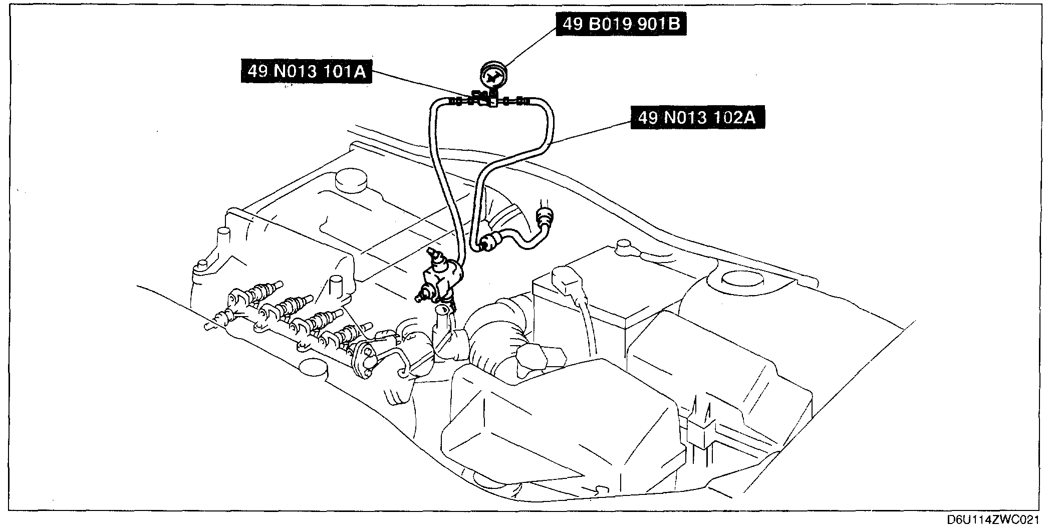

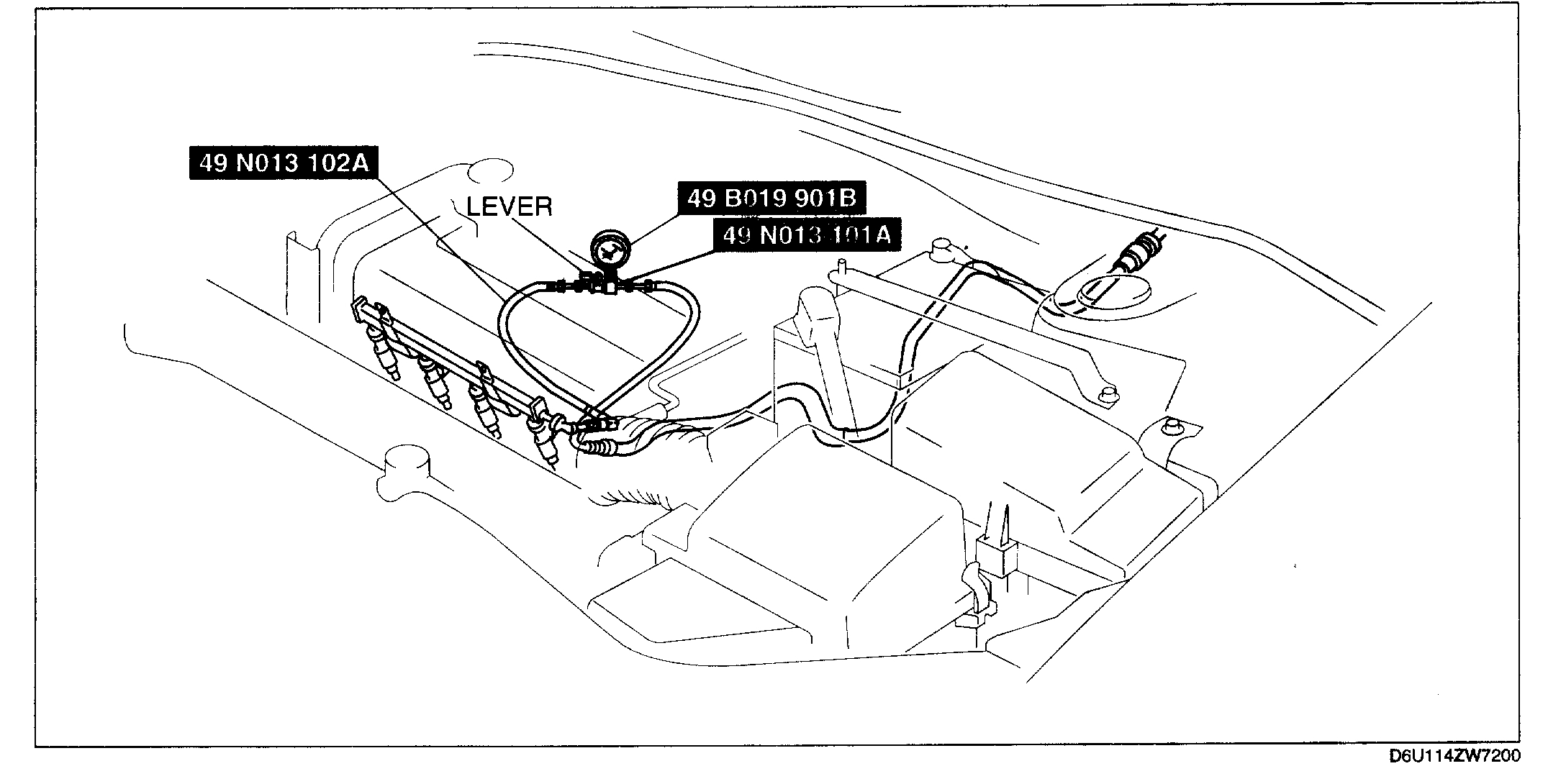

5. Push the SST quick release connector into the fuel pipe and plastic fuel hose into the SST until a click is heard.
pic 3
6. Turn the lever parallel to the hose of the SST as shown.

10. Start the engine and let it idle. Measure the fuel line pressure.

NOTE: A checker tab is integrated with quick release connector for new plastic fuel hoses. The checker tab will be released from the quick release connector after it is completely engaged with the fuel pipe.

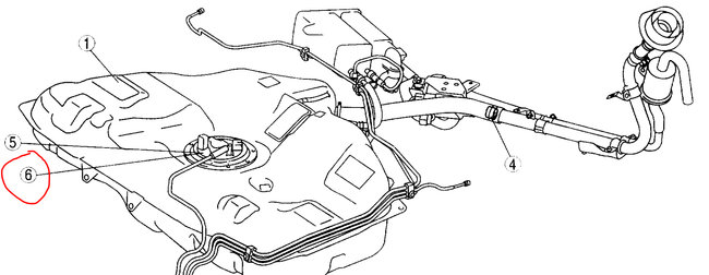

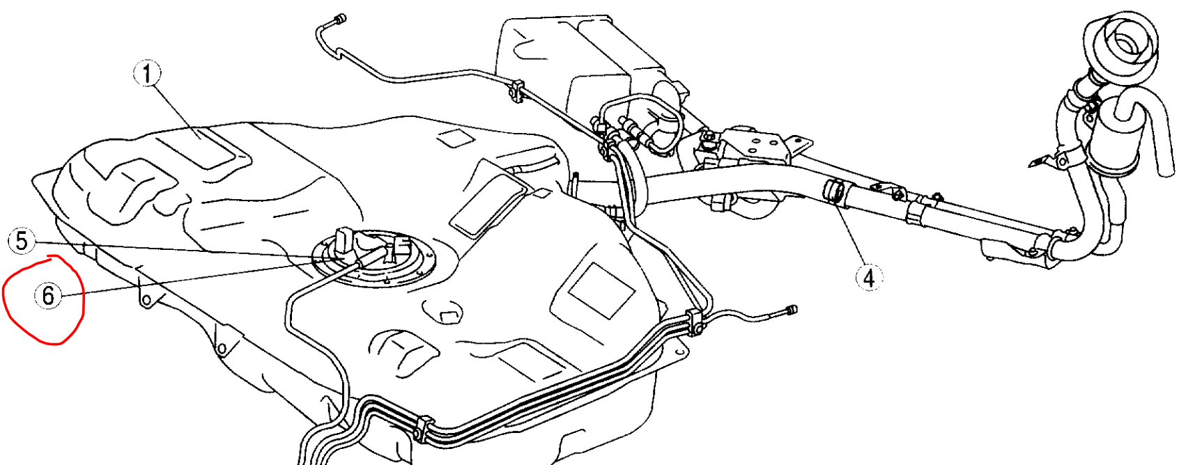

Do this and let me know what you find. I suspect the regulator is bad, but we need to perform the test to confirm. If you determine the regulator is the issue, and I hate to say this, but it is part of the fuel pump assembly at the tank. See pic 5.

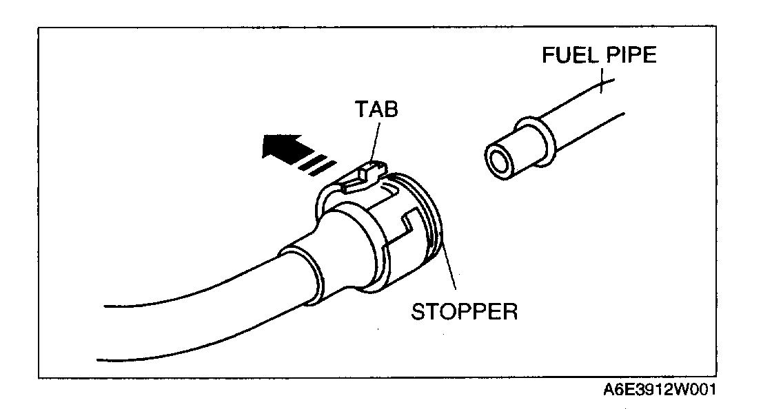

Pic 6
