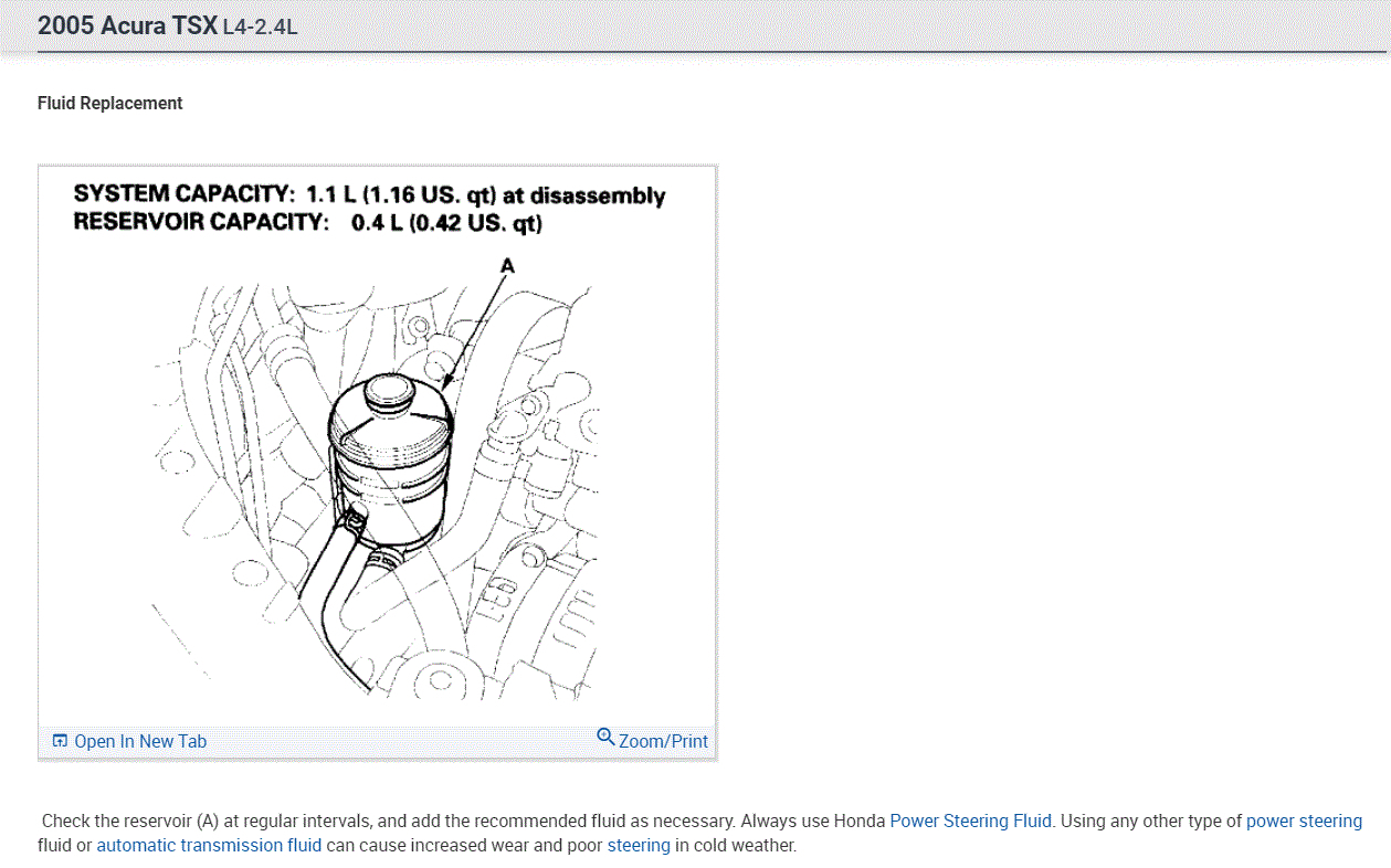

The original Acura part number for the power steering fluid is 17778-01025336 and is vehicle specific. Is that what you are using?

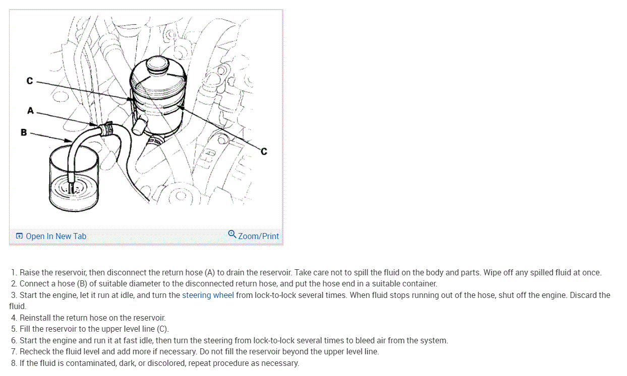

Also, have you tried flushing the PS system? I attached directions below for you. If you haven't, you may want to consider trying it.
