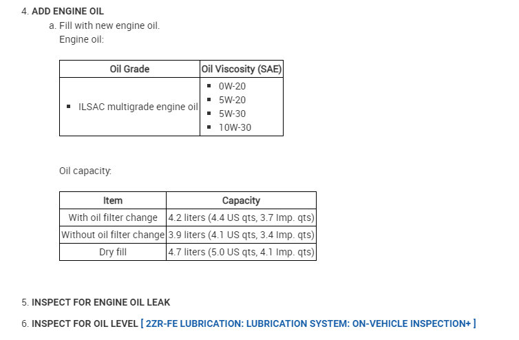

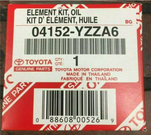

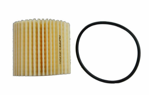

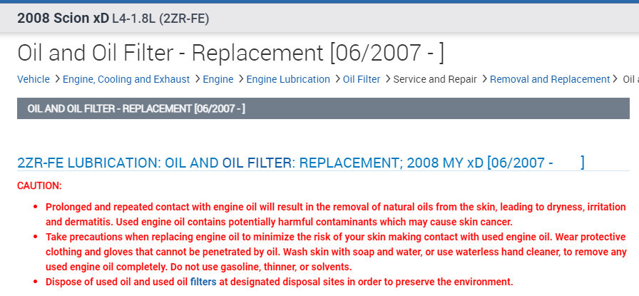

The oil filter on this vehicle is a cartridge filter. If you look at the first pic below, I attached a pic of what it will look like. Pic 2 shows the part number on the box. If you go to AutoZone, they will need to cross reference it to one of their brand filters.

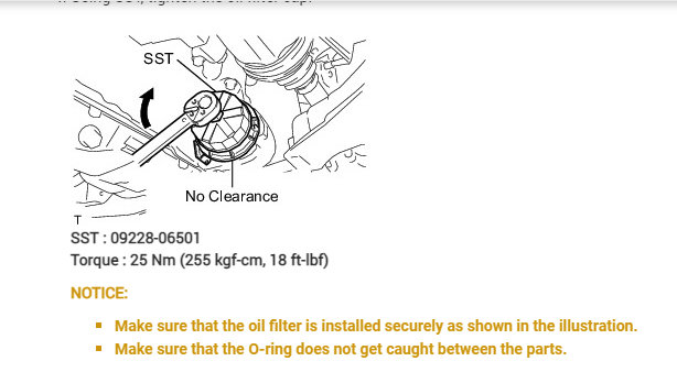

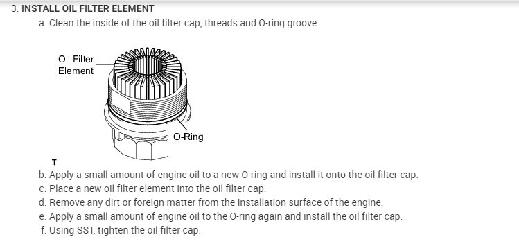

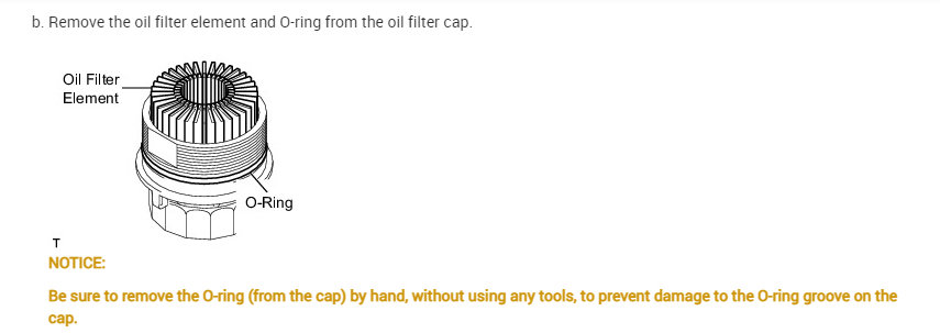

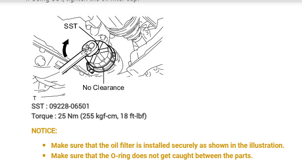

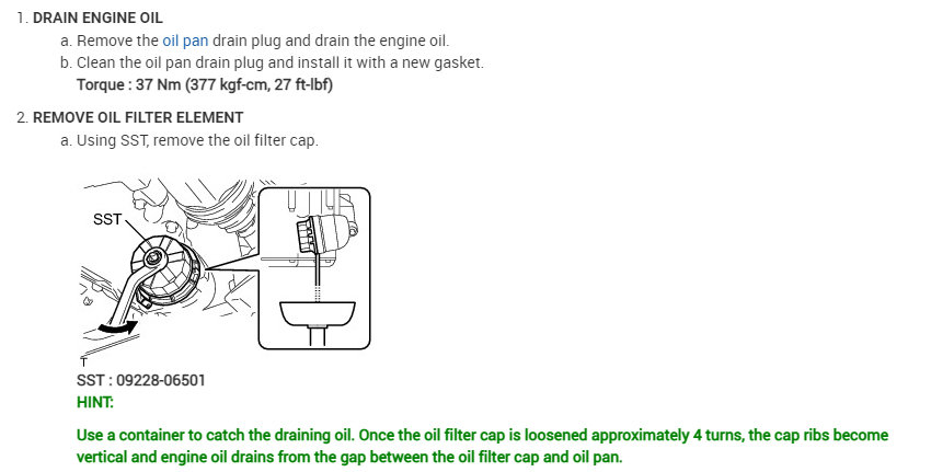

The remaining pics are the directions for the procedure. When you install the new O-ring on the oil filter cap, make sure to lubricate it with motor oil before installing it.
